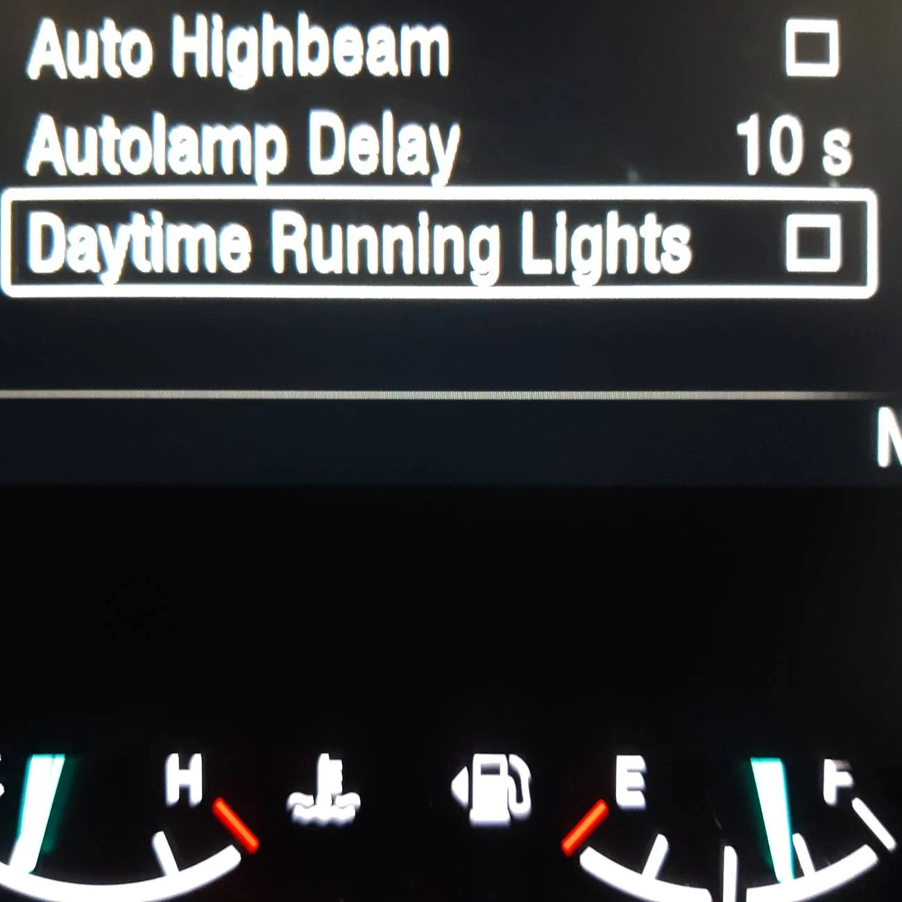

Instrument cluster settings we have in the XL and XLT is the option to turn daylight driving lights on or off. Those being the headlights. Those folks owning a Maverick Lariat, have dedicated daytime running lights. The dedicated DRL's that I have seen were nowhere near as bright as headlights. Tying to relate a Maverick to Lincoln might not be easy. Even though they are the same basic platform. Lincoln may have some proprietary software?
Ford Maverick [SOLVED!] Adjust auto headlight ON delay 20240909_140719
This is what I have for lighting options on my hybrid xlt.
