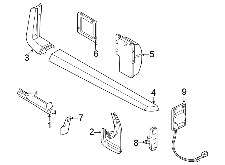

Ford 2022-2024 Maverick Truck Bed Rear 12V AC Plug Outlet Socket NZ6Z-19A464-A
  1. Ford Maverick Part number for the factory outlet and light that goes in bed? {filename}
  2. Ford Maverick Part number for the factory outlet and light that goes in bed? {filename}
  3. Ford Maverick Part number for the factory outlet and light that goes in bed? {filename}
  4. Ford Maverick Part number for the factory outlet and light that goes in bed? {filename}
  5. Ford Maverick Part number for the factory outlet and light that goes in bed? {filename}

EDIT: Updated part #'s and photo's to include the power button for the lamp.
This is the cover part # NZ6B-16F105-BC
https://parts.ford.com/shop/en/us/b...d-parts-general/cover-14199565-1#/partMatched
This is the charger/outlet part # NZ6T-19J289-AB
https://parts.ford.com/shop/en/us/e...parts/battery-charger-14490681-1#/partMatched
This is the lamp part # JL34-13D719-AA
https://parts.ford.com/shop/en/us/e...sy-luggage-compartment-6606989-1#/partMatched
This is the power button for the lamp part # NZ6T-14K147-AA
https://parts.ford.com/shop/en/us/electrical/switches/steering-wheel-switch-14200249-1#/partMatched
So once it get back above freezing (which may be in March at this point) I am going to tackle adding this. I bought all of the parts above, and the harness from salvage. The only thing I dont have is the fastners for the outlet to the panel and the panel to the bed. I hate the way Ford shows fasteners in the illustrated diagrams, at the bottom as an after thought. Does anyone have these part numbers, or a photo of them up close so I can try and match them up in the diagram/images?
