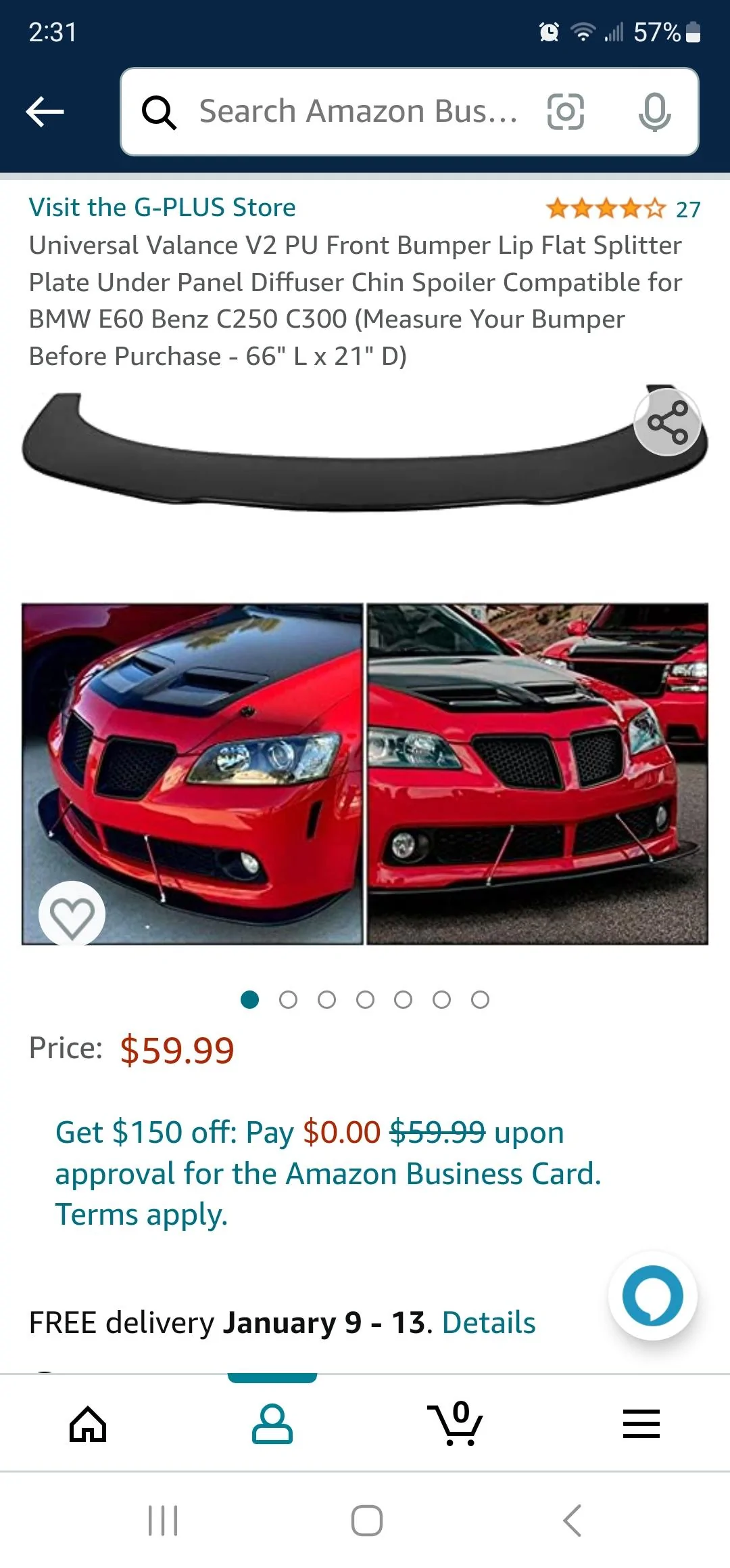

Awesome, good luck with the install. I assume you're using the EZ Lip option...
No secrets, this is what I ordered. Not sure how much I'll like it but worth a shot.

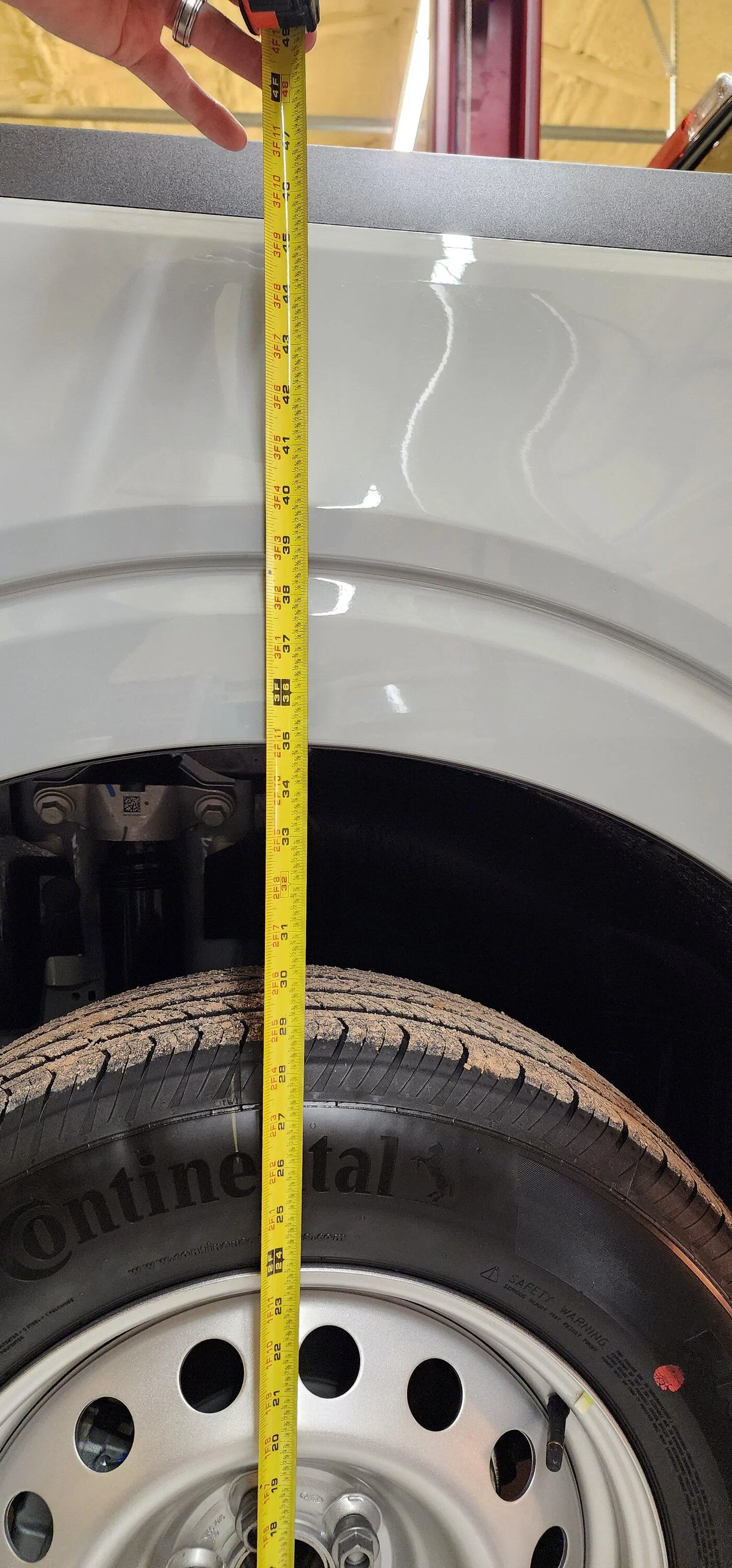

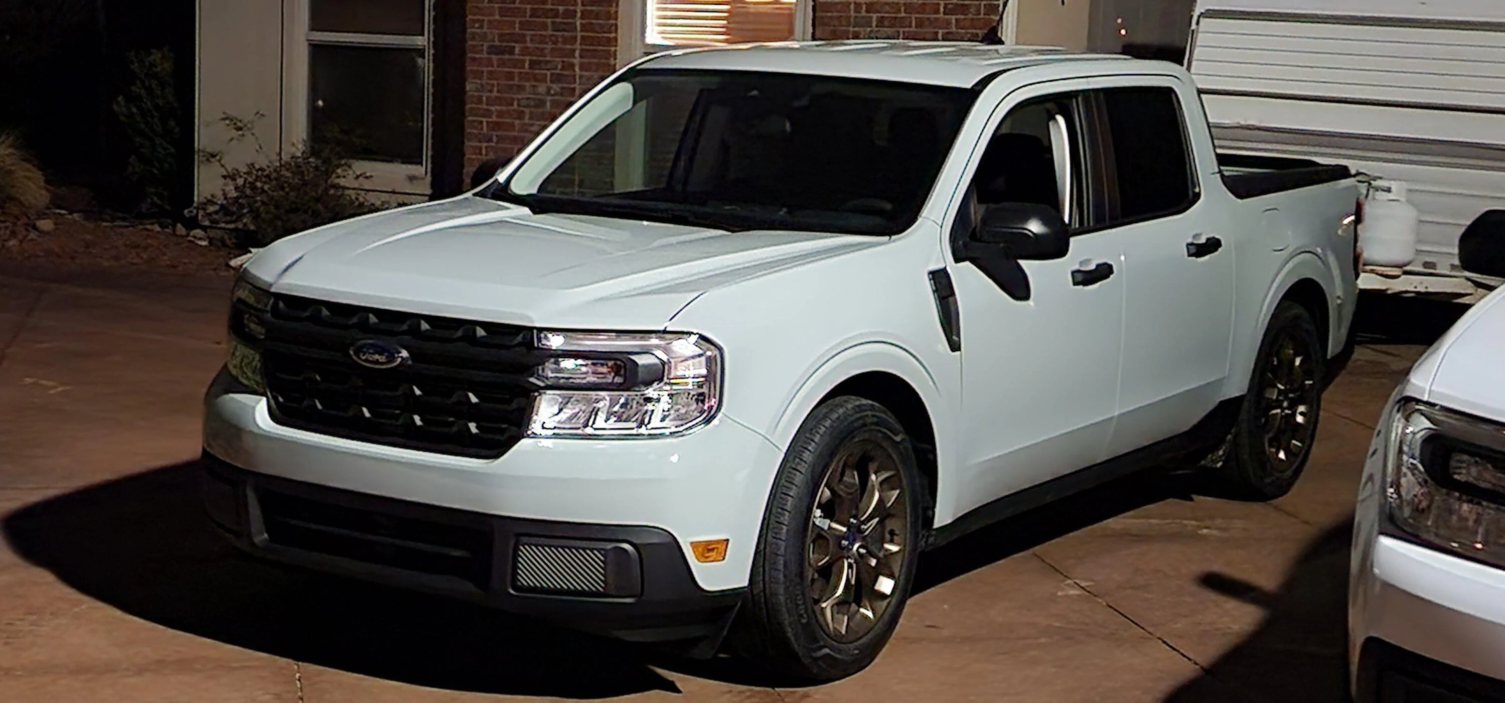

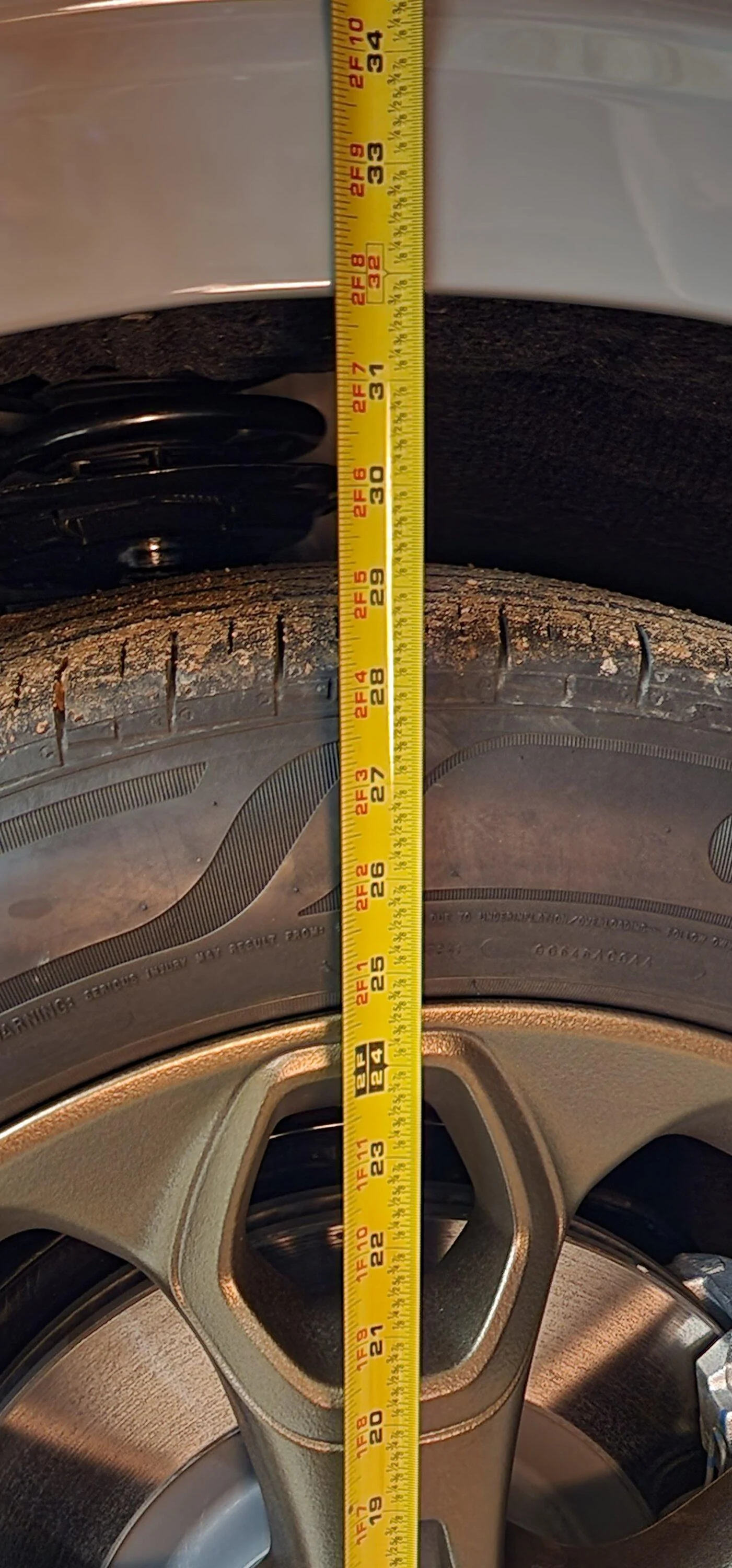

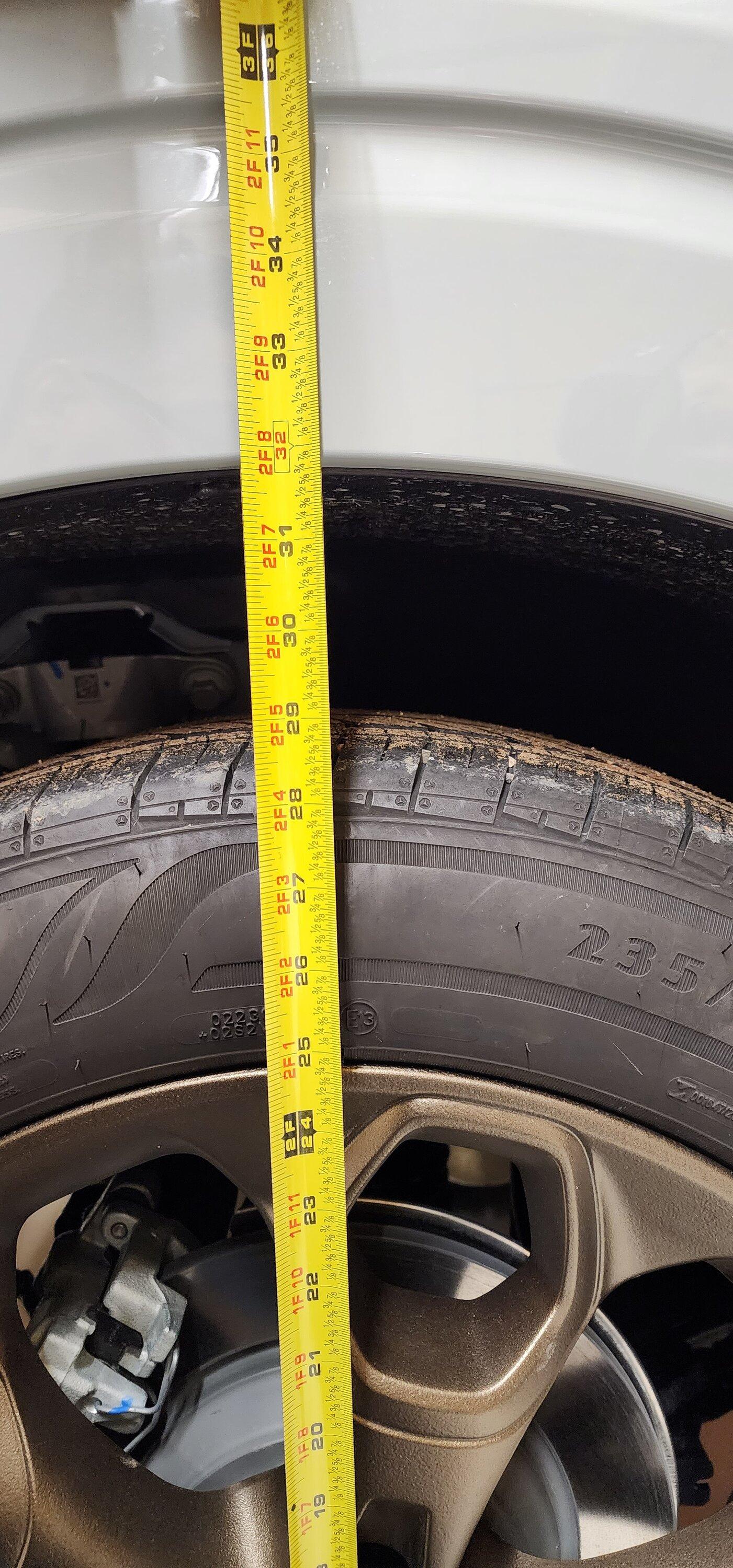

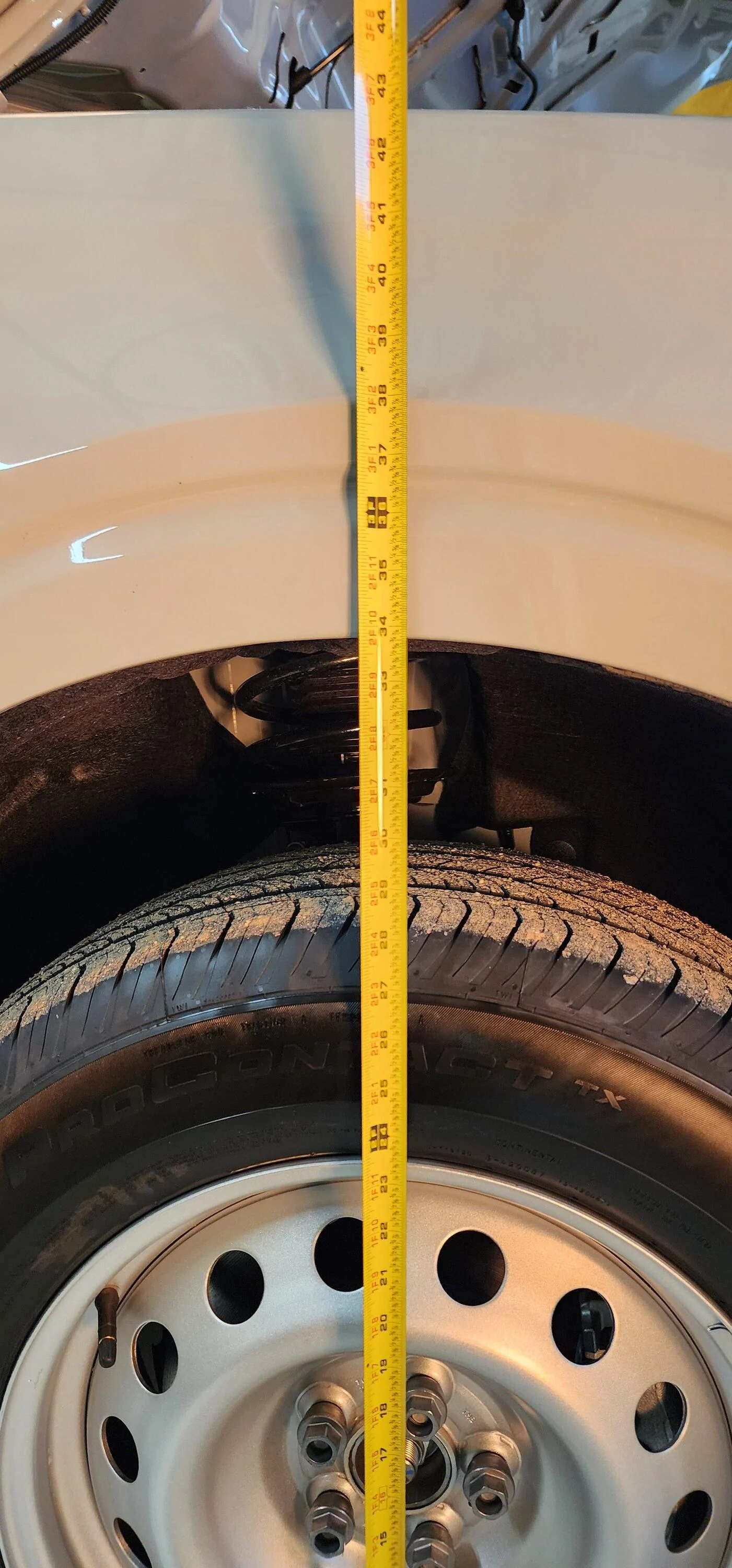

Well, the springs are in and so is the verdict.
Stock front fender measured 33 3/4".
Stock rear fender measured 34 15/16".
Lowered front fender measures 31 13/16".
Lowered rear fender measures 31 3/4".
So roughly 2" front (Eibach claims 2.5") and 3 3/8" rear (Eibach claims 3.5").
(EDIT: See post 86 in this thread for measurements after 2900 miles. It has settled nicely.)
I ran it around the block before I took the measurements so the suspension is pretty well set. I doubt it will settle.
So what say y'all? I think I'm the first lowered '23.

Looks GREAT. Once you have driven it more be sure to let us know how the ride is?
