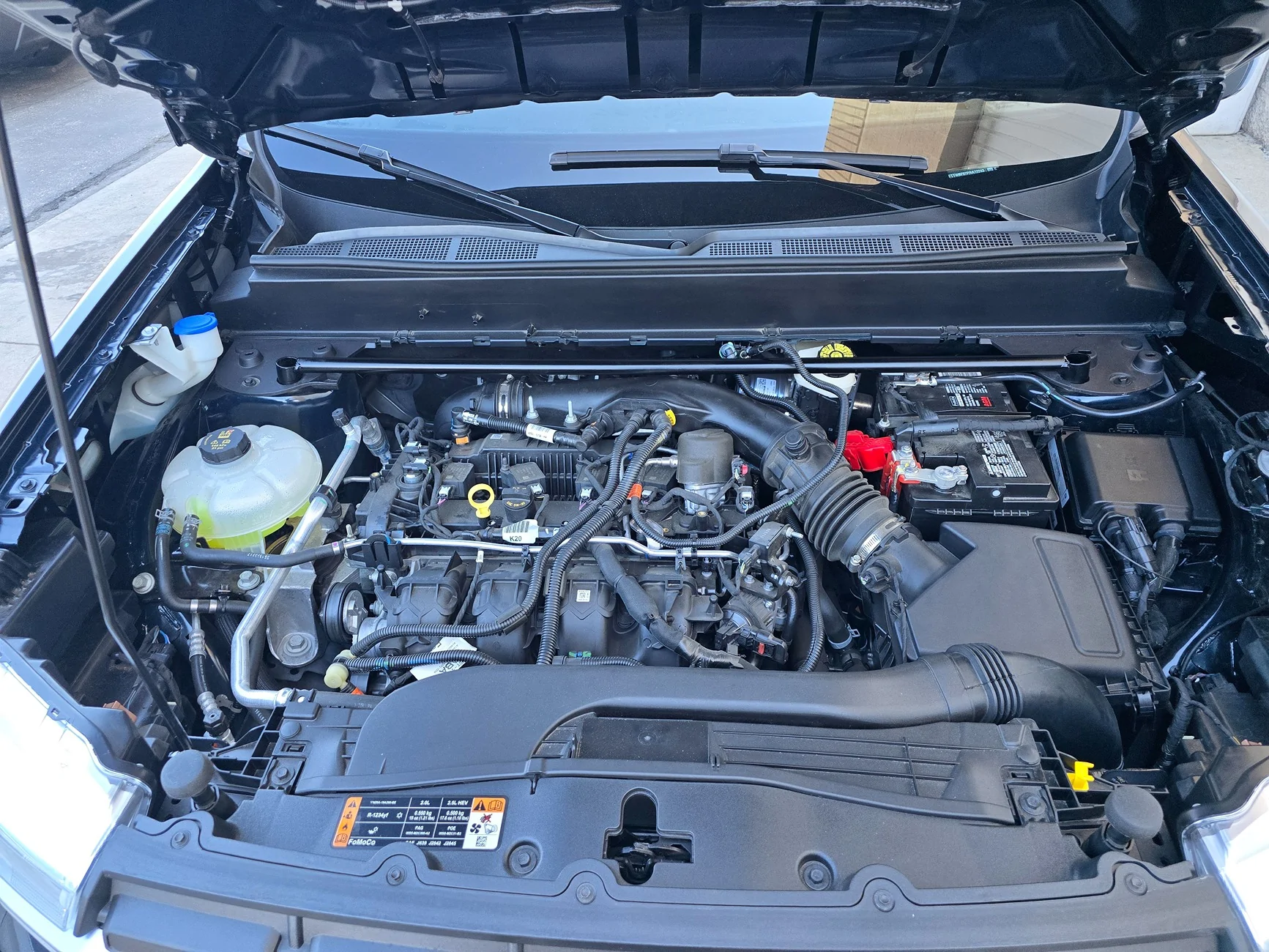

My experience with a strut tower bar on one vehicle (08 Pontiac Solstice GXP) is that it did sharpen up the initial turn in. When I first turned the steering wheel, the response was minuscule(?) sharper. Once the vehicle settled into the turn I noticed no additional benefit. Will I do it to the Mav? Probably, after a few other things first though.

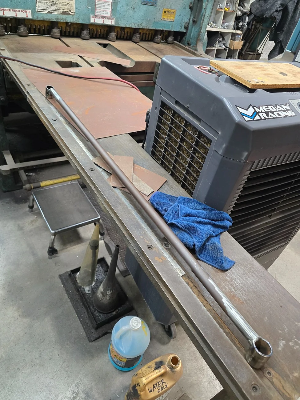

i built my own from scrap i had at work when i was bored. dunno if i feel any difference or not. just something ive done to most of my cars ive owned. yes i put the cover back over the red battery terminal and yes theres room above the negative terminal. may not be powder coated but free fiddy is better than $150+
Thats the best one I've seen yet. For real.
Just black.
No branding.
Done.
Doesn't grab too much attention. Could even go matte black on the finish, and it would blend into the bay even better.
How much did your lap times at willow springs go down after installing this?
