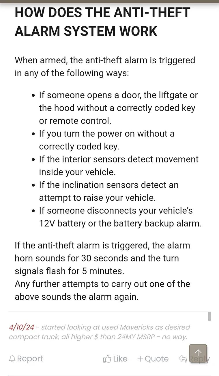

ARMING THE ANTI-THEFT ALARM SYSTEM
The alarm is ready to arm when you switch your vehicle off.
Lock your vehicle with your remote control to arm the alarm.
HOW DOES THE ANTI-THEFT ALARM SYSTEM WORK
When armed, the anti-theft alarm is triggered in any of the following ways:
  • If someone opens a door, the liftgate or the hood without a correctly coded key or remote control.
  • If you turn the power on without a correctly coded key.
  • If the interior sensors detect movement inside your vehicle.
  • If the inclination sensors detect an attempt to raise your vehicle.
  • If someone disconnects your vehicle's 12V battery or the battery backup alarm.
If the anti-theft alarm is triggered, the alarm horn sounds for 30 seconds and the turn signals flash for 5 minutes.
Any further attempts to carry out one of the above sounds the alarm again.

From the chart below there are a few things that you can try
1. Roll down any window. Standing outside your truck. Lock your truck with your key fob. Place it a good distance away. Reaching through the open window and open the door. Your horn should start to honk.
2. If you have anyone who can assist you. Get inside your truck have your assistant lock it with the key fob.
Then move around inside the truck and see if anything happens.
Because of the seatbelt sensor. Nothing may happen because the truck knows that somebody is being locked in the truck.
3. Unless you have a tow truck handy you probably will not be able to check the inclination alarm.
