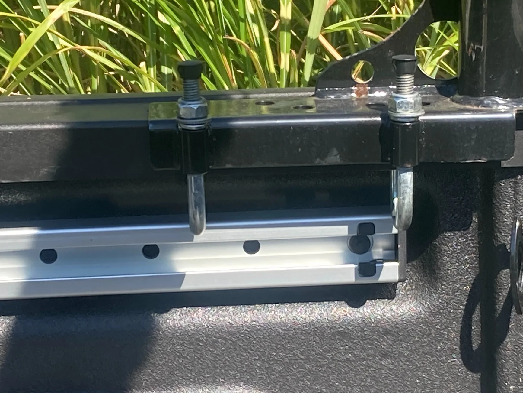

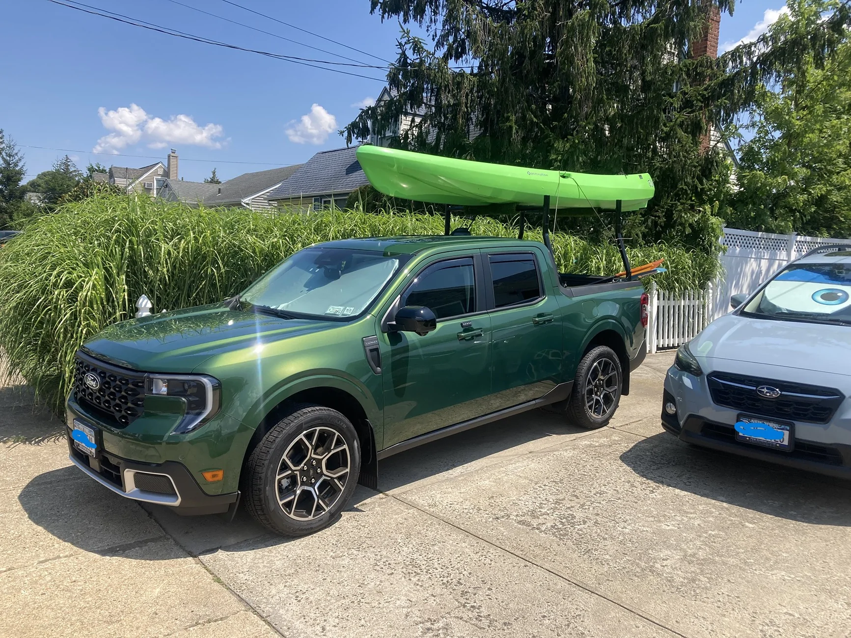

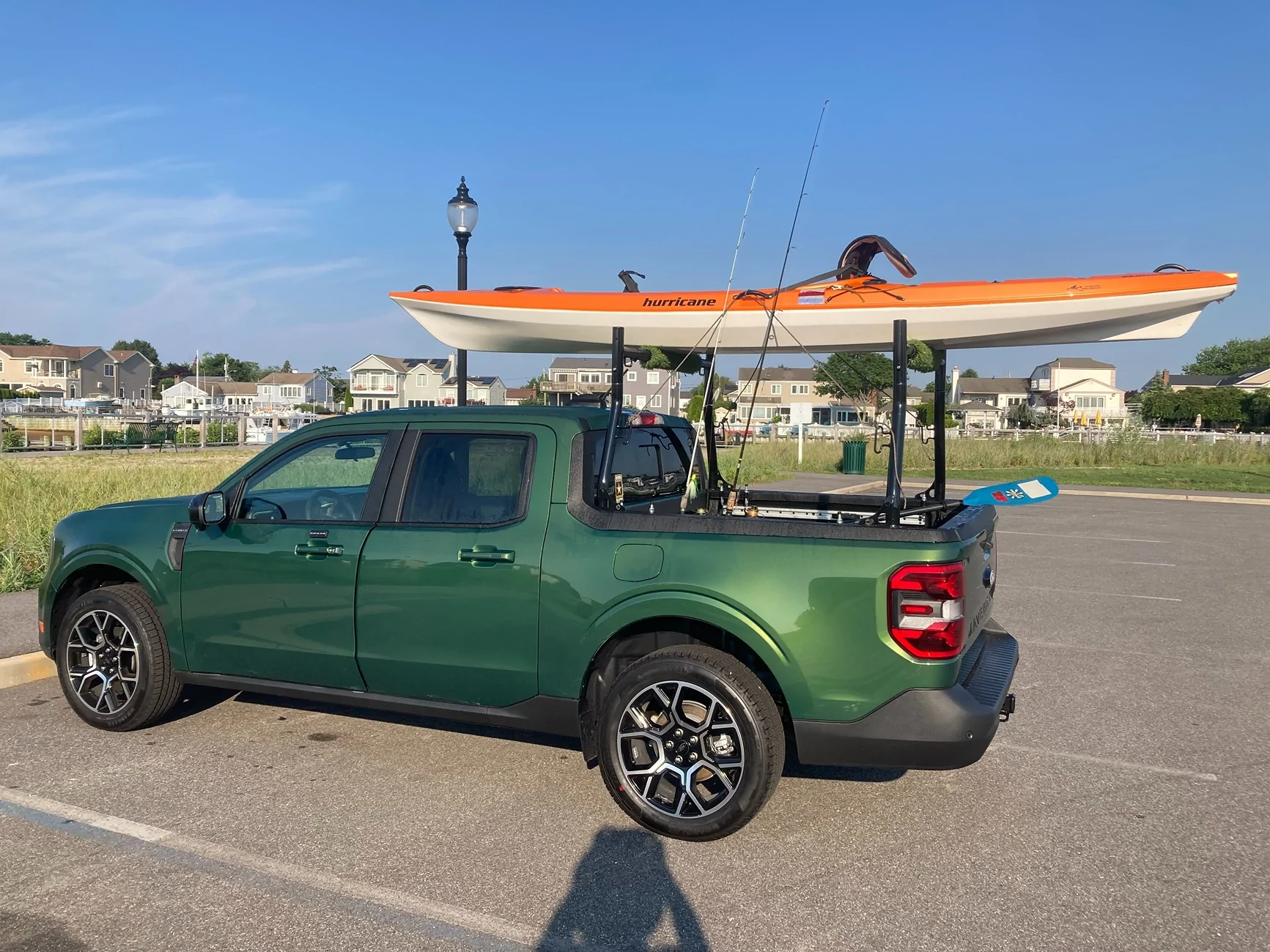

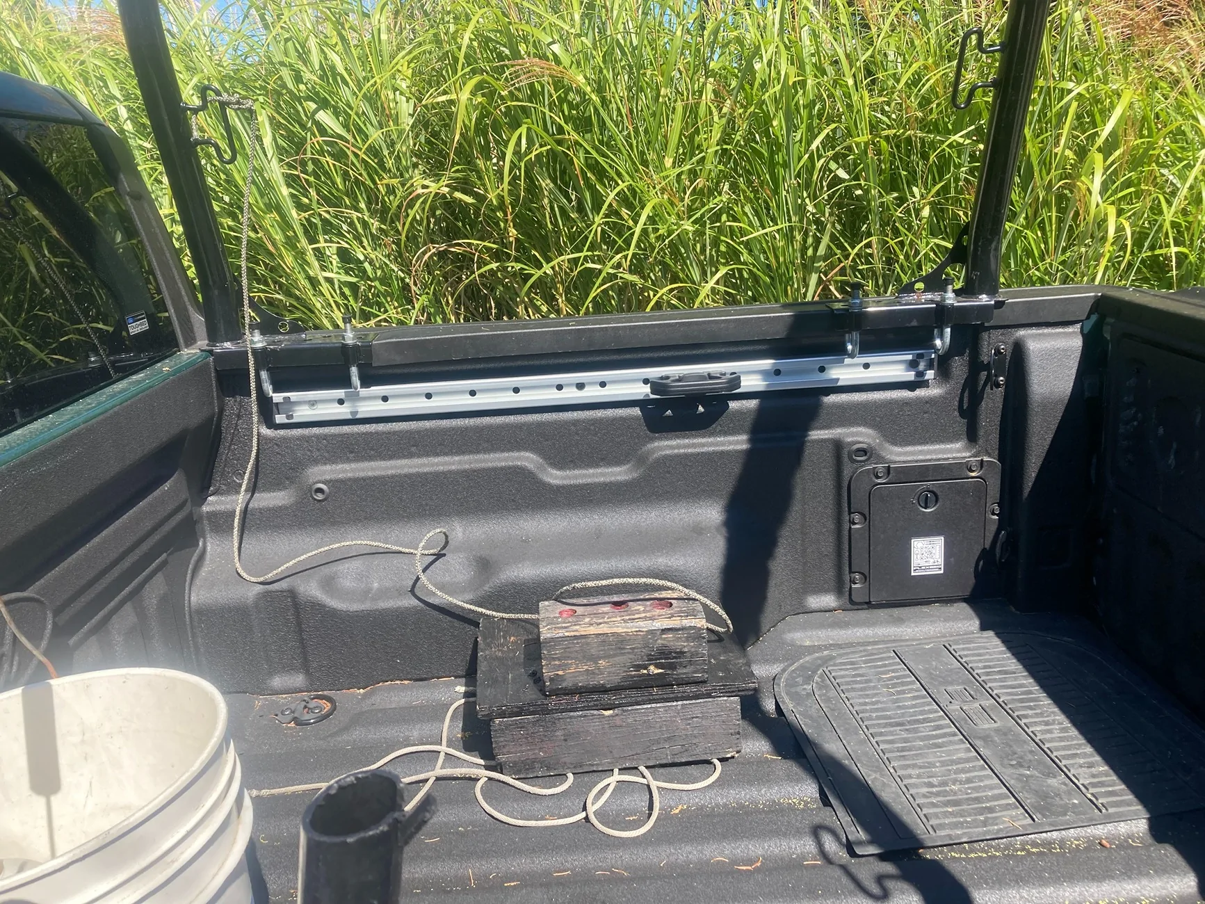

My JY performance rack from Amazon ($110.) came with two J bolts for each lower section and they hook into a rectangular metal bar under the plastic rail of the truck. No side bars but they would be in the way for me anyway. I had to use a deep 3/4" socket to tighten them down but even without sidebars it is sturdy, although I haven't put anything heavier on it than our 66lb tandem yak, and usually only my 49lb Hurricane Skimmer. Last week I cut 4'' off of each of the four female tubes on the top pieces. Photo is a before pic, when I found them too high. I considered drilling holes for set screws but don't think I will need them.

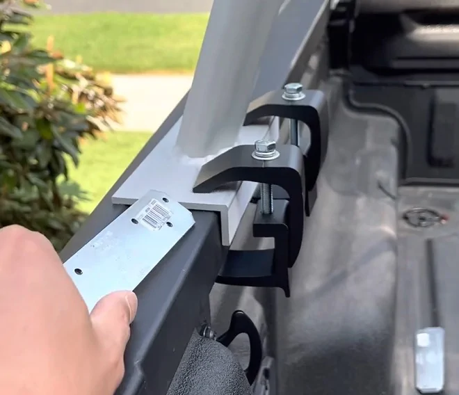

These clamps? I agree with this user, shimming under the brackets to provide a more level surface would be a good idea.

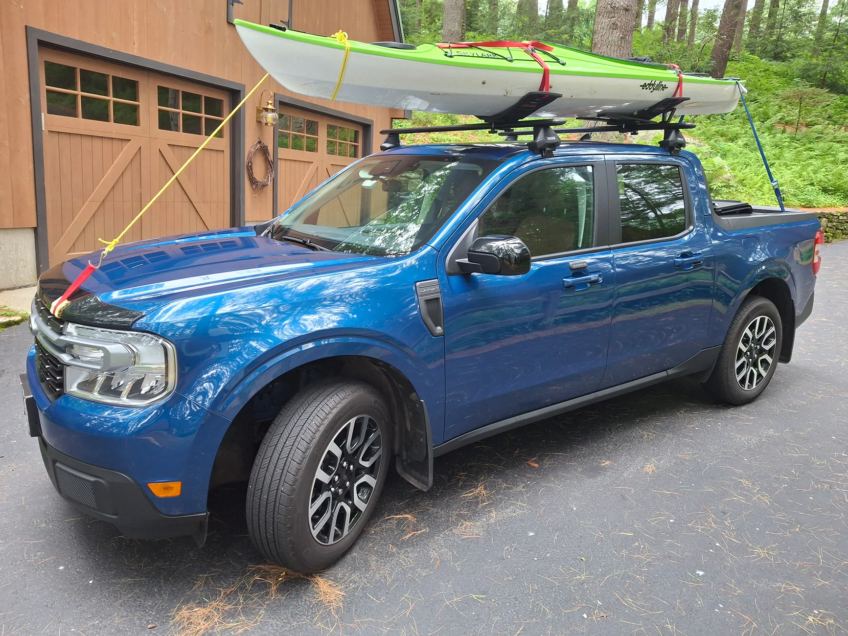

thought about a rack like that, but went with the roof rack for my kayak and am happy with that
