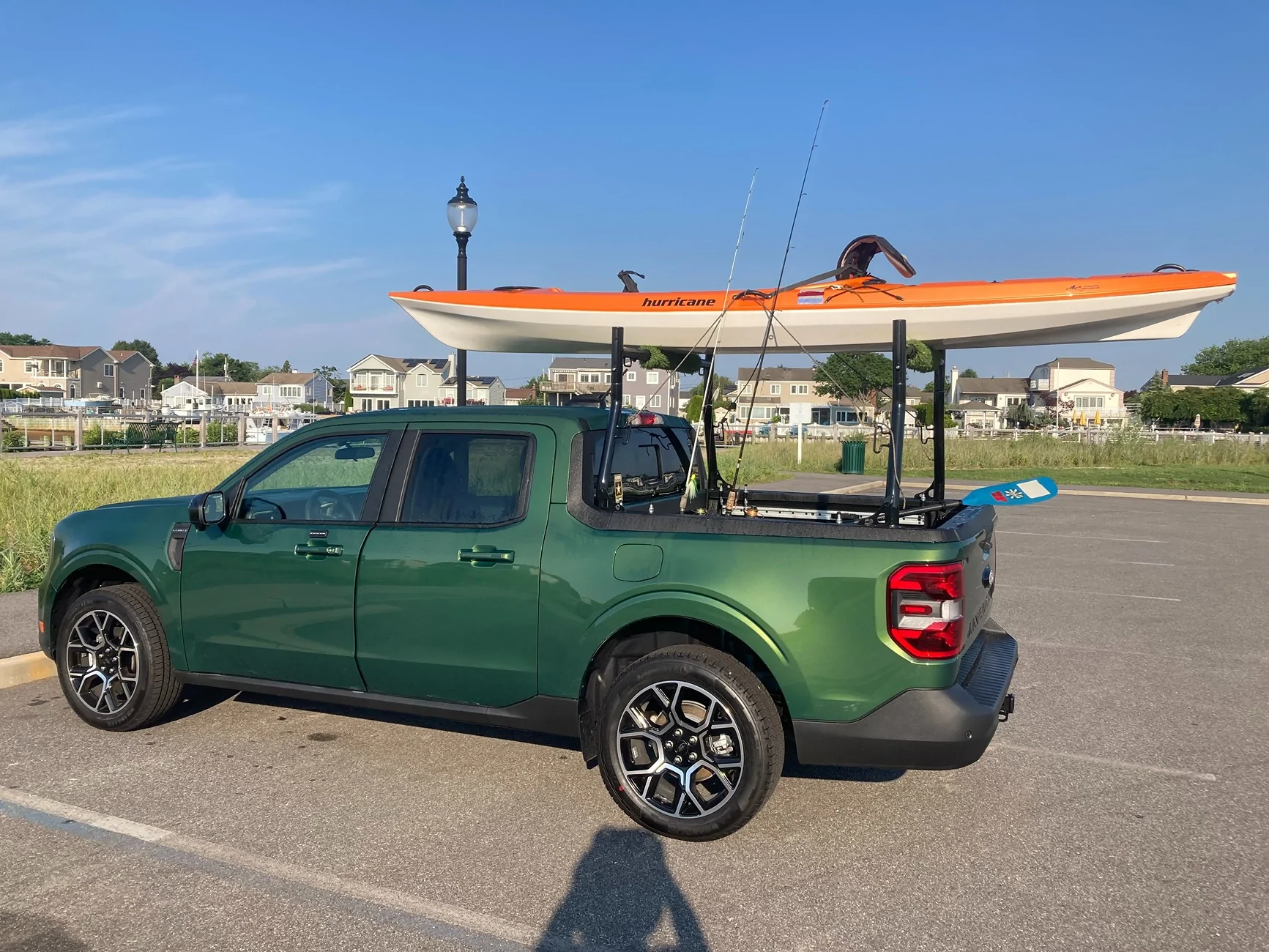

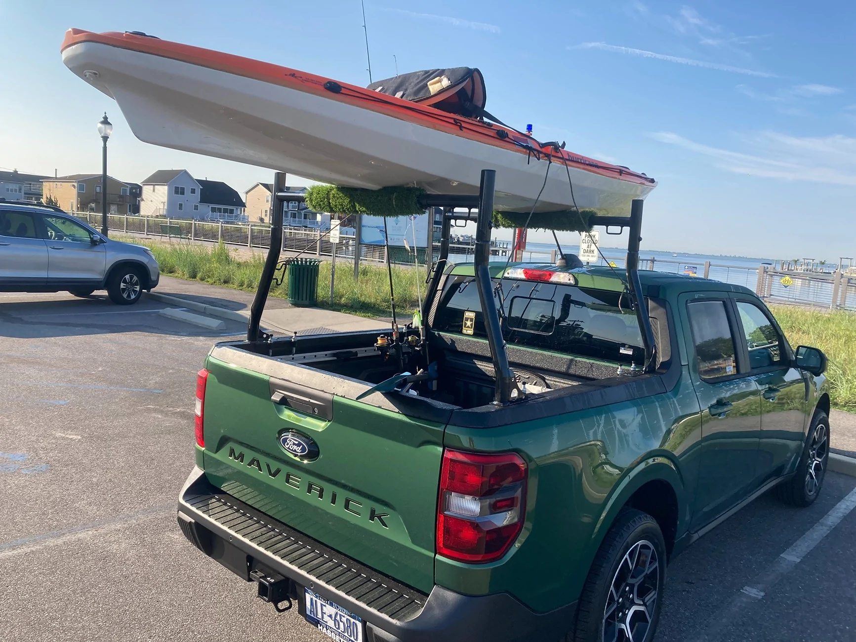

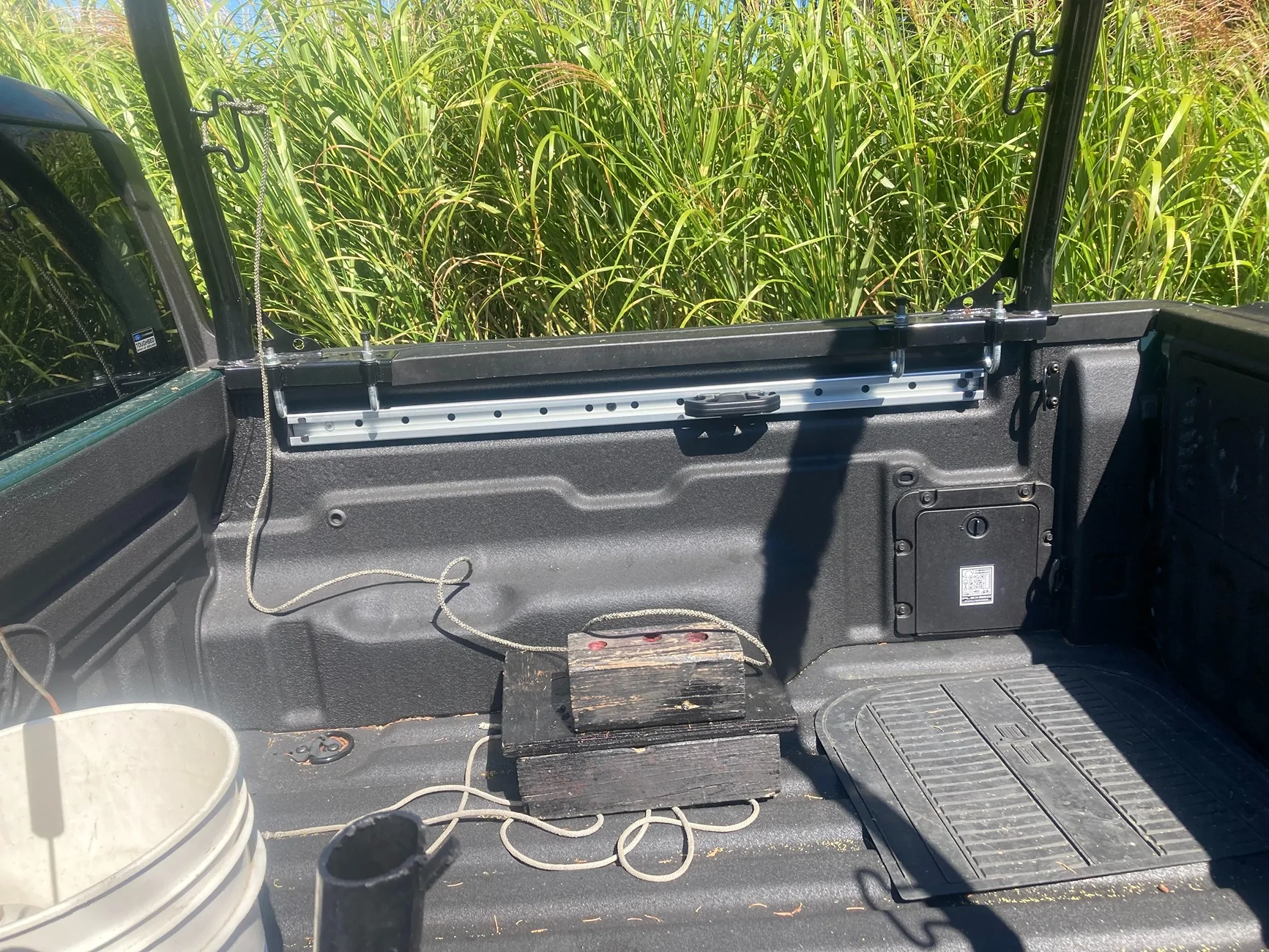

I had a TrakRak on my 2010 Ranger for 15 years. They got bought out by another company and yes, the price is now a grand. This June when I took delivery of my Lariat I installed a hundred dollar Amazon bolt-on that did not interfere with the utility rails the truck came with but still allowed me to put the cross pieces four feet apart (or closer if desired.) Now that kayak season is all but over for me, I will take it off until May.
JY PERFORMANCE Truck Ladder Racks 800Ibs Capacity Extendable Pick-up Truck Bed Ladder Rack, Universal Heavy Duty (J-Bolt Clamps)
