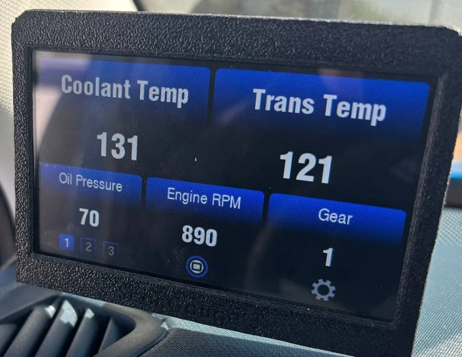

@OR3X or anyone else, 2024 2.0 EB, when I select gear it has a value of 70. Is there a different "gear" to select, or is the 70 adjustable?
Trying to get to this;
Ford Maverick ScanGauge 3, gear readout Screenshot 2026-04-11 112852
Thanks, HRG

Here's what I did for mine ('23) but its the same for'24 to get gears 1-8. Hope this helps.
ScanGauge III: Use the Auto Scan feature for a faster setup. Go to More > X-Gauge > Auto Scan, select "Ford," and look for "Gear" in the list of detected gauges to save it directly.

Edit to add...70 is park, 60 is reverse and 50 is neutral. When you go in drive 1-8 will display.

Correct, I see the same 70 for park, 60 for reverse, etc. but when in drive I see the actual gear numbers.
