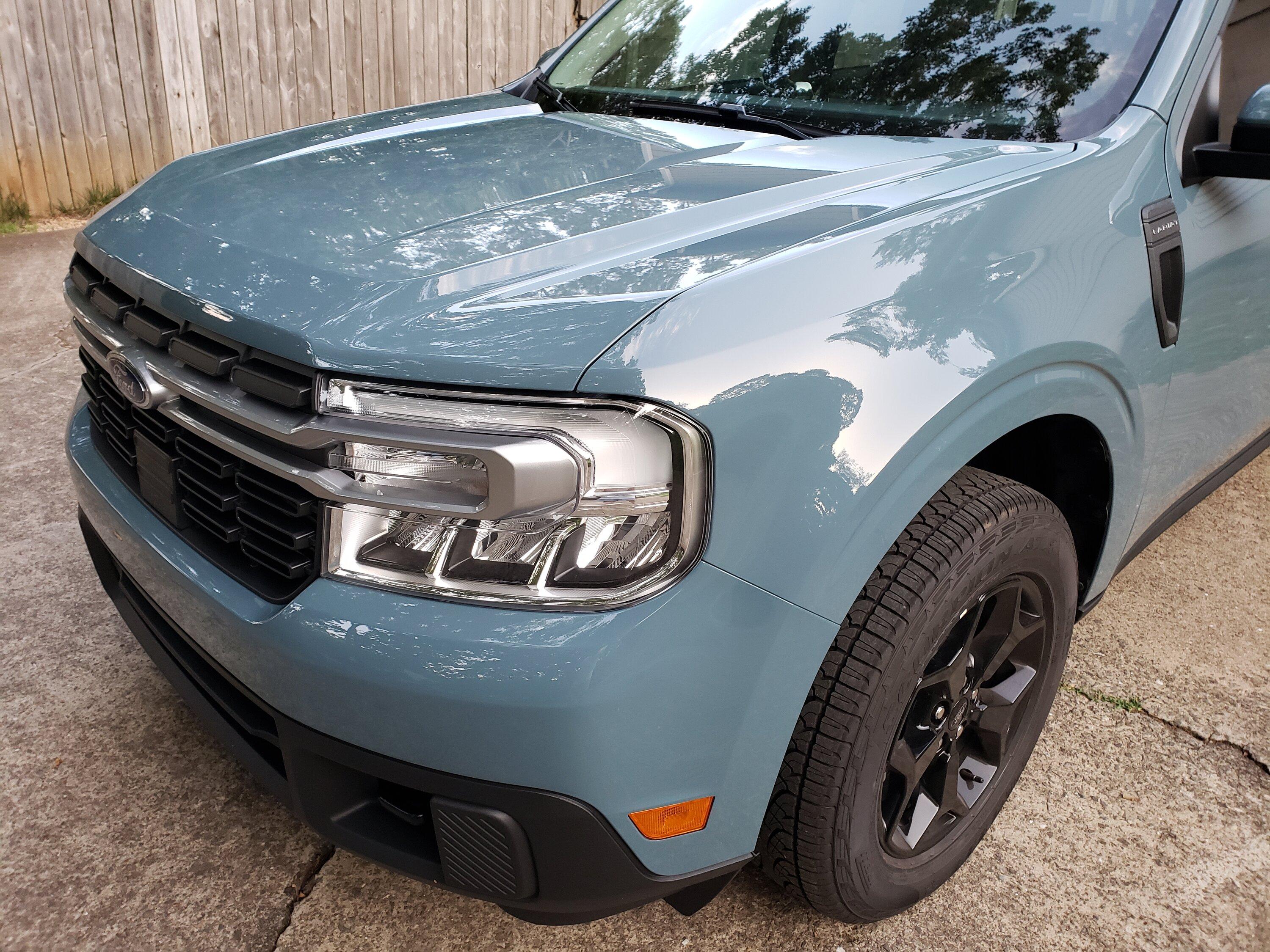

I use 3M Scotchguard Professional Series PPF, not the standard 3M ppf. I found it to be one of the smoothest in regards to orange peel that I've seen. It's not cheap stuff, but was worth the extra cost to me.
Pic of Ppf sample and one installed under Mustang trunk lid to save paint from loading and unloading, so this shows edge to comparing just paint and with ppf

Mine has been on car for a year in South Georgia and still looks great. I am a DIYer so trying to use the best I can get ahold of with zero orange peel. So far only the 3m pro series has fit that, I'll have to look into the suntek you show as that looks great as well.

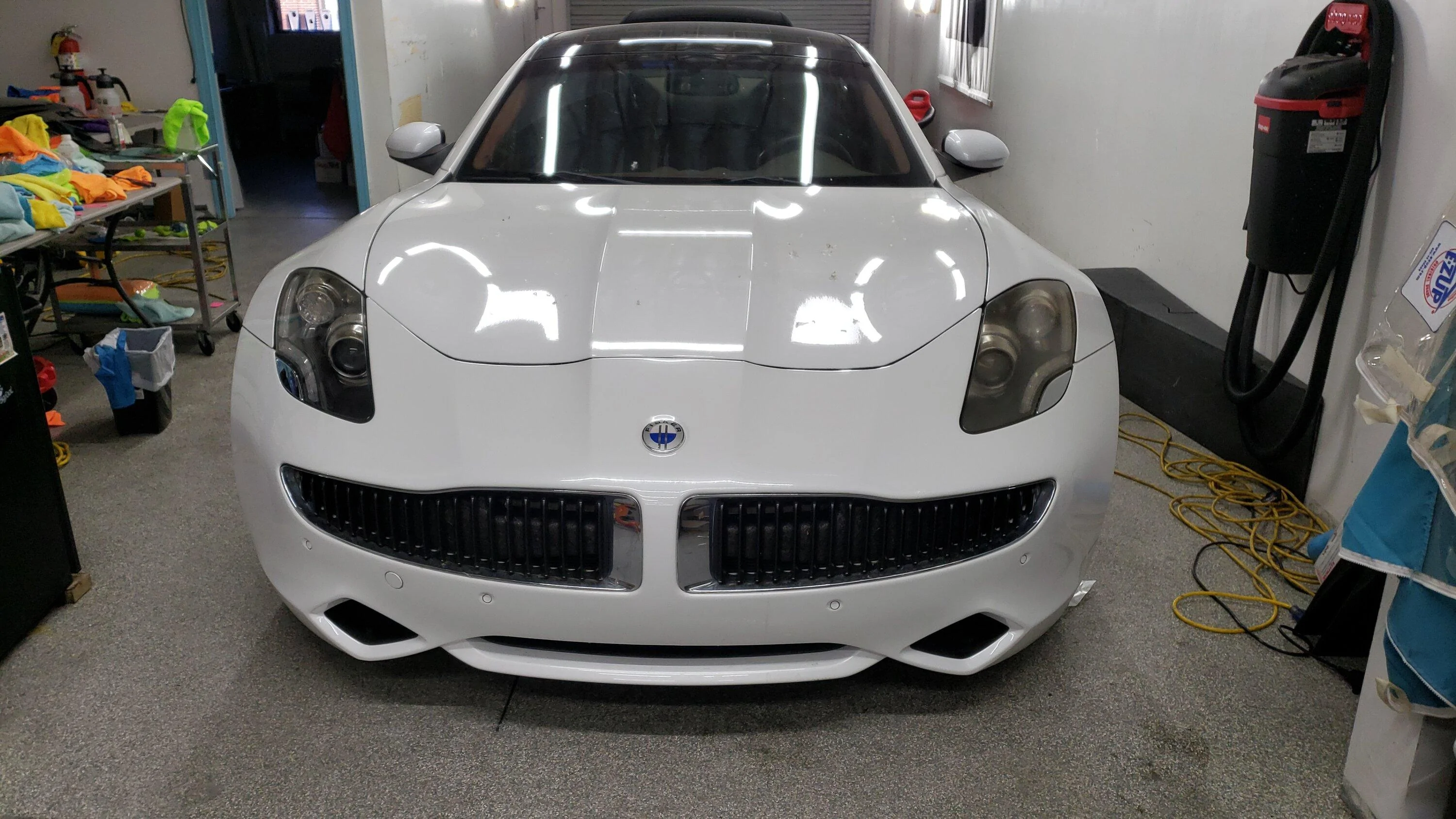

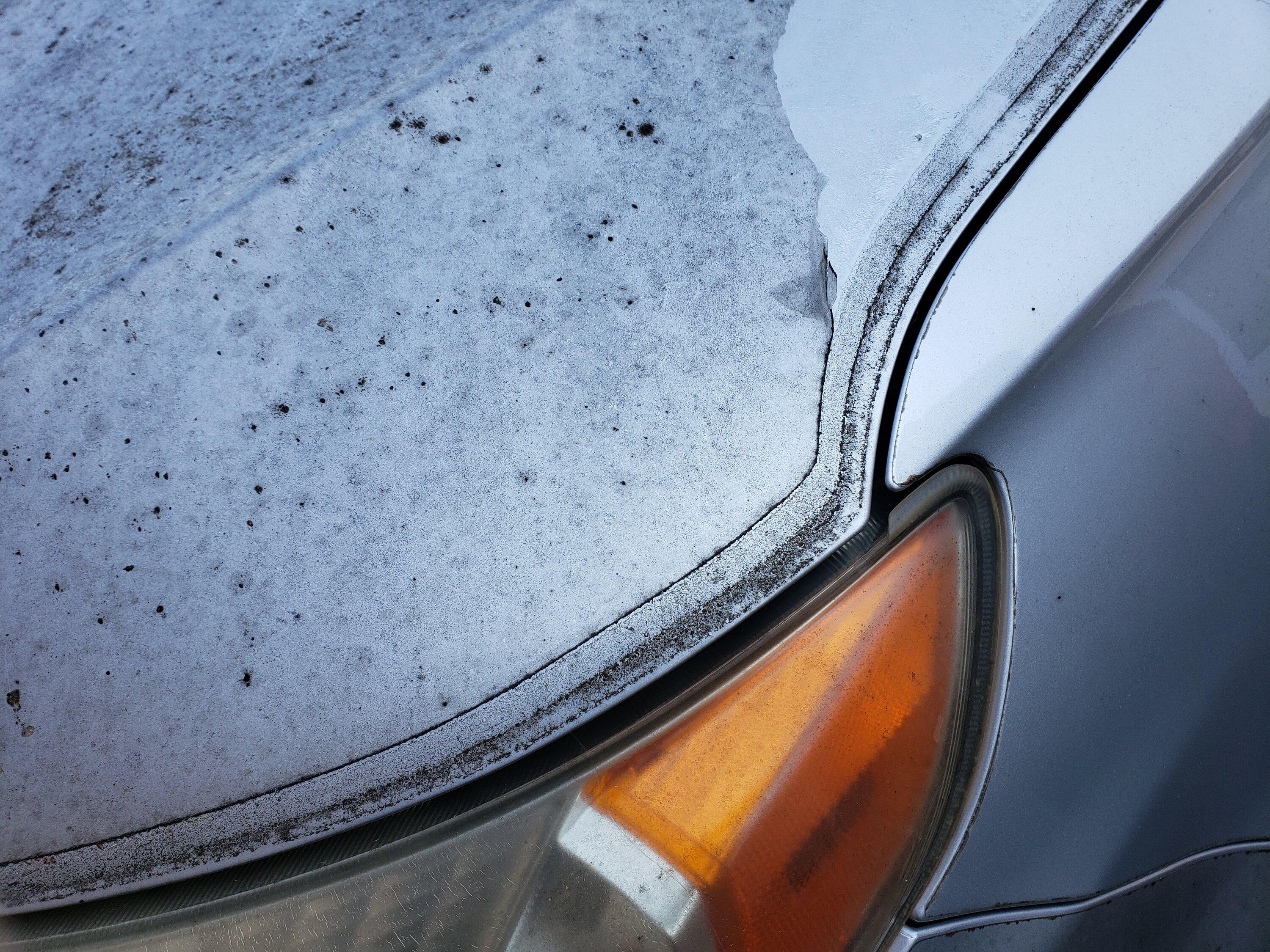

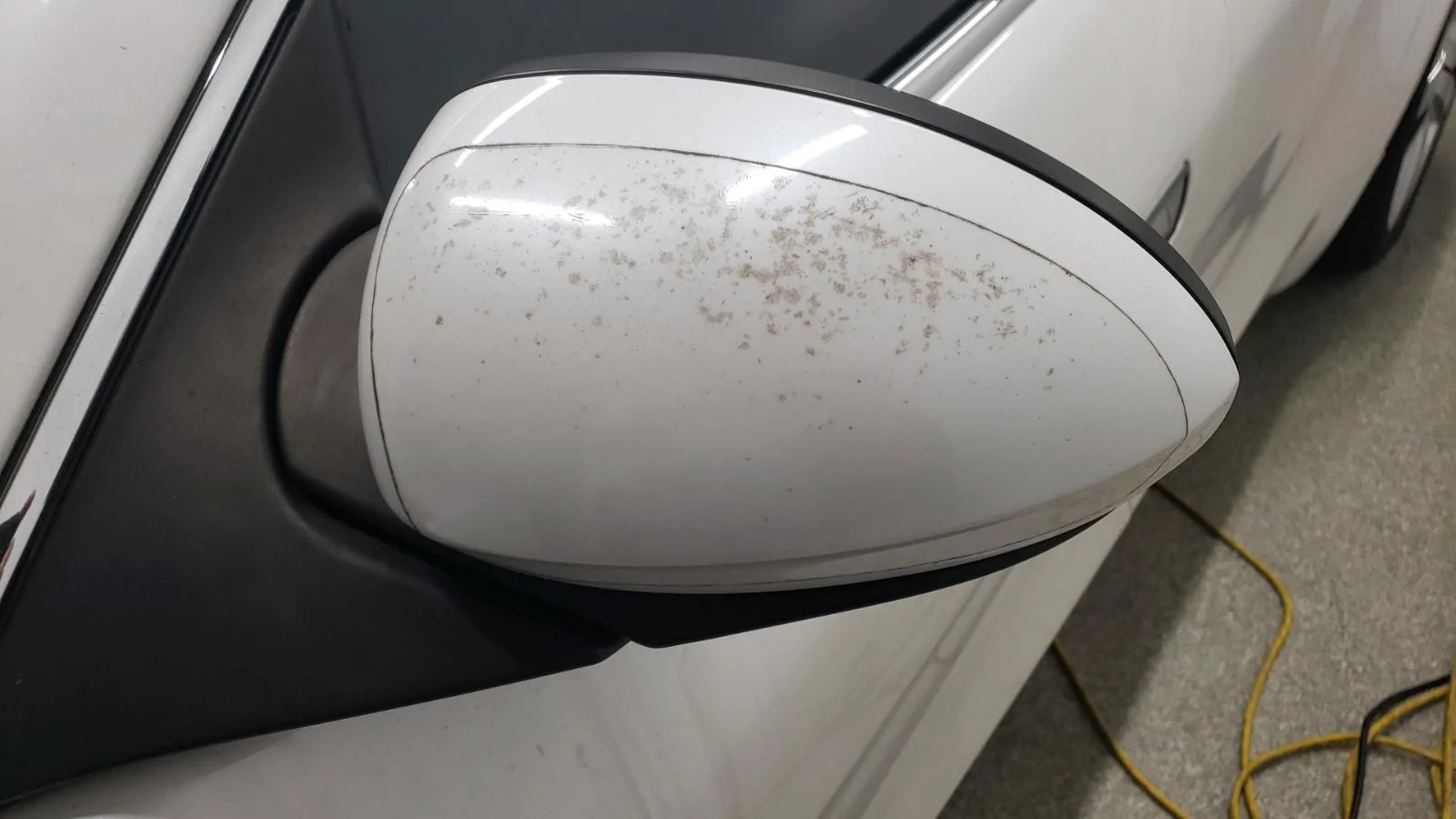

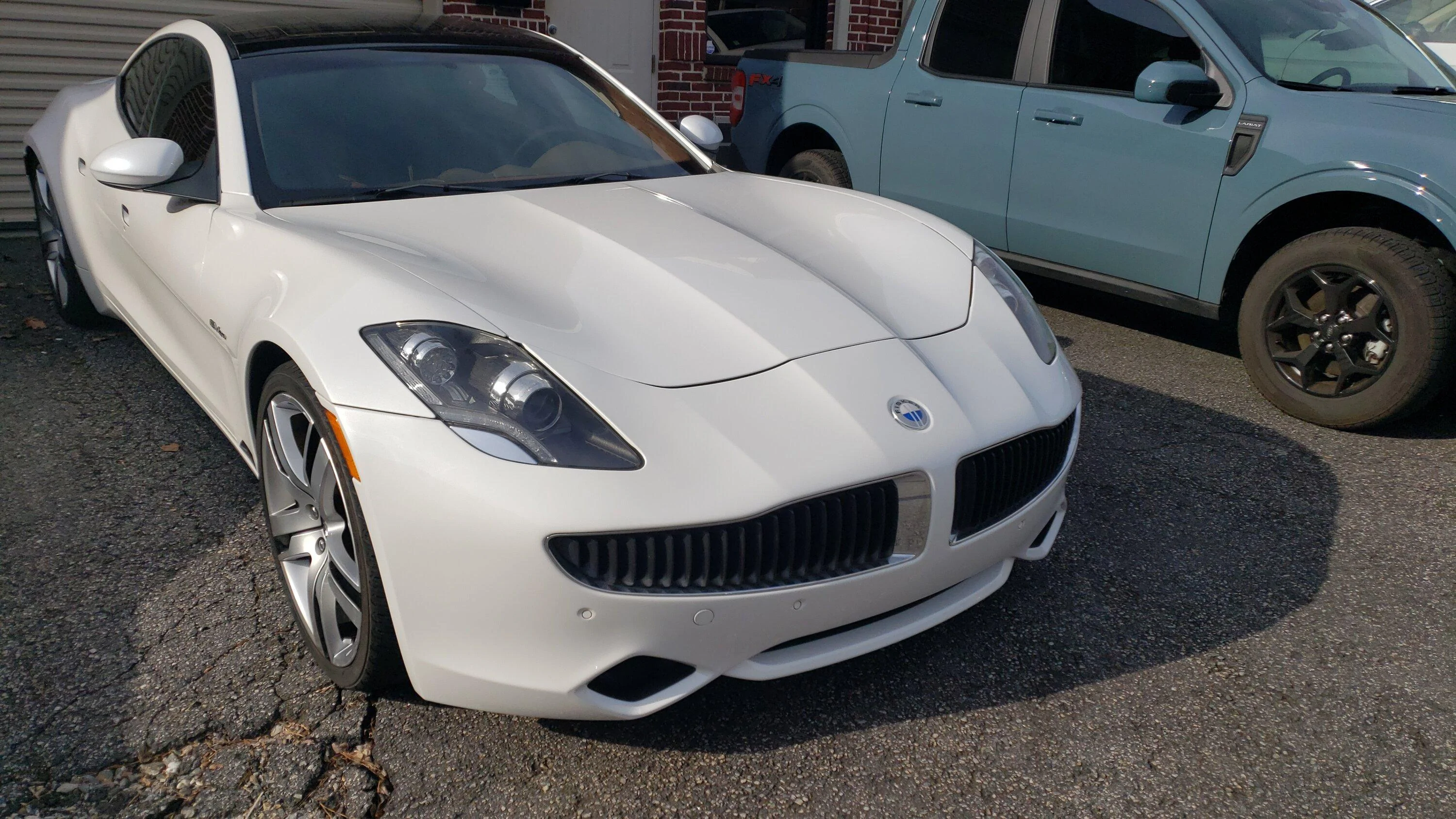

That car came out in 2012 and this removal happened a couple weeks ago. The problem I've encountered is once the film starts to look bad, its too late to easily remove. I always put wax on the car before each install, that helps make removal easier and instruct my customers on proper care and after five years it needs a checkup. Usually Ill pull off the passenger side mirror to see how much elasticity is left in the product. If its brittle, its time to replace it. If its still pliable, i put a new mirror piece on and ask them to come back in a year or two. Life of the film depends on how much time it spends in the sun for the most part
Black paint ages film faster than lighter colors but lots depend on how the customer takes care of their ride.

Since Im a DIYer, it seems sourcing or sampling the "good stuff" is a bit harder since I don't buy entire rolls or pro installer.
I ordered a few types from Amazon in the past including standard 3m ppf, but they had too much orange peel. My friend had a pro install with xpel but even it's got very noticable orange peel. So when I found the pro 3m pro series and it looked like glass I went with that.
