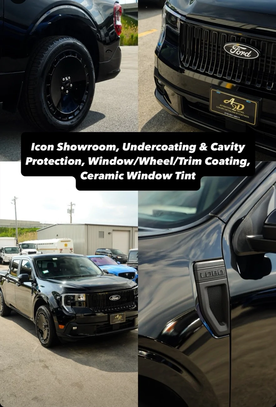

I went with a luxury company. 10 years on the icon rocklear coating and undercoating. Ceramic window tint and tinted ppf on headlights and taillights.
Spent $6k but I am happy with the work
