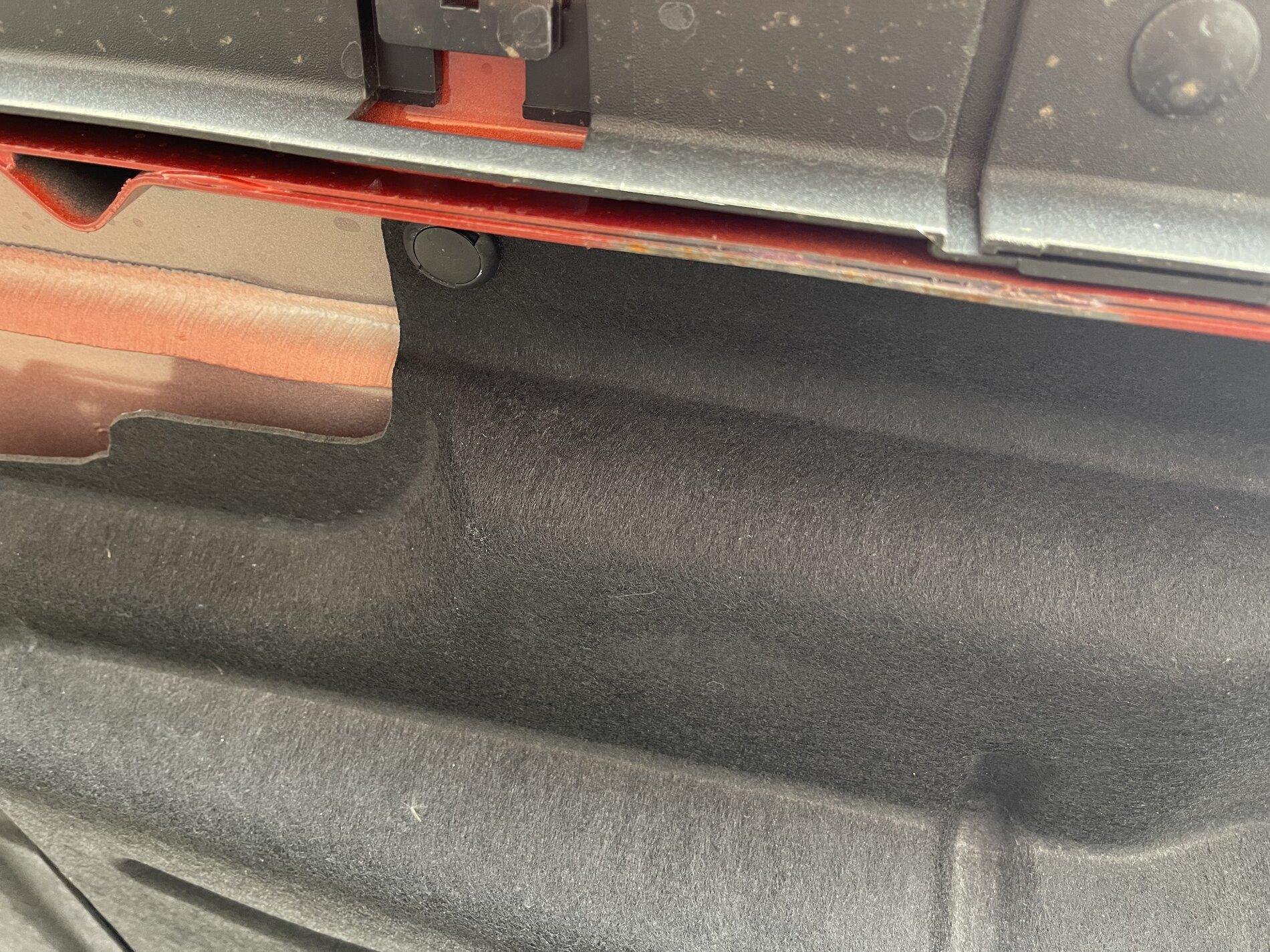

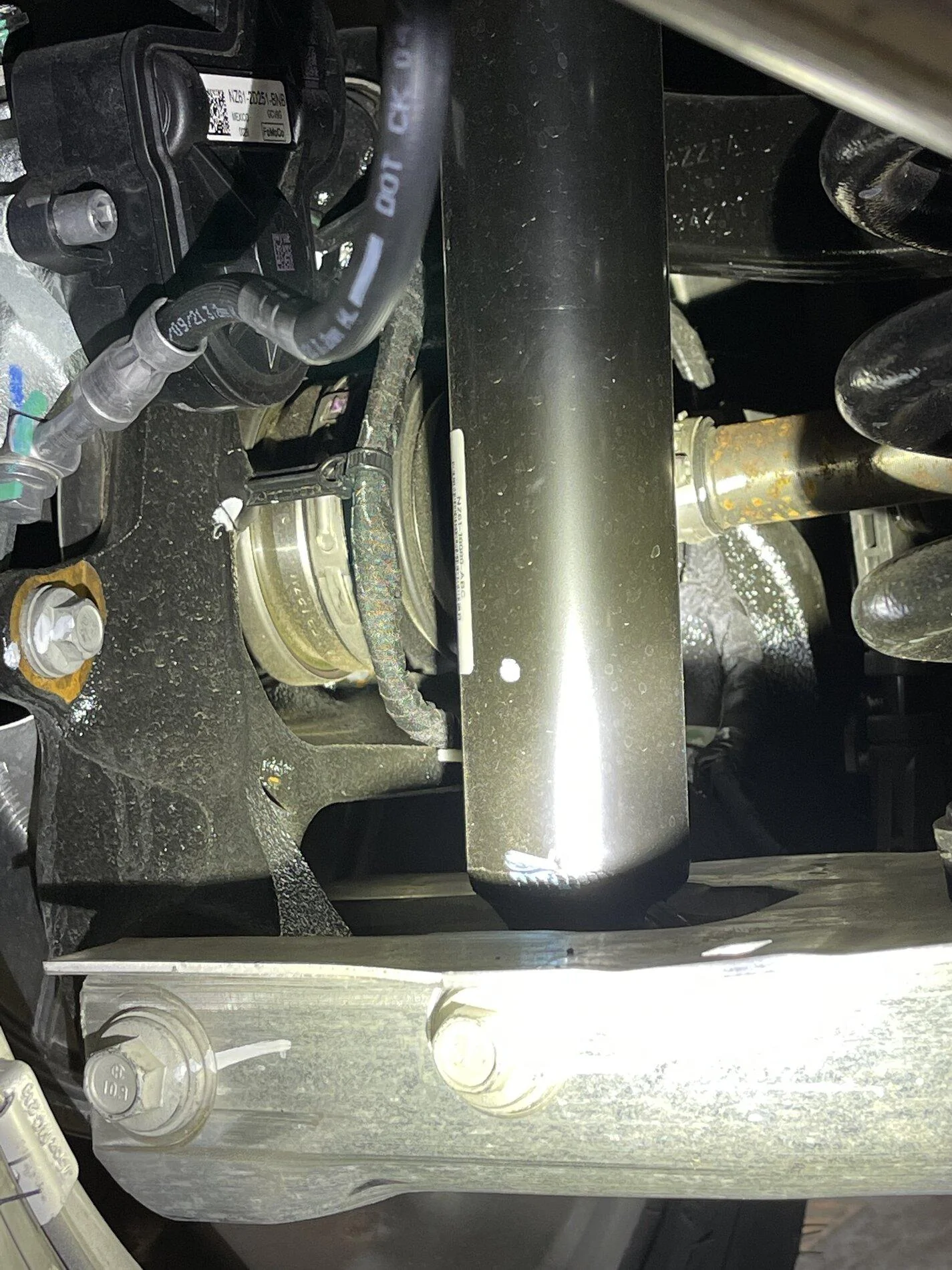

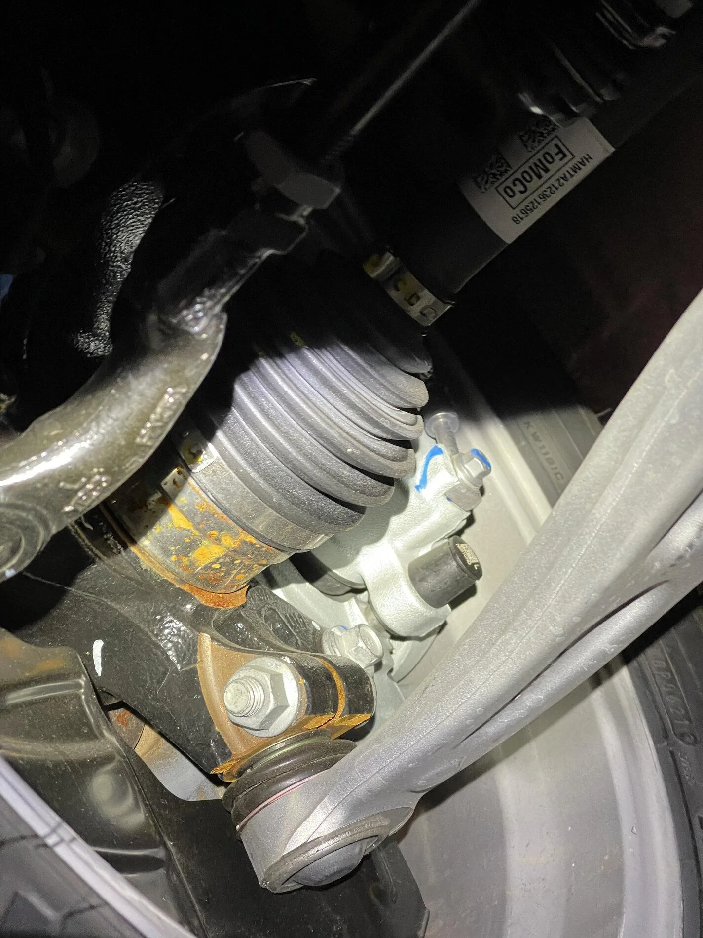

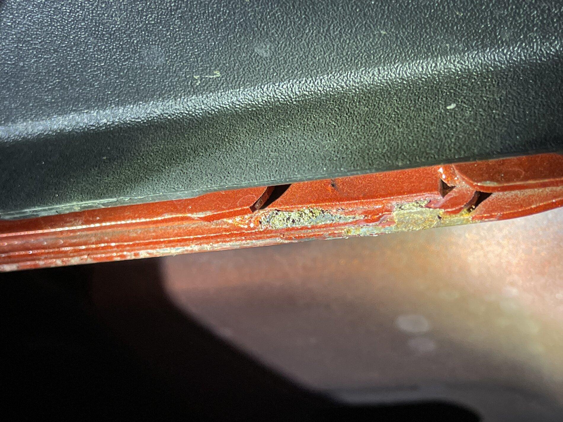

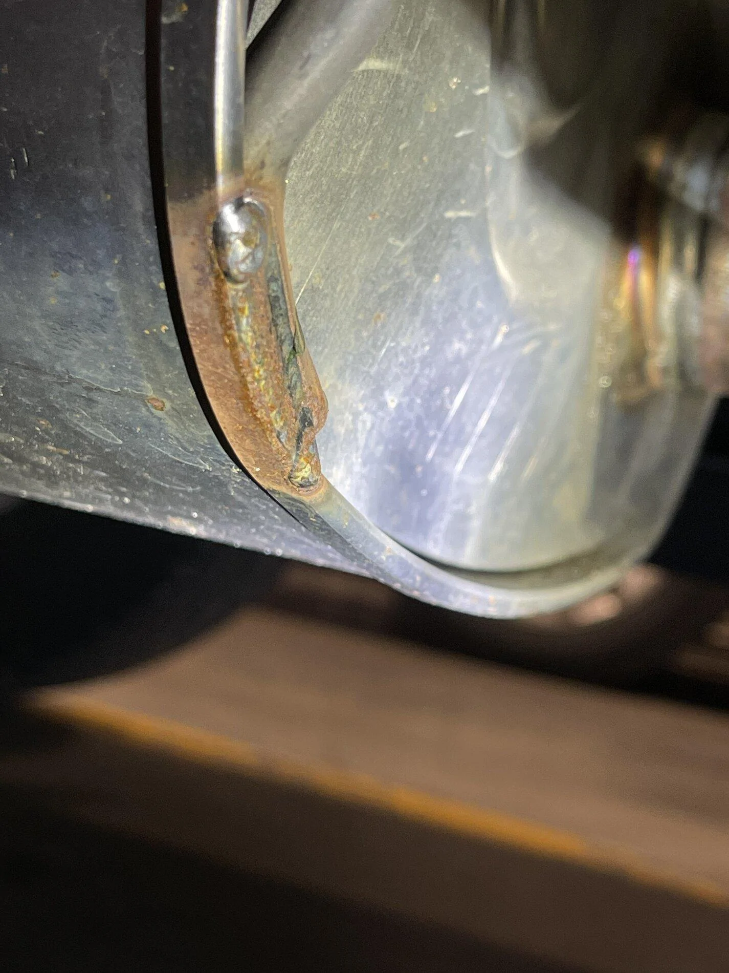

Was looking under my Maverick today and found some really concerning rust in the pinch welds below the rocker panels. I’ve had it for less than a week and less than 500 miles. Taking it in on Thursday to hopefully get it repaired under warrantee.
Yeah no excuse for rust so quickly. Why I'm getting an underbody treatment when mine arrives. I'll be looking first to see if there is any rust.

That is not 'acceptable' as some have indicated. Rust at that point will move up take out the rocker panel in a few years. And if it rust that quick, it will spread fast too. Good catch by the way! glad my hybrid is delayed, will be spraying cosmoline rp-342 like on my jeep. I was going to have it undercoated until I read that the coating harden and crack, trapping in water and causing rust. I pretty much sprayed anything under that rusts, including suspension and steering components. Just hate seeing rust even on components that dont really cause issues. As soon as my truck arrives, this stuff will be applied EVERYWHERE underneath.

You will find this on every single car at this price point. Remember, even if you paid 37k for your Lariat, the sheet metal is still made for a 20k price point, the mild grade steel exhaust is still made for the 20k price point, the cast iron steering knuckles are still made for the 20k price point. Blame rising steel prices and manufacturers seeking out cheaper options for steel, aka recycled Chinese garbage steel, mild grade steel on the mufflers and every other component where Ford needed their suppliers to shave pennies to get the truck to the 20k price point.
The pinch weld rust is because the tech probably didn't use rubber pads on their lift points when they put the vehicle in the air for the PDI. We already know that the 20k price point paint job on the Maverick damages if you look at it the wrong way so clearly putting metal lift points on the pinch welds are going to damage the paint and primer and reveal low carbon content mild grade steel which will oxidize quickly.

Only alarming thing I see is evidence that this new type paint is not very durable in high impact areas
My plan...MUD flaps
If I find minor areas like this rocker pinch weld area I will spend 3 mins with rotary wire brush, 5 min masking, and 5 seconds spraying on one of the 50 good protection products for this
I am much more concerned with the photos showing rocks and mud inside the tail light wheel well cavities. Once it get mine if ever I will address a way to block that road spray in there.
Underbody surface rust is not warrantable.

The only place I remember seeing rust on my Ranger, Fusion and Edge was the muffler since it is exposed metal that endures extreme temperatures.
