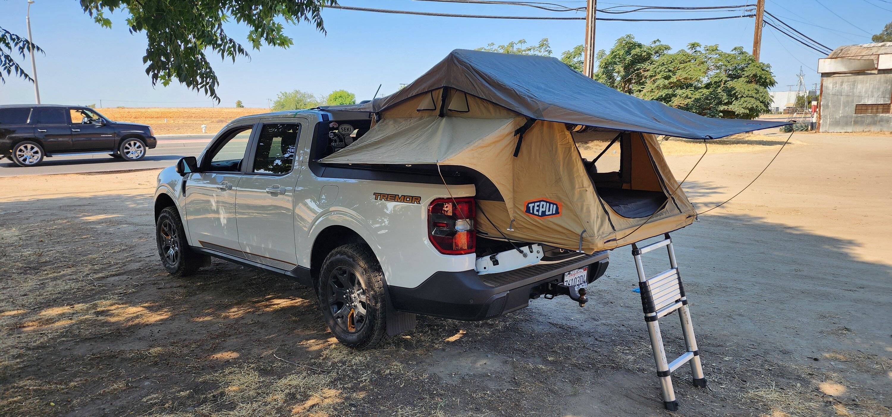

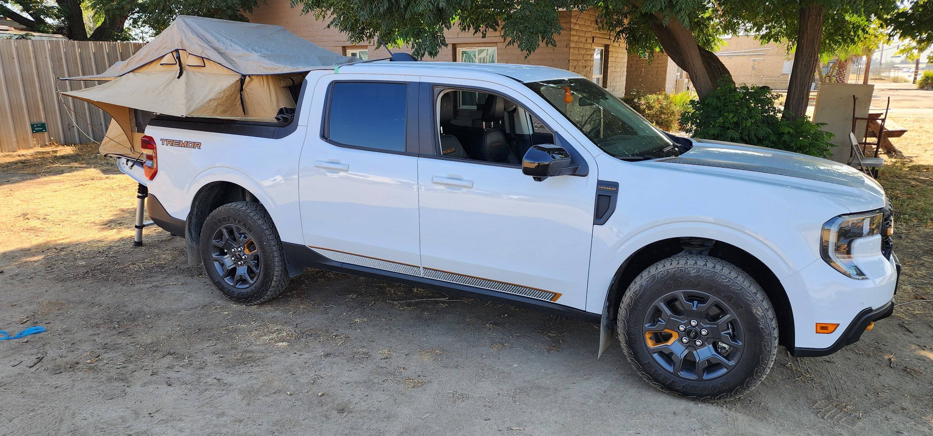

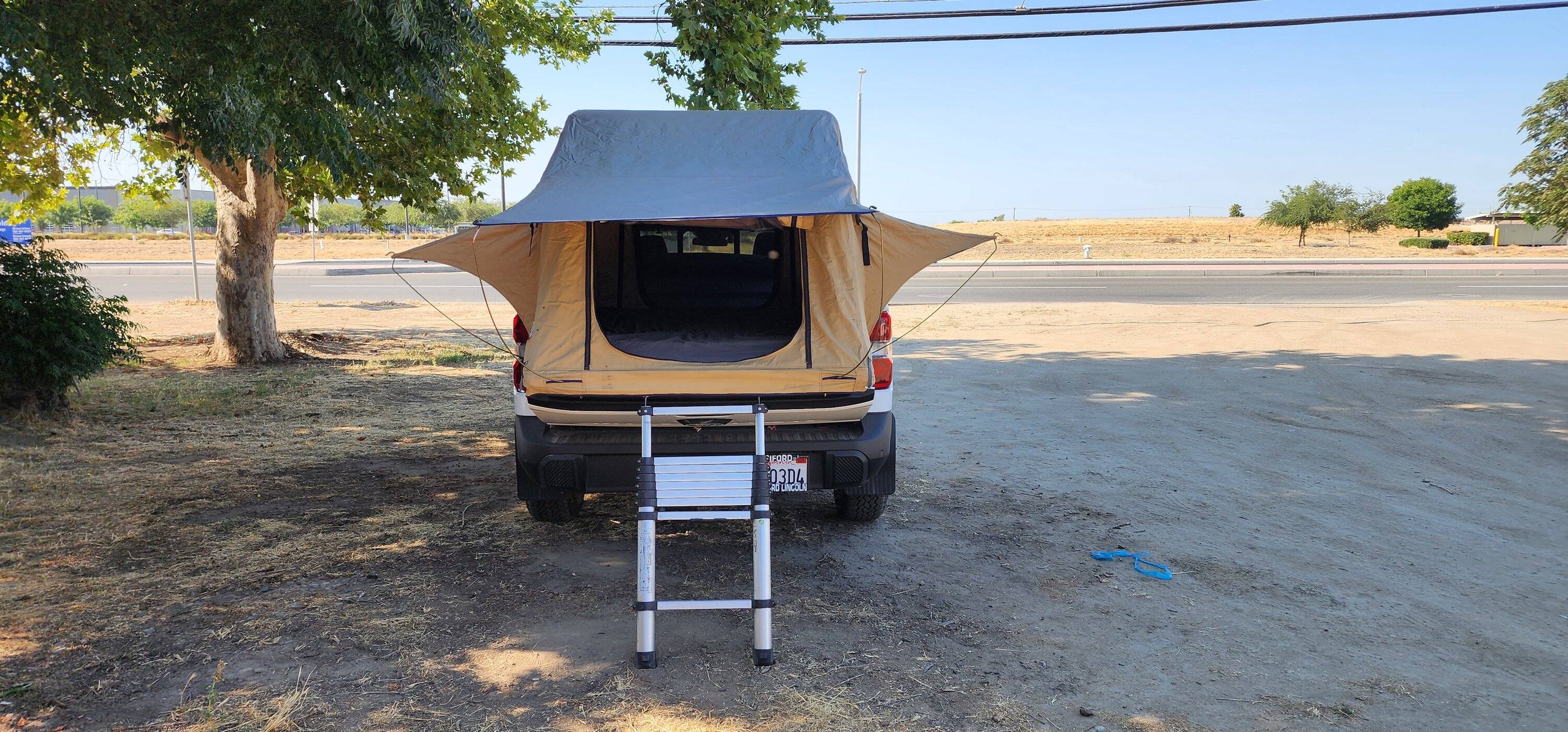

Here is my latest and hopefully final step in making it quick, easy, and comfortable to camp in my Maverick. This is a used, smaller, folding roof top tent from Facebook Marketplace. I got a pretty good deal on it because the soft cover was a little damaged and there was a little mold. For how I am using it, I do not really need the cover anyway.
This tent is/was probably a little too wide, by about 1/4". It is tricky getting it around the striker rods for the tailgate when folding and unfolding it. Luckily the ladder is so long that it makes a good third hand, holding the tent partially open, as you make sure it is not catching on the tailgate parts or the tonneau cover mounting hardware.
Even though the soft cover was a little damaged, It would have still kept some dust out. It was just too difficult to pull it over the tent with so little room between the tent and the bed sides. I took the cover off. I'm probably going to find some sort of tailgate seal kit to help keep the dust out.
There is about a 6" gap under the tent. I'm going to build a big pull out drawer out of 2x6s and plywood to go under it.
I am not entirely sure what model this tent is. When I asked the seller about the model name for the purpose of confirming dimensions, he said this specific model is discontinued.

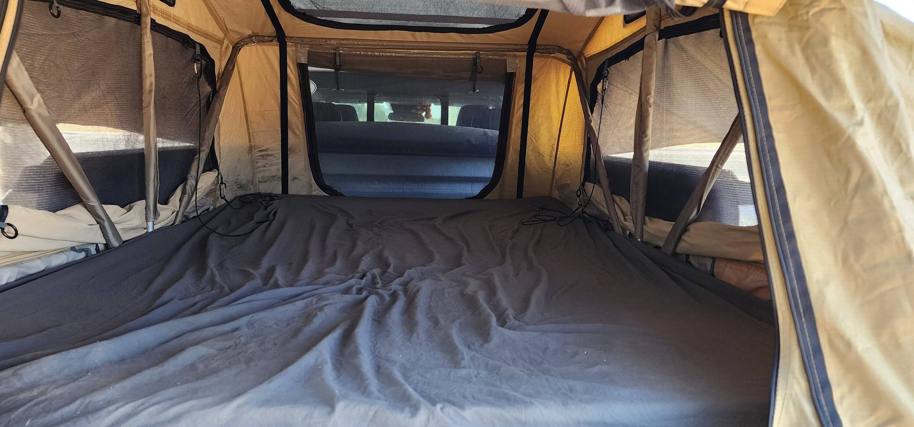

Love this. Sorta wish I went that way. It is able to sleep two people somewhat uncomfortably. Lol. I went with a cap and raised floor to sleep on, because I’m 5’5” and can fit at an angle. Perhaps maybe I’ll go that way in the future.

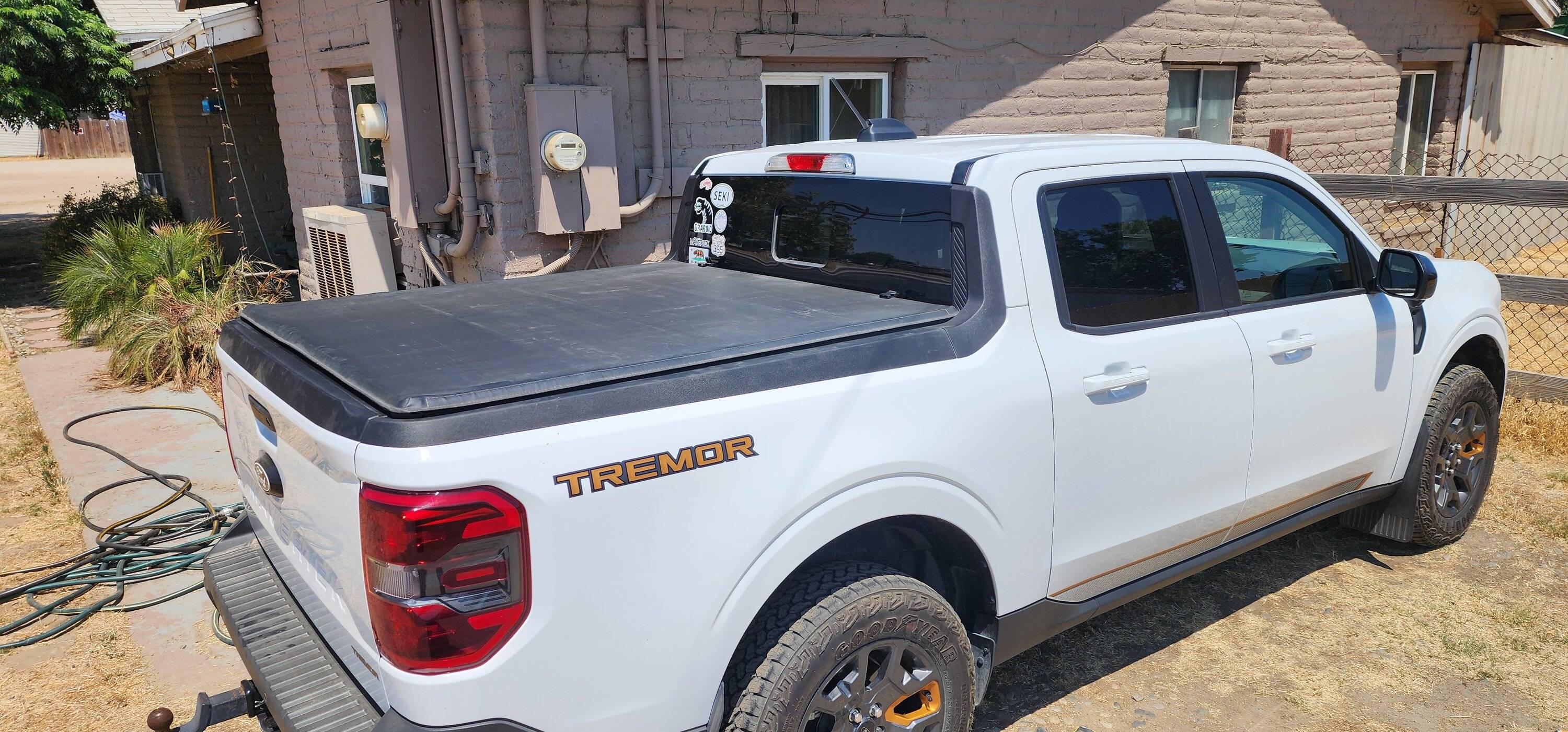

That's what I did. When the tent is sitting on the wheel wells and the partially open tailgate (4x8 plywood mode) there was just enough room to close the tonneau cover. Under the tent, this gave me almost exactly enough room to fit one finished 2x6 standing up under the tent. There was NOT enough room for a finished 2x6 sitting on top of plywood, to make the drawer. I was going to rip down the 2x6s by the thickness of the plywood to bring the finished drawer back down to just less than 6" again, but I decided not to rip them. I built one big drawer that covered the whole bed that is slightly taller than 6" and slightly lifts the tent off the front wheel wells.

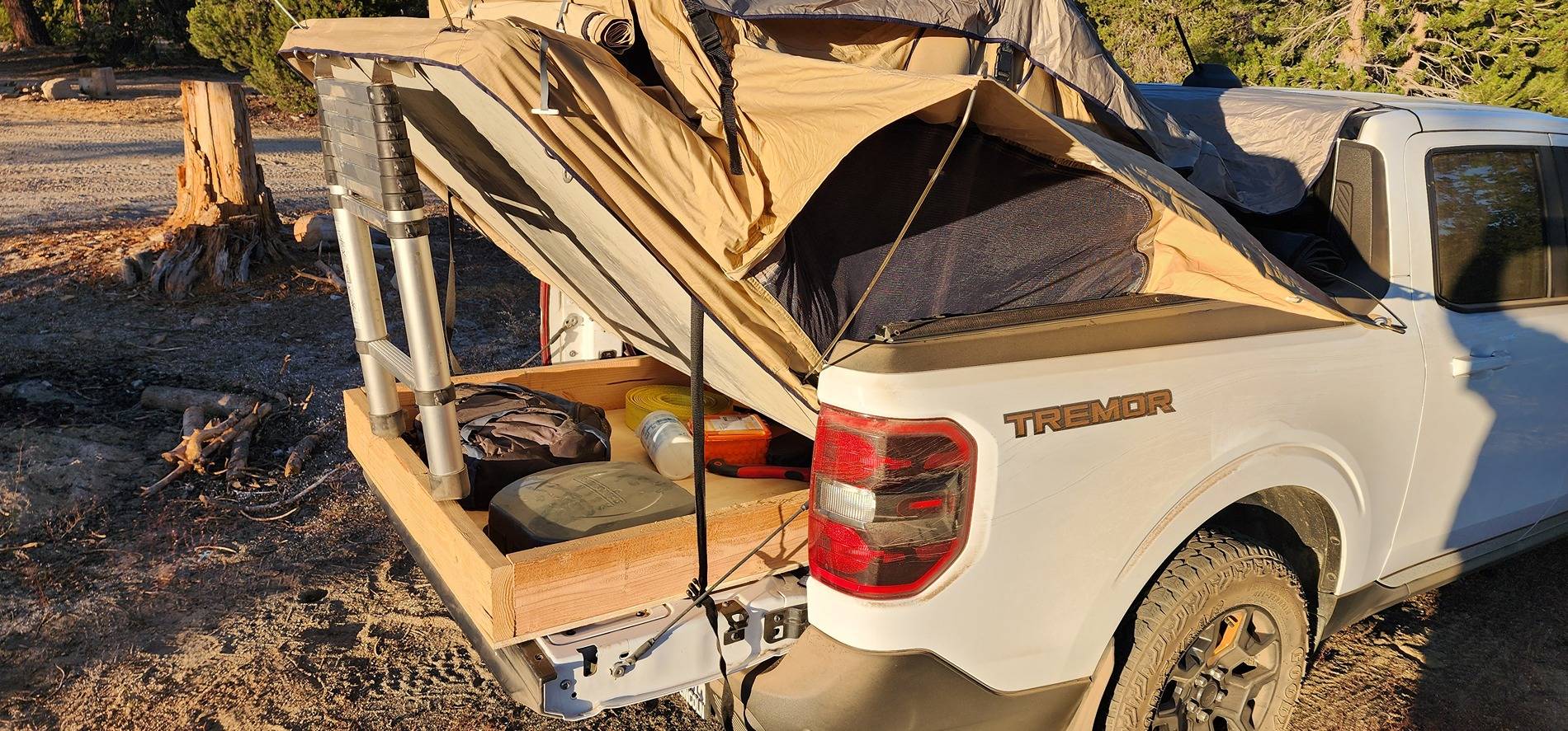

Also, with this drawer, I do not have to put the tailgate in 4x8 mode anymore. I just pull the drawer out to just past the tailgate and it holds up that side of the tent just fine. I can partly lift the folding half of the tent to easily access almost all of the drawer. Because it is a roof top tent, is has a super long 8' ladder. I do not really need the ladder once the tent is set up but it works great as a third hand for safely getting the tent around the tailgate pins and holding the tent partly up to access the drawer.
For the last two weekends, I have been helping with some SAR of a lady that drowned in the Kaweah River last March. This weekend, I get to finally try out the tent in the wild. I will gat some more photos of the drawer and the whole set-up out in the wild then and post them here :)

Here's a couple photos of it set up out in the wild and a picture of the drawer. I'm in the hills somewhere between Shaver Lake and Huntington Lake at 7400 ft and it's in the 30s up here. I slept pretty well but what the heck? It's July! LOLl I made a setup video too. I'll put that here when I get home to edit it and put in some captions
