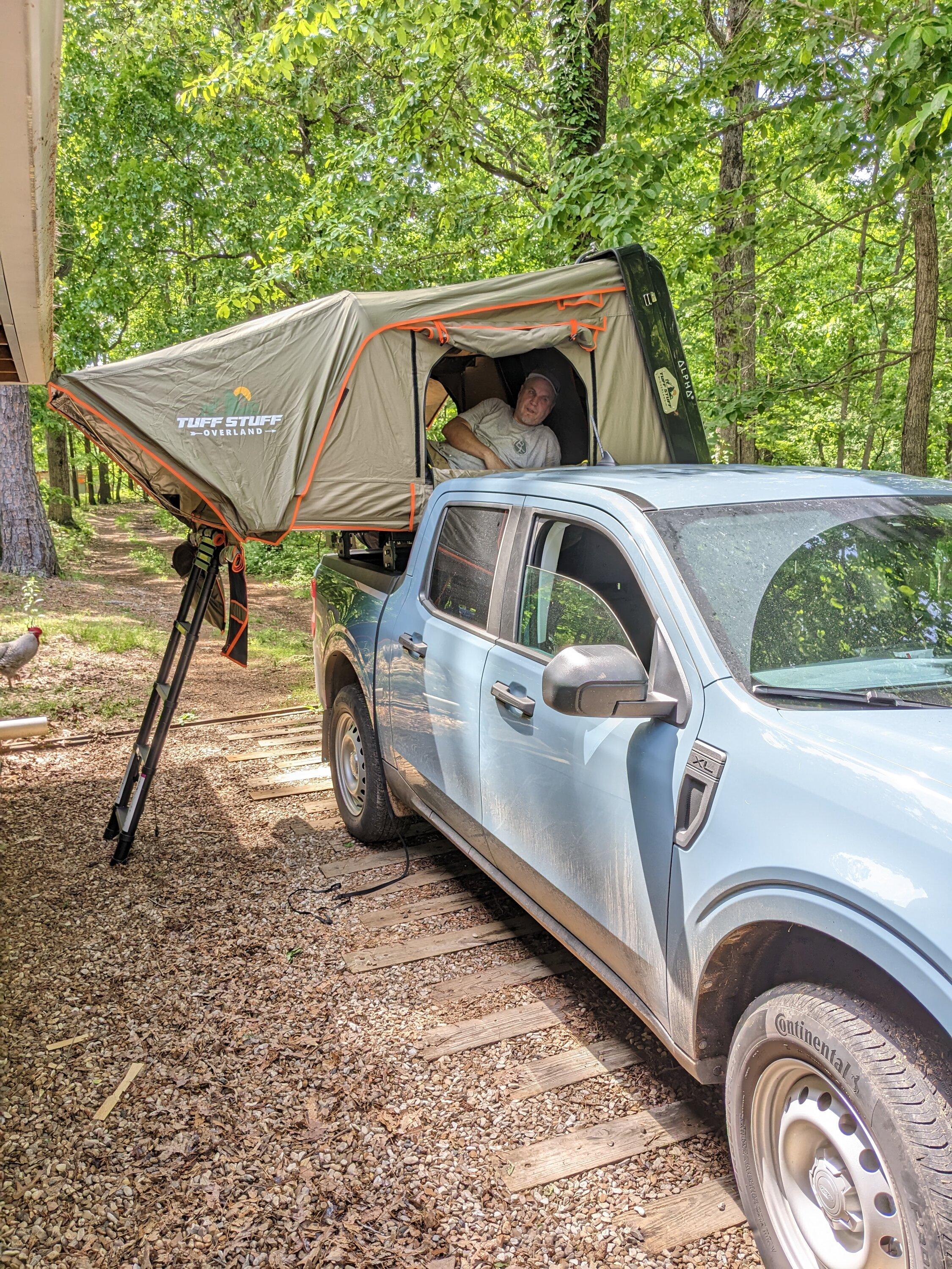

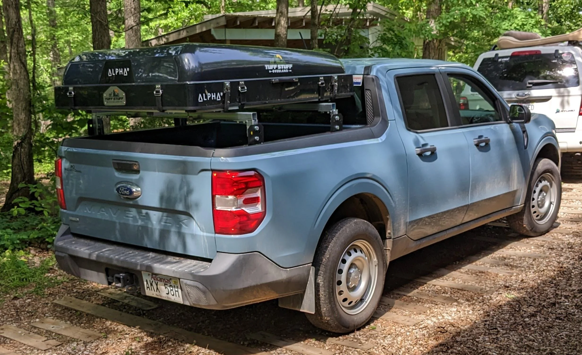

Added a TuffStuff Alpha II "rooftop" tent on self engineered bed rack made with 4 Simpson Strongtie brackets and Unistrut. Queen size bed. Overhangs the bed in the back but doesn't reach beyond the tailgate. More info once we spend a night in it.

@Bigsarge. Closed it is about 48 wide, 60 long, 13 or so high. Sits about flush with the cab now but may lower the rack after we fit a tonneau.
Folded out, bed is queen sized; 60 x 78 or so.

@Bigsarge I should have added that I've only spent one night in it so far. Found the mattress toooo firm. Making plans for another inch of foam.

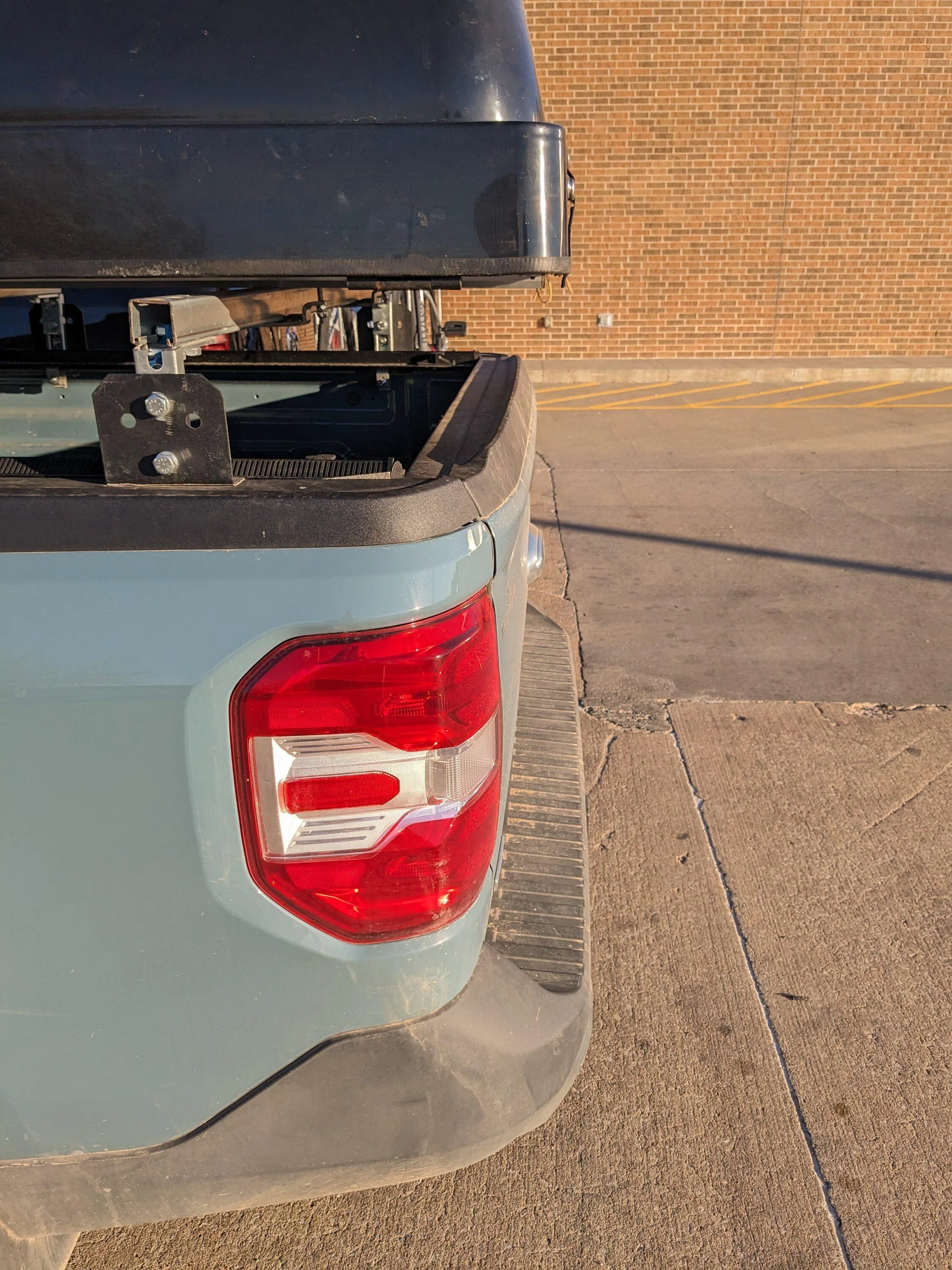

@64Jazz. Hang in there. We waited 11 months but it was worth it.
I don't know if I have a picture showing it, but was delighted to discover that the RTT does hang over the closed tailgate but doesn't extend past the bumper.

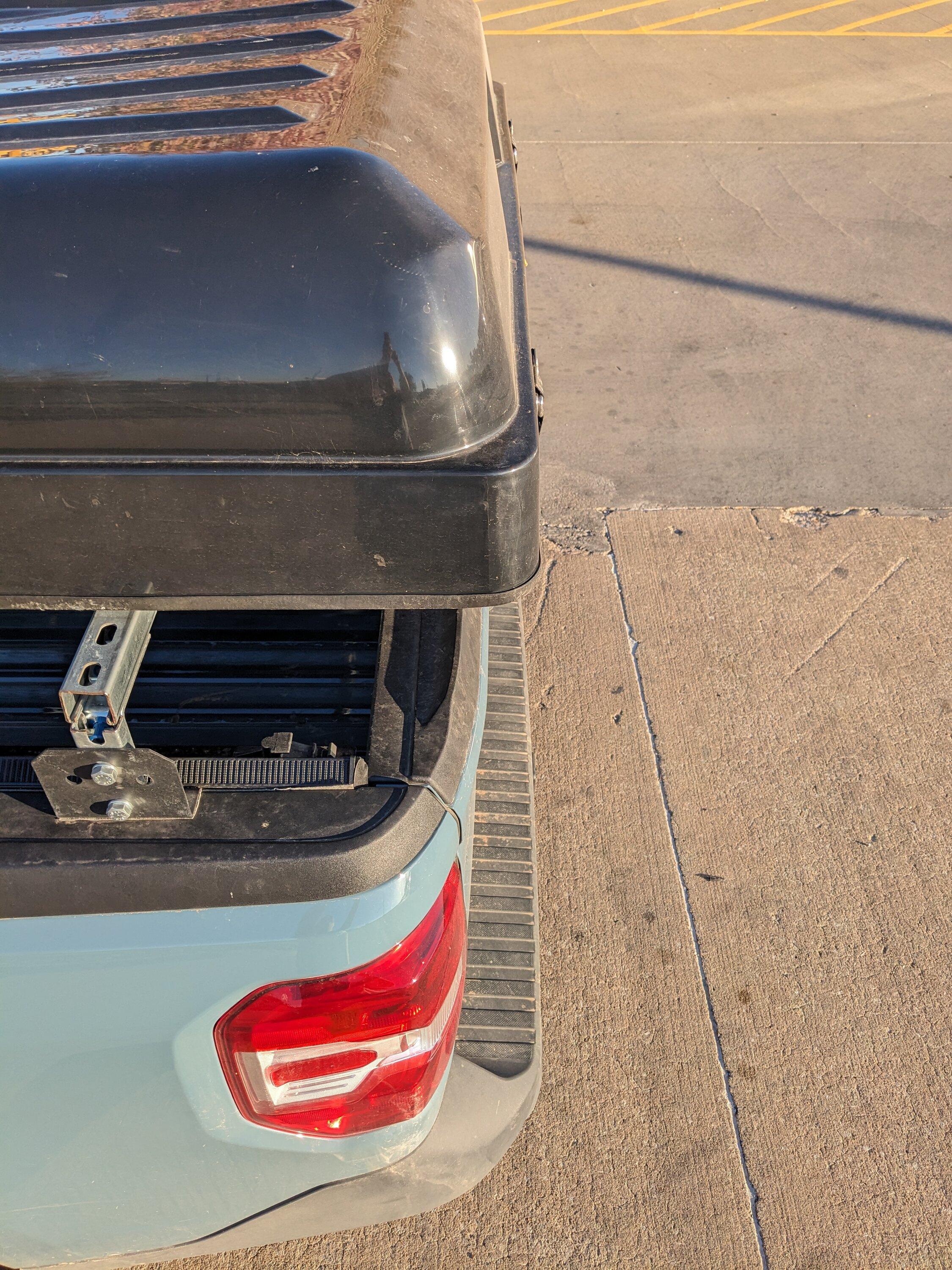

I was about to repost the same pick. Sorry I don't have a good pick showing it, but it is even with the bumper. This is the Alpha II, not the original Alpha.

Had a chance to take shots showing how well it lines up with the bumper.
