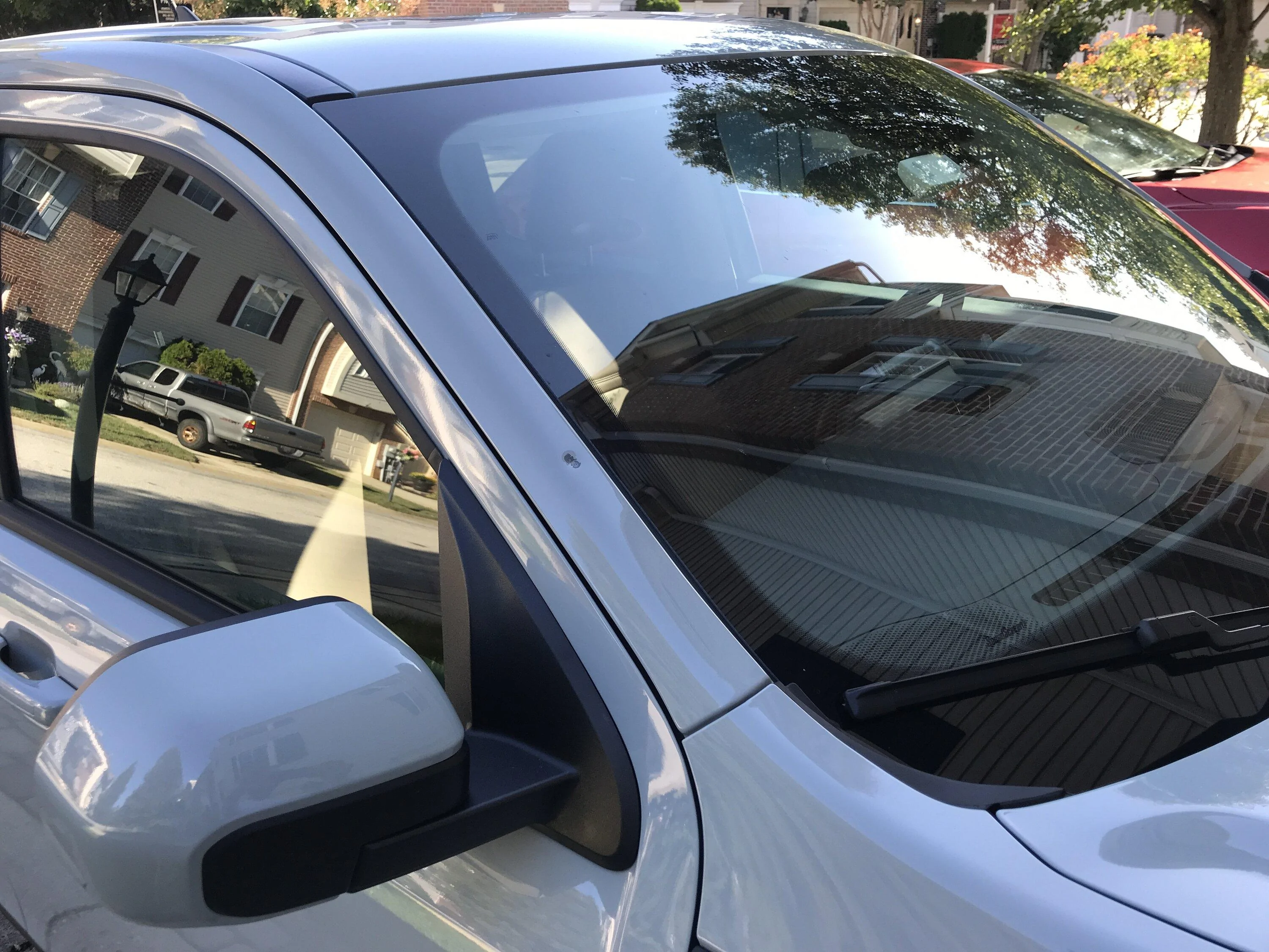

Dang that must have been decent size rock, ashamed it didn’t hit the windshield that be easy fix

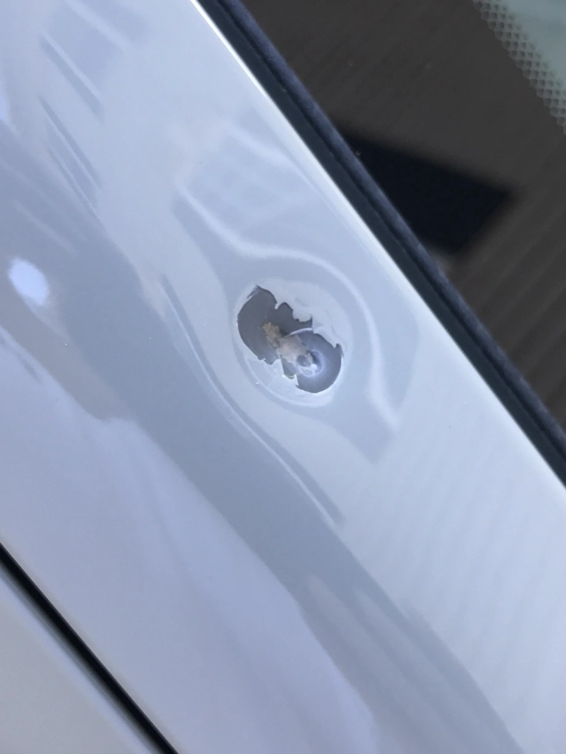

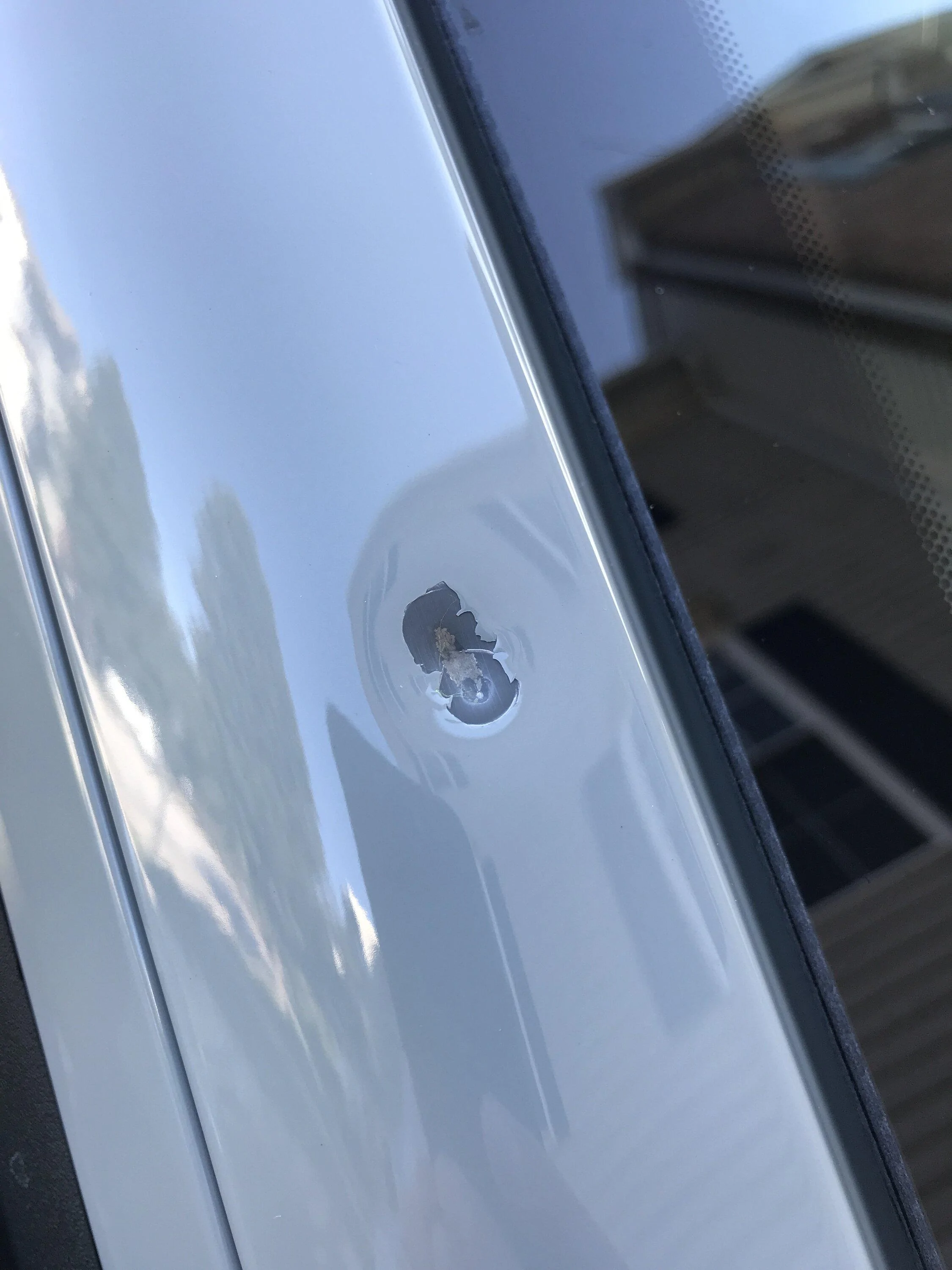

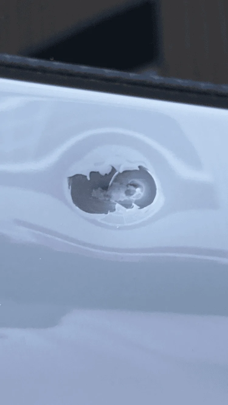

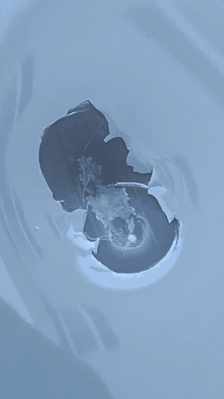

That's definitely too deep and compact to "pop" back out or do paintless dent removal. If it were me, I'd clean up the spot, put some Bondo in it, then go thru the primer-paint-clear process. Unfortunate to have to do that to such a new car. I'm sure a body shop would probably do the same thing.
Glad you said it first...about Bondo. I repair and do a lot of body work on classic Porsches and it is no sin to use Bondo. First I'd get rust out of the way Immediately with rust preventive primer. Rustoleum works. Then I'd look for a small local body shop's opinion...or two...and just ask if they'd use Bondo? Car manufacturers of new cars use "filler" to blend seems of sheet metal, and it's just a fancy word for Bondo.
The biggest hurdle for most paint booths shops is covering the body area where it is not getting painted to keep off over spray, dry then clear coat. Putting it back to straighten metal would probably be cost prohibitive and probably require removal of windshield and it's camera.
The Maverick is very thin sheet metal in 5,000 miles I've already collected two significant door dings. Buying the $25+ touch up paint would not be enough to cover this wound...probably take a pint of paint.
Might be worth talking to a FORD body shop to see if the entire strip around the door back to the bed could be removed and replaced...it's possible depending how it is attached to the body.
Edit: Looking closer and blowing up the jpg. I'd get opinions but probably Bondo it myself (it is not hard at all; most of work is a little sanding off excess), and have a Paint Shop paint it for you...most paint shops can't afford to clean up their gear and tape off a job for less than a few hundred. Jobs like this are almost always best to look for the 1 or 2 man shops. Small body shops have much less overhead
