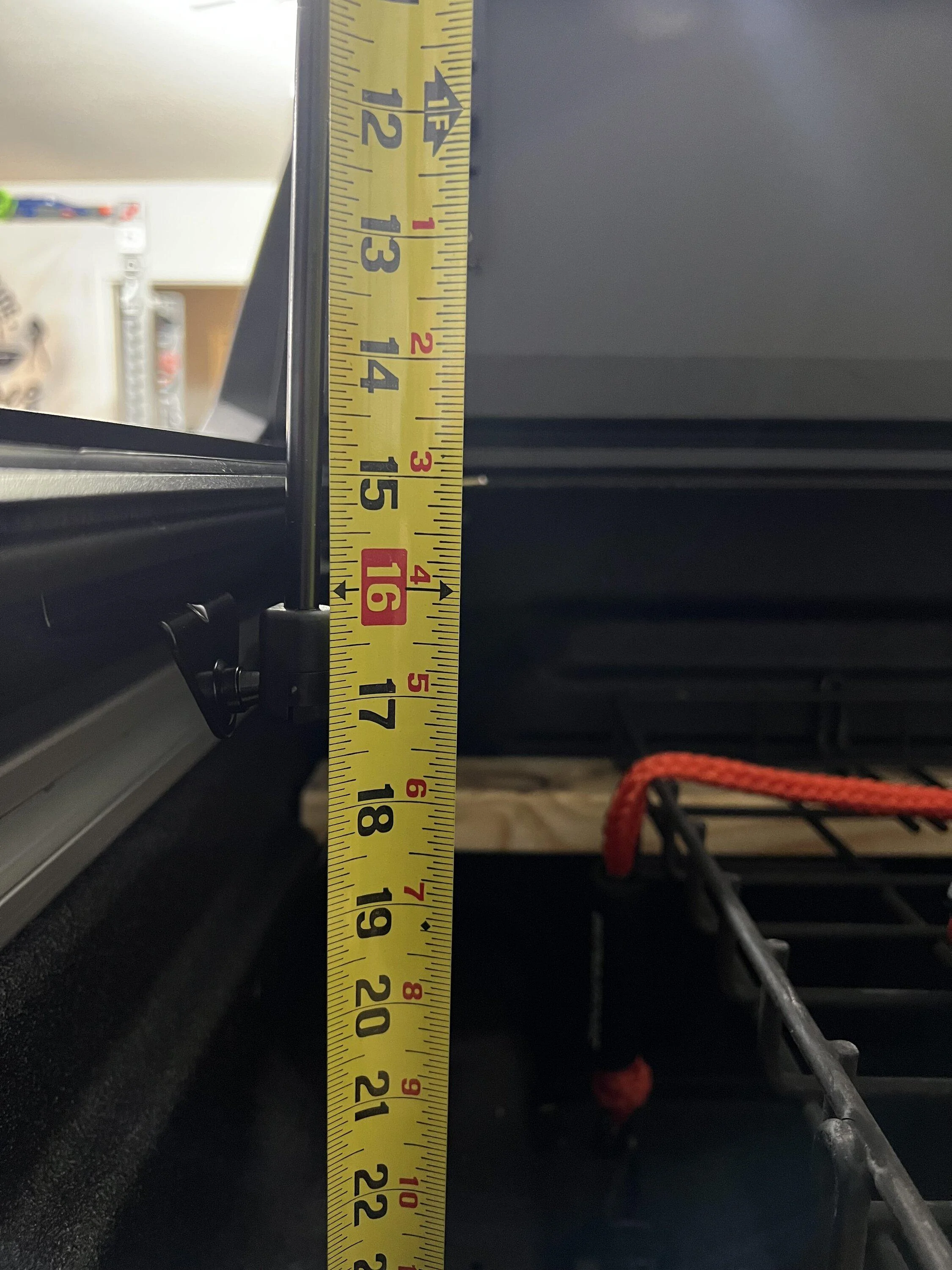

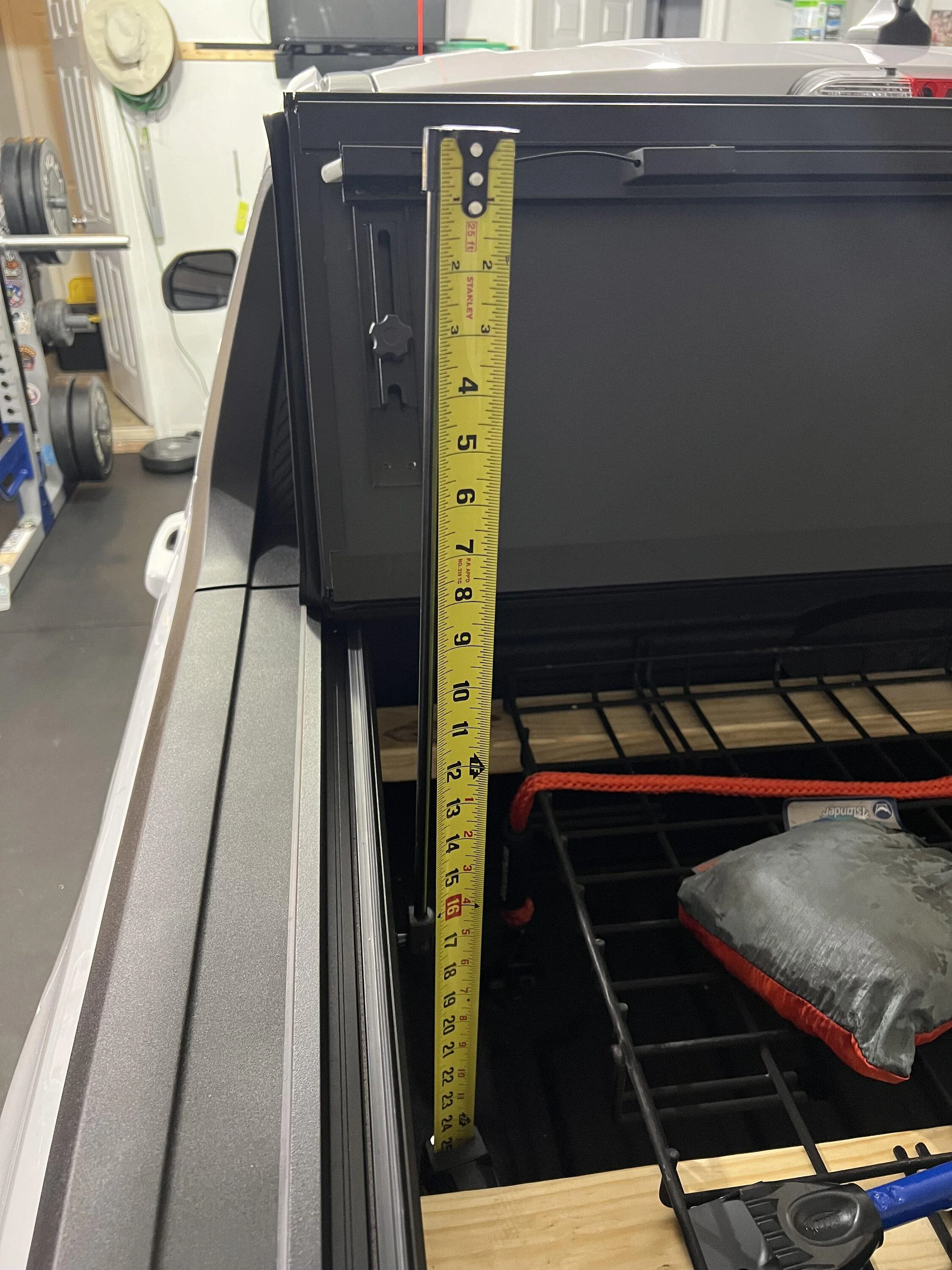

If I look at you other side, the nut is about halfway up the slide where as the side your showing it looks like the nut is farther down. Doesn’t the nut slide all the way up?

Alright I figured it out, the two rivets at the top of the video were blocking the slidey part. I tapped it with a hammer a few times and it shaved enough plastic off so I can move it all the way now.
Pretty shitty design for $1200
So it wasnt an optical conclusion😁 Now I know what that is...the "slidey part"😄 Glad it was an easy fix. So frustrating to buy something new and its not quite right.

yeah it’s in the full up position in the pic
There's still a lil further that slider can move. I bet it's kind of hung up on the rivet. Loosen more and jiggle it as you slide up.
