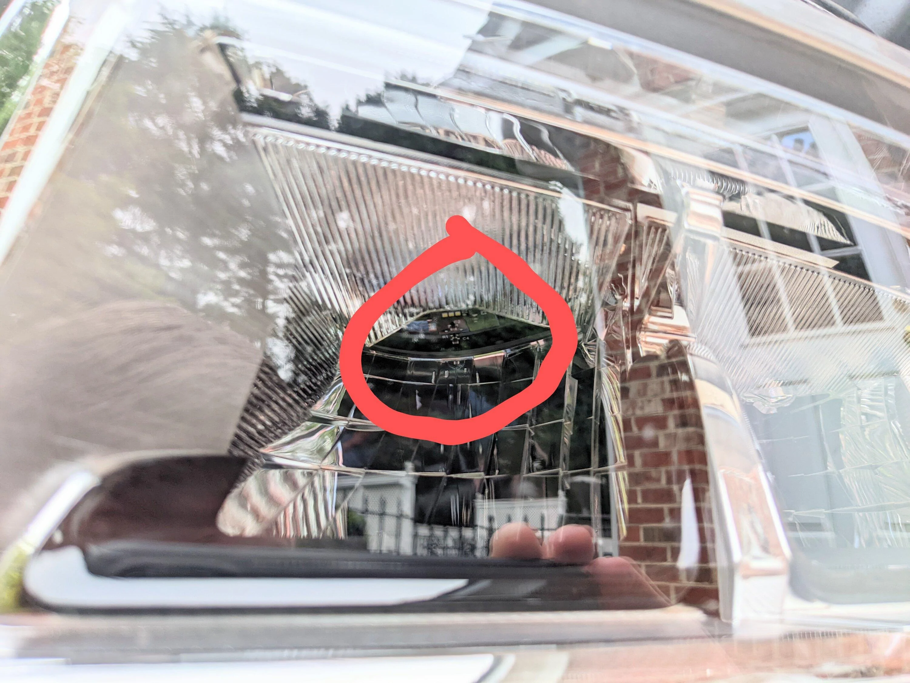

FYI here's a photo of one of the headlights on my truck. It's kinda hard to see because of the reflections, but I circled where the LEDs are that shine down on the reflectors. You cannot just swap these out, and I don't believe for a second that Calvin B replaced them with those aftermarket bulbs he posted - that makes no sense.

Pretty sure that guy means it was just the switchback LED's he swapped out
Who? Calvin B? He posted a link to actual headlight bulbs for other cars. No way in hell those are working as switchbacks for the turn signals. He's absolutely full of it - a bot or a shill for that retailer he linked to
