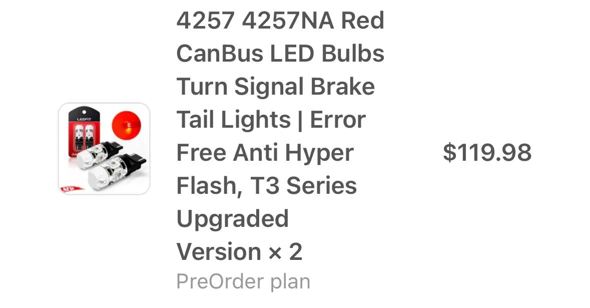

I can confirm, the upgrade Lasfit rear bulbs work on the Lariats. Have a 23 Lariat Tremor, and other rear red bulbs would hyperflash. Not the Lasfit! They did quick flash for maybe 3 “blinks” and then everything was normal. Great customer service too! I’ll be ordering from them going forward, not my prior brand
Thank you very much for your detailed feedback. It is quite strange about the random quick flashing a few times phenomenon, and we are currently testing it as well. May I ask if this occurs every time you start the engine?

I have an XLT and the original version of the tail lights from lasfit also hyperflashed at the dash after the safety recall. The new version of the bulbs "T3" were installed last night and appear to be working but with a bit of odd behavior. If I use either turn signal, the dash will quickly flash once and then flash at the proper frequency. I'm leaving them in to see if this continues or degrades. If it gets worse, I will pull them out. Similar to Rustlessee, the quick flash is always immediately upon using the signal. At times, I will see this single quick flash continue for a few more flashes (e.g. 3 or so) but then flash properly. I do think Lasfit customer support has been very good. They sent me replacement bulbs without question. They sent me the original version at first but then the latest T3 model after I followed up via chat.
