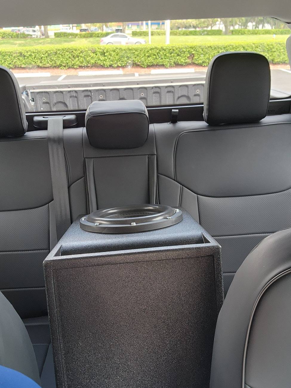

Changed out my cheap components and went with some genius 6.5 bullets, ds18 4 bullets, skar tweets, and a skar 800.1 on a skar ddx10. Eventually going to take back seat out and do bucket seats with a center console box. Kept the puzu dsp(it's awesome) and added an rca bass knob. Still need to install engine cover, wireless char
Ford Maverick Redid some audio and its clean sounding! 1000006341
Ford Maverick Redid some audio and its clean sounding! 1000006340
ger, black lugs, and led front strip.

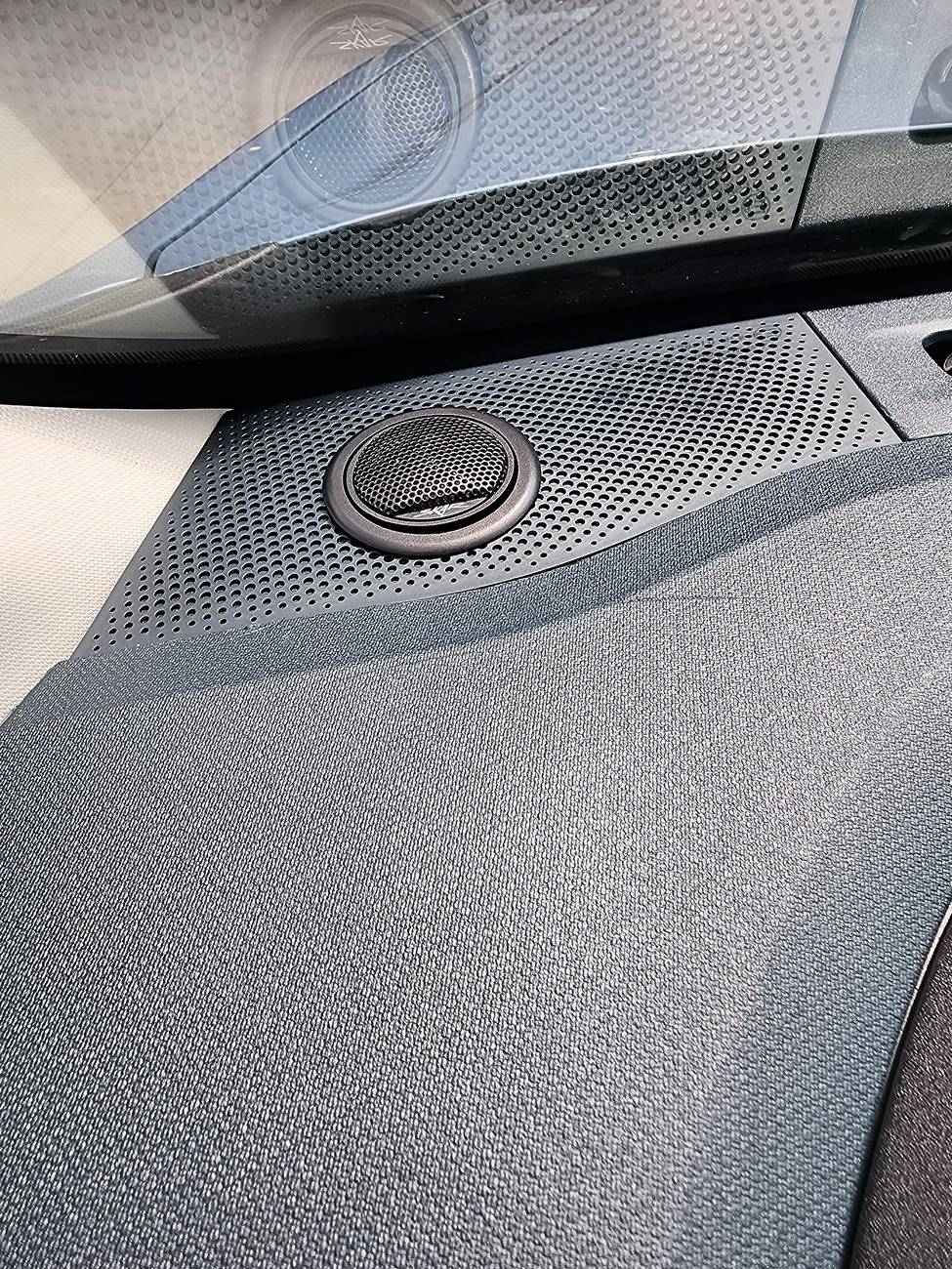

Choppy 78 could you tell us how you mounted the tweeters ? They look like there just sitting in a hole in that cover.What is the depth of these and could they go in the doors ? Thanks

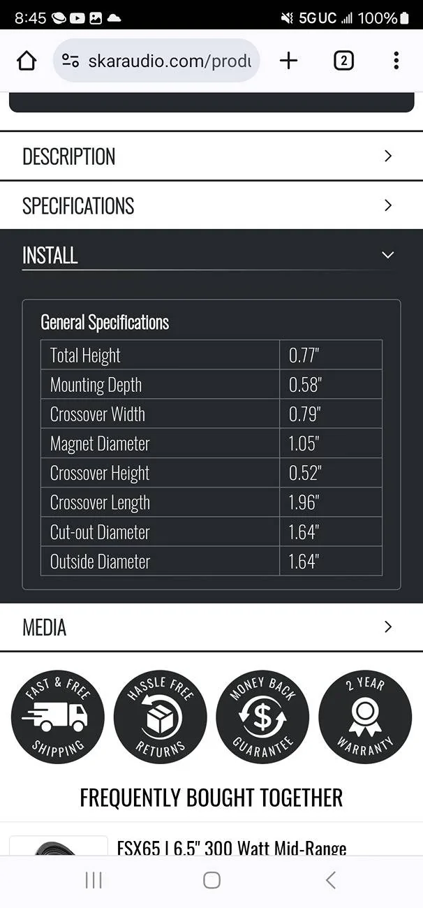

I dremeled out the 1.64 diameter and they are snug flush. I did cut out the factory clips to get this tweeter to fit flush. They do come with flush, angle, and raised mounts. So door would work.

How in the world did you get a dremel in there? When I did mine I used dikes to cut the height down of the plastic retainers so the factory trim piece would go back in.

Specifically I used a step bit to cut a big enough hole and then grinded with a dremel to my line. Came out nice I think

And I went old school and used a box cutter to cut out the plastic retainers.
