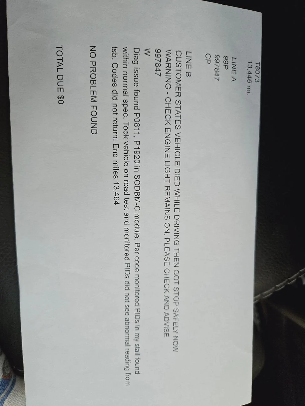

When stuff like this happens....
USUALLY
You can disconnect the 12 Volt battery for a few minutes, ( 5 min? 10 min?) and then reattach and drive away.
If the codes don't come back, can consider it a one time computer glitch. If the codes come back, see a dealer asap.
The Real Maverick
Jack
Jan 13, 2024
2,999
4,145
But... I see and sympathize with your predicament getting ready to cross a desert in July with 2 hours between towns. So I probably would have gotten a rental also.
All other times I would have done the battery reset and kept driving.
USUALLY
I have some miles under my belt and I have never had a "one time computer glitch" that would be a safety issue. Now I have my maverick which has been OK but the amount of electrical glitches you see on these is actually concerning.

Your dealer doesn't sound like they know very much. And may not know how to do a software update properly.. They may have done your updates without an external 12 volt power source connected to the truck during the updates. If not done, this may cause borked updates.

Tech Tye
Ken
Oct 10, 2023
213
184
Kentucky
2023 Maverick
Mine did that @ 16,000 miles. Locked up. I have a post on this under SHIFT SYS FAULT. Ended up being bad transmission and controller . Now it’s in the shop again @ 34,000 miles for same issue. This time it’s the 40pin plug at the front left of the truck. Pins are all corroded and missing. This was in July, won’t see a new wire harness till November.🤬. I brought the tech a large tube of dielectric grease to fill the 40 pin full when they get it. I run my truck thru the car wash every day, I’m think bad spot for the 40 pin
