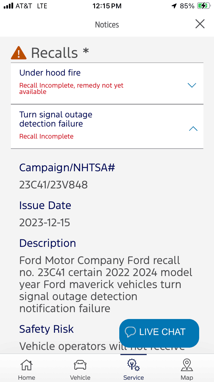

Dealership sent tech to house this morning for this recall, which I got a letter for and shows for my vin online and in the FordPass app (recalls now showing in the app, they didn’t before)
Tech was unable to complete it, not sure what is going on. Trying to find out
Ford Maverick Recall Notice 23C41/NHTSA 23V848 and Rapid Direction/Blinker Lights IMG_9860
