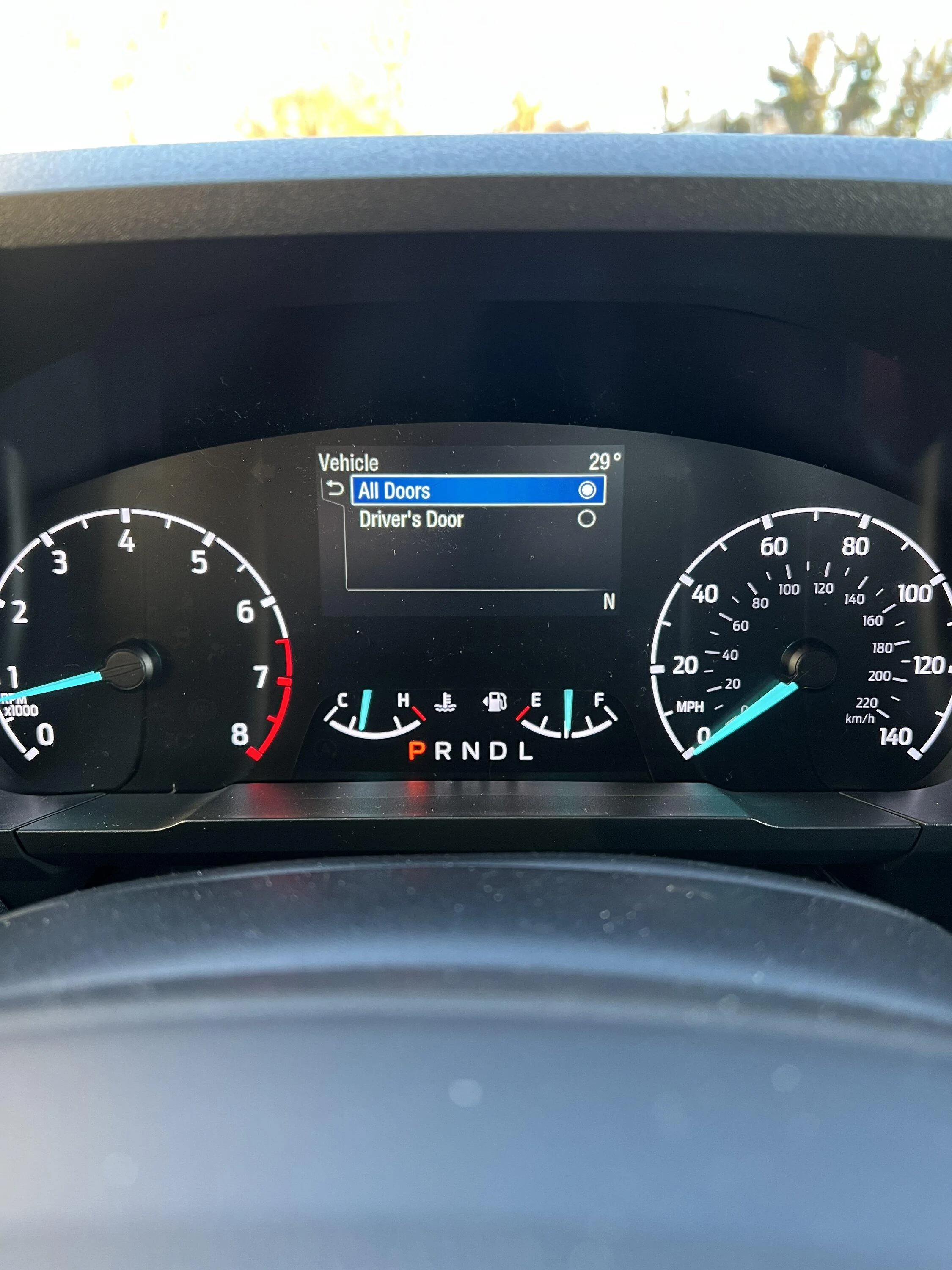

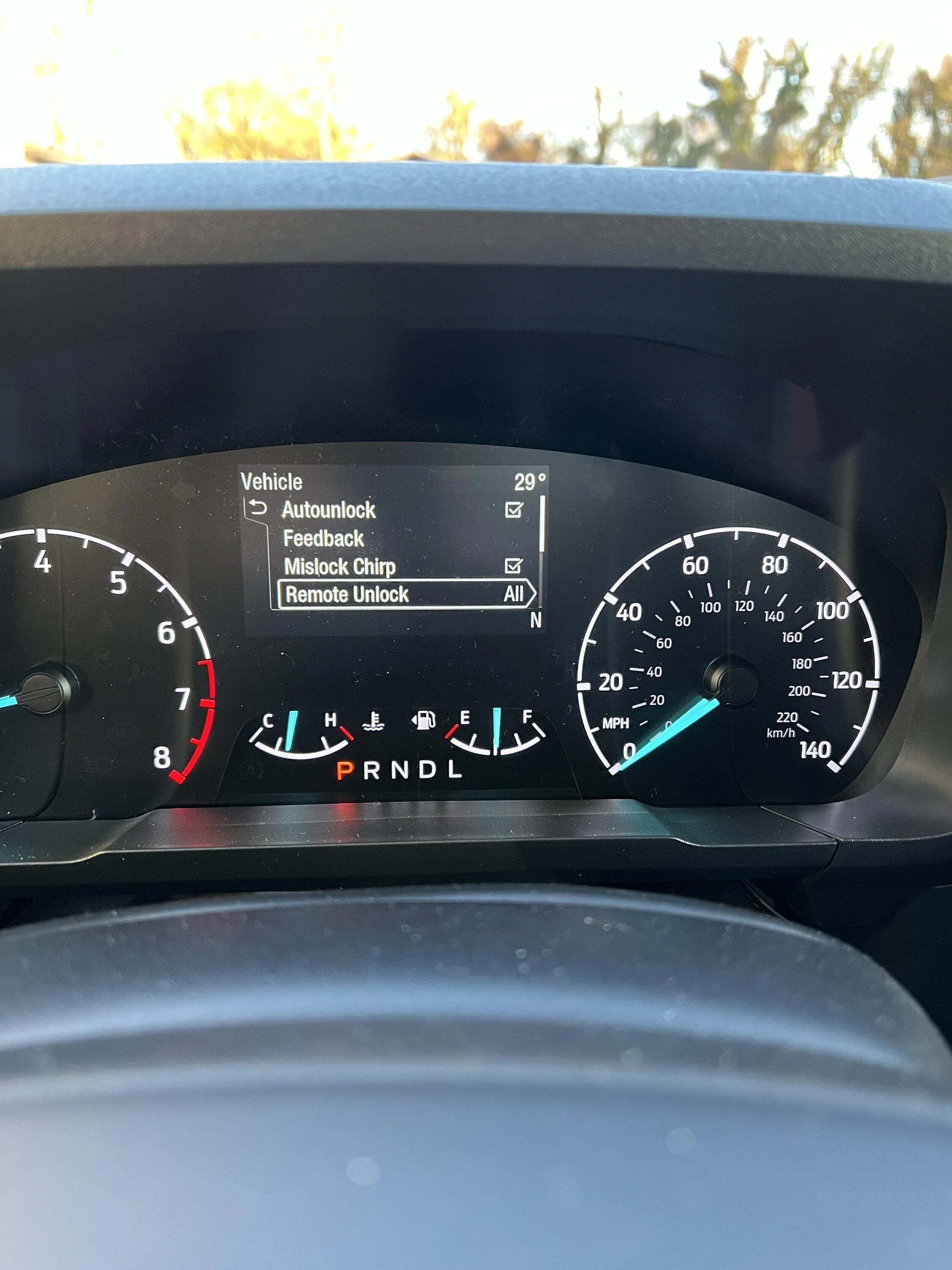

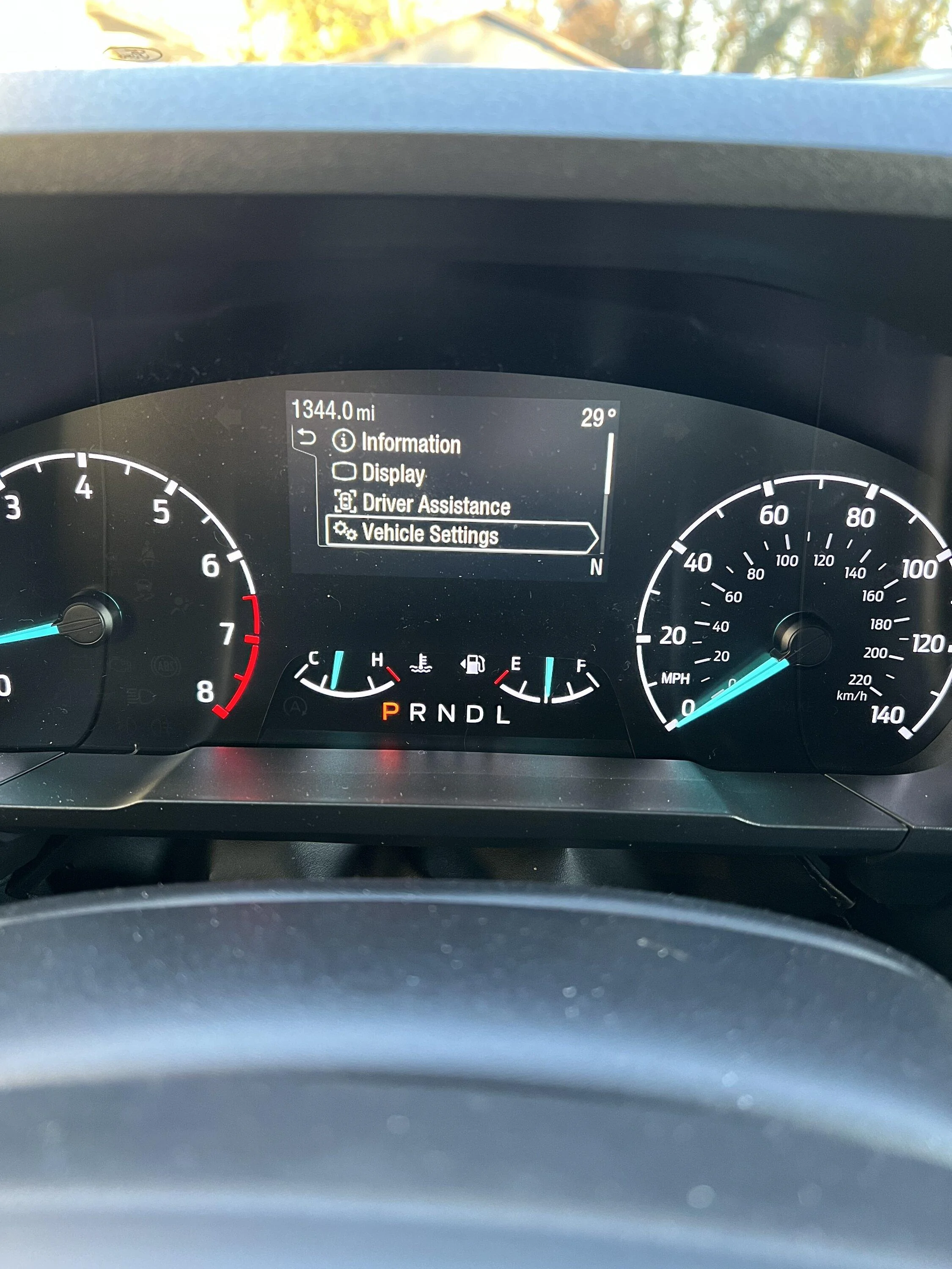

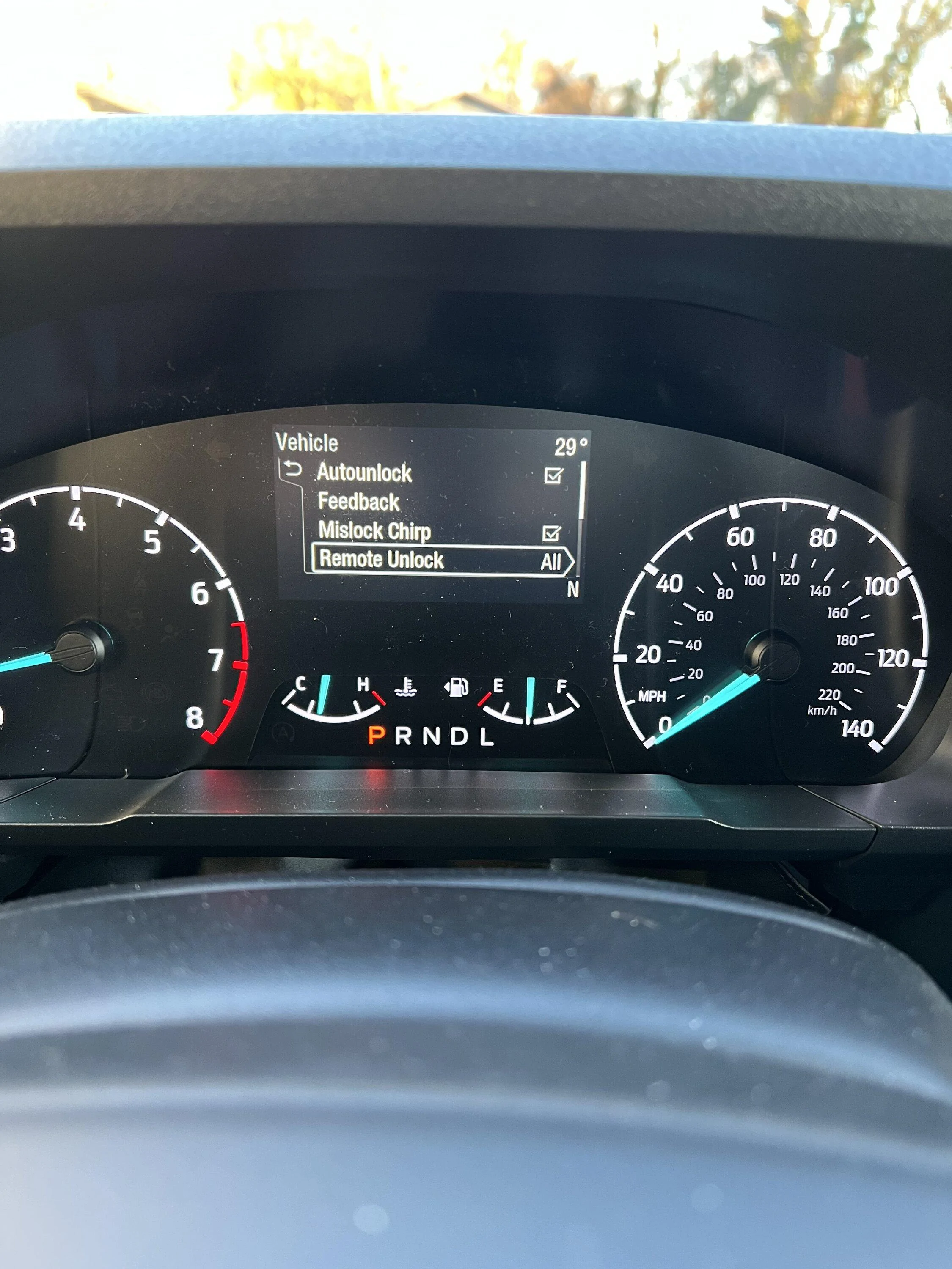

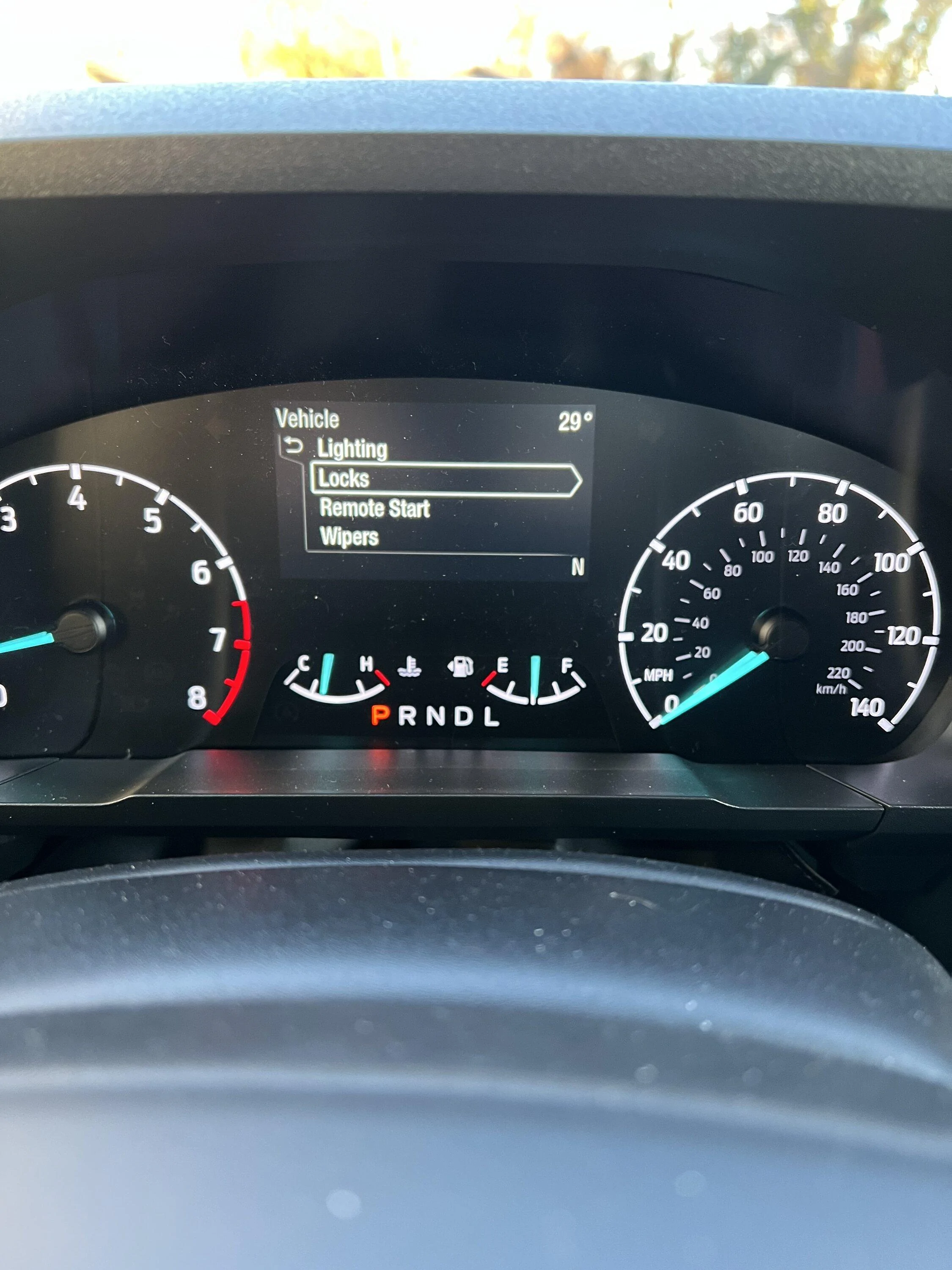

Here is what I did:
•Go to vehicle settings
•Locks
•Remote unlock
•select “All Doors”
The pictures got out of order when unattached them but you should be able to get the idea.
