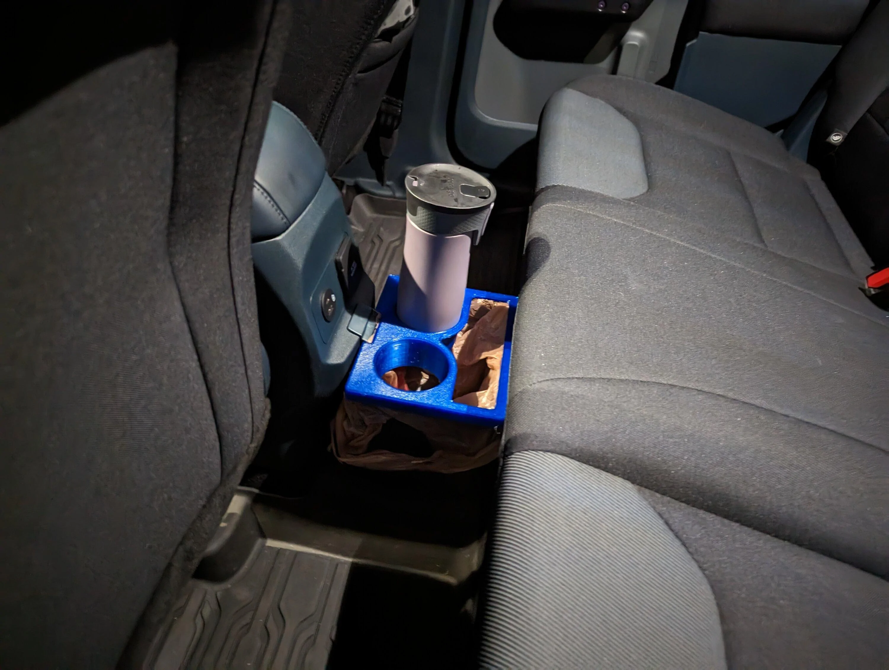

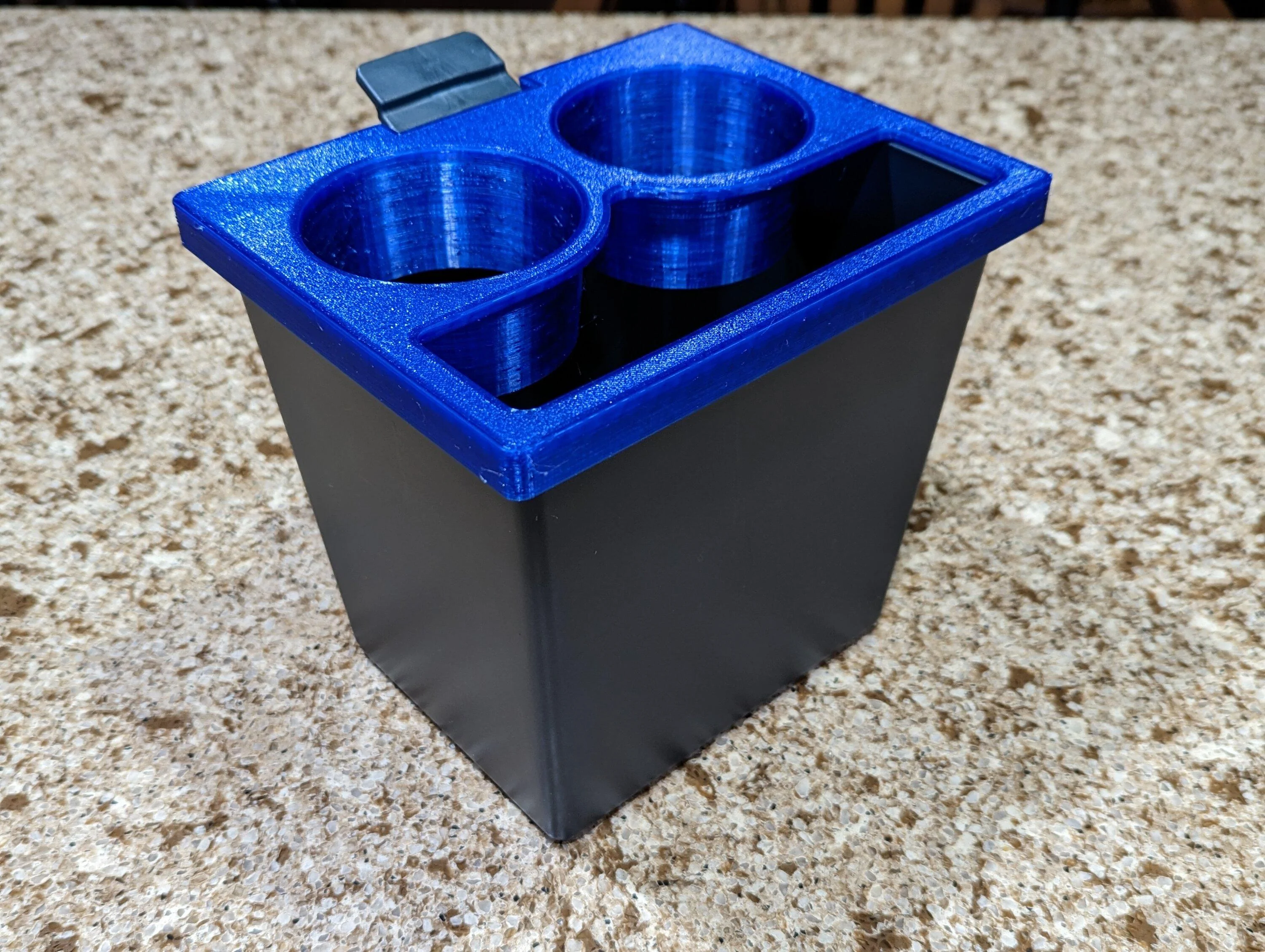

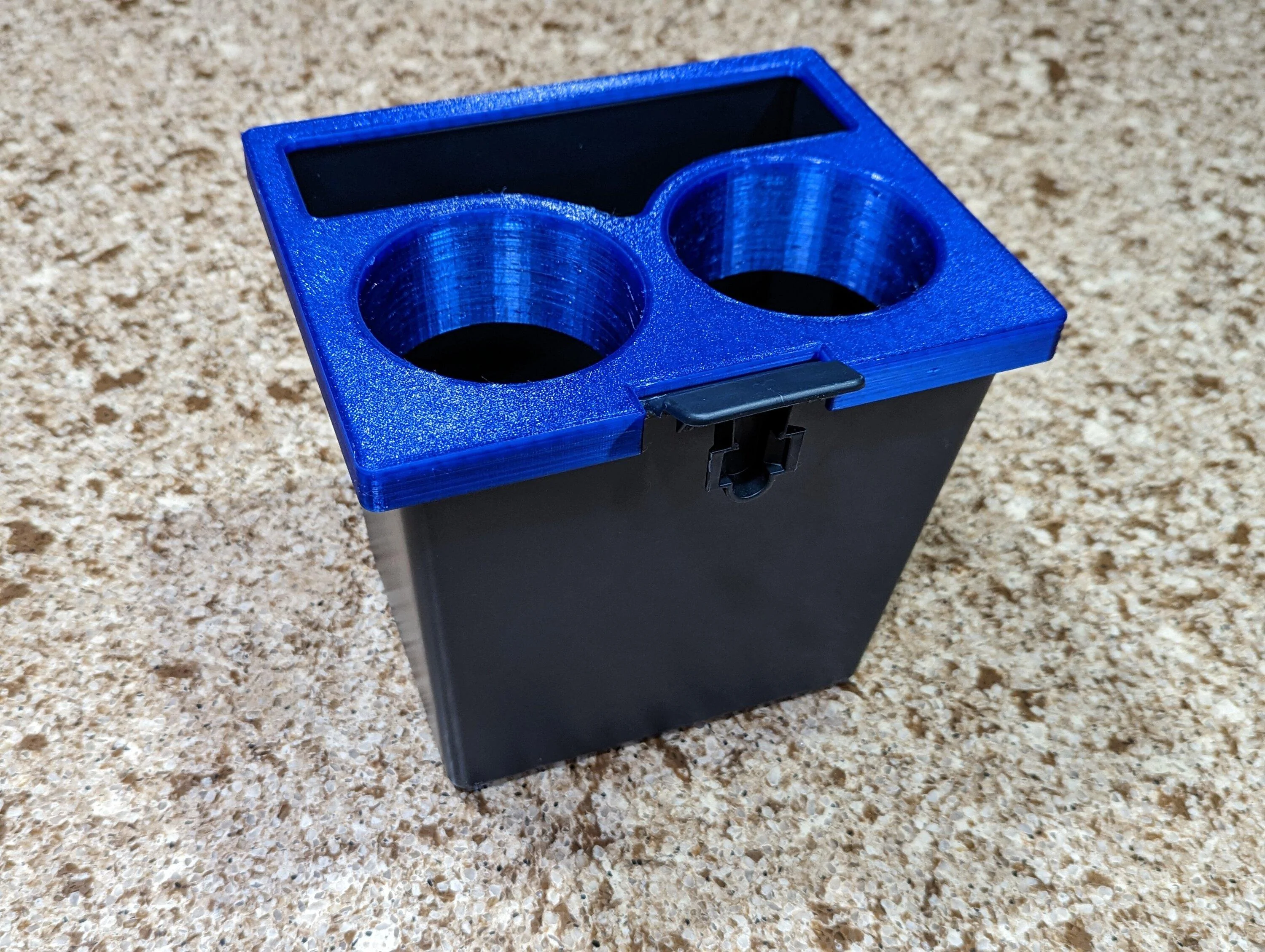

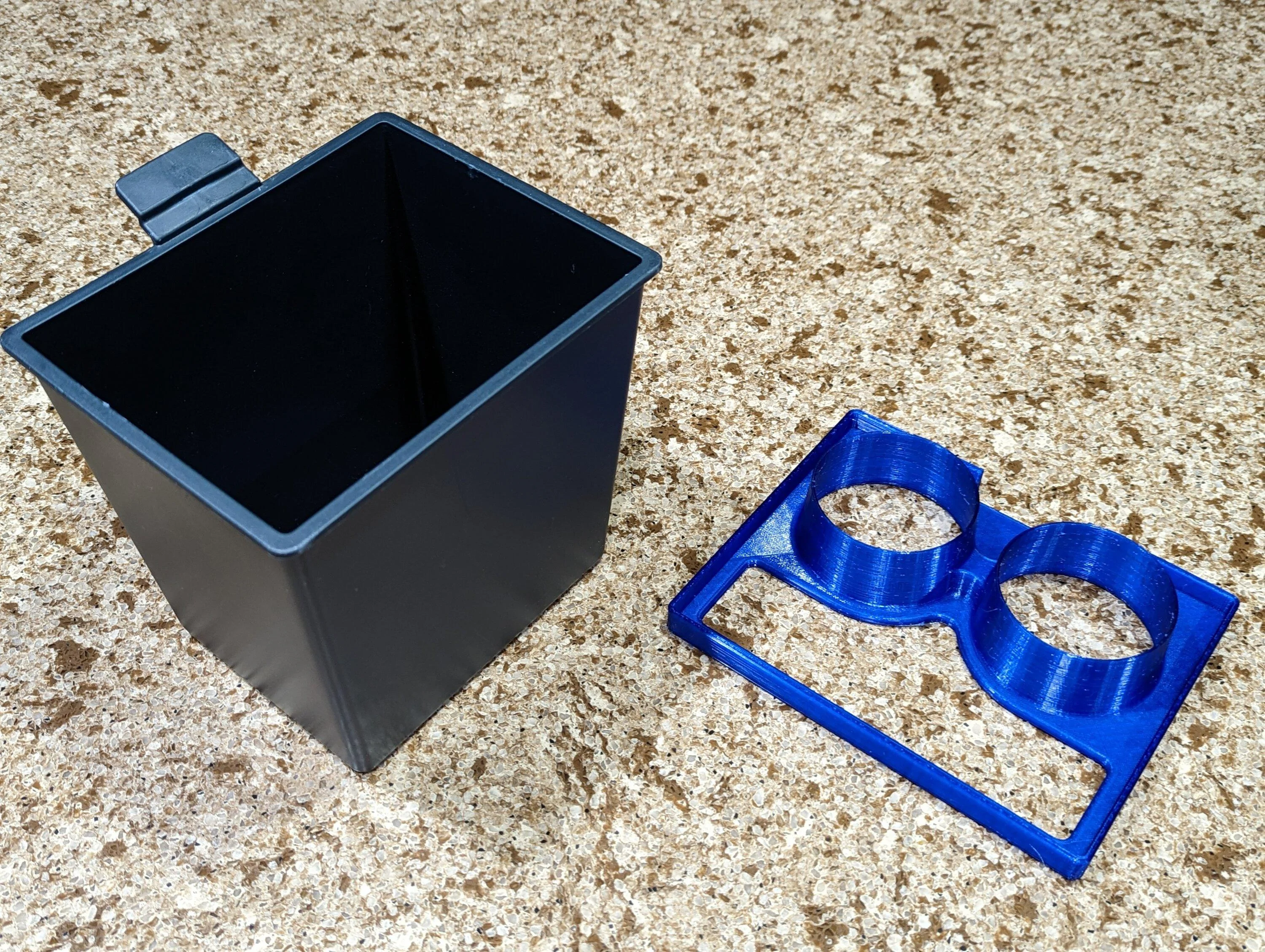

I have been wanting to use the trash bin from the Ford FITS package, but I needed the cup holder MORE since an XL does not have the middle armrest in the back seat.
So I designed a lid with cupholders that uses the FITS trash bin. I purposely designed it so that there was no bottom to the cup holders so it could be printed without supports.

11.5 hours with the z seam alignment set to Random. probably shave 30 mins off that if set to Shortest

I have the fits trash can and needed a drink holder since the XL does not have the flip down arm rest. I designed it for easy printing without supports, hence no "bottom" to the cup holders.
