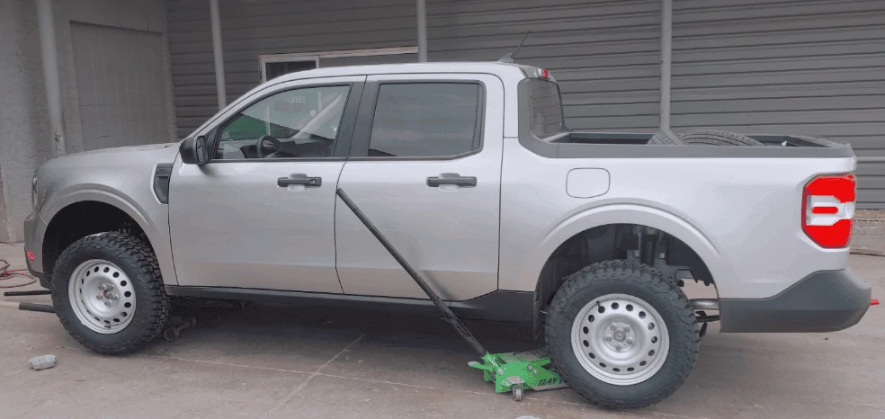

Uploaded the only photo I have of the truck, since people like pictures. Will upload another after I get more done. So far I've installed this stuff on my AWD EcoBoost:

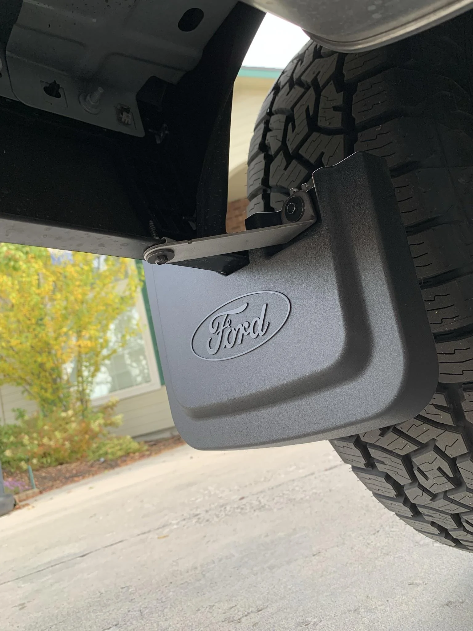

Drivers side rear:
Ford Maverick Rear OEM Mudflaps install instructions? 5064D7F5-0B92-4AAB-8BB1-86CF665307F3

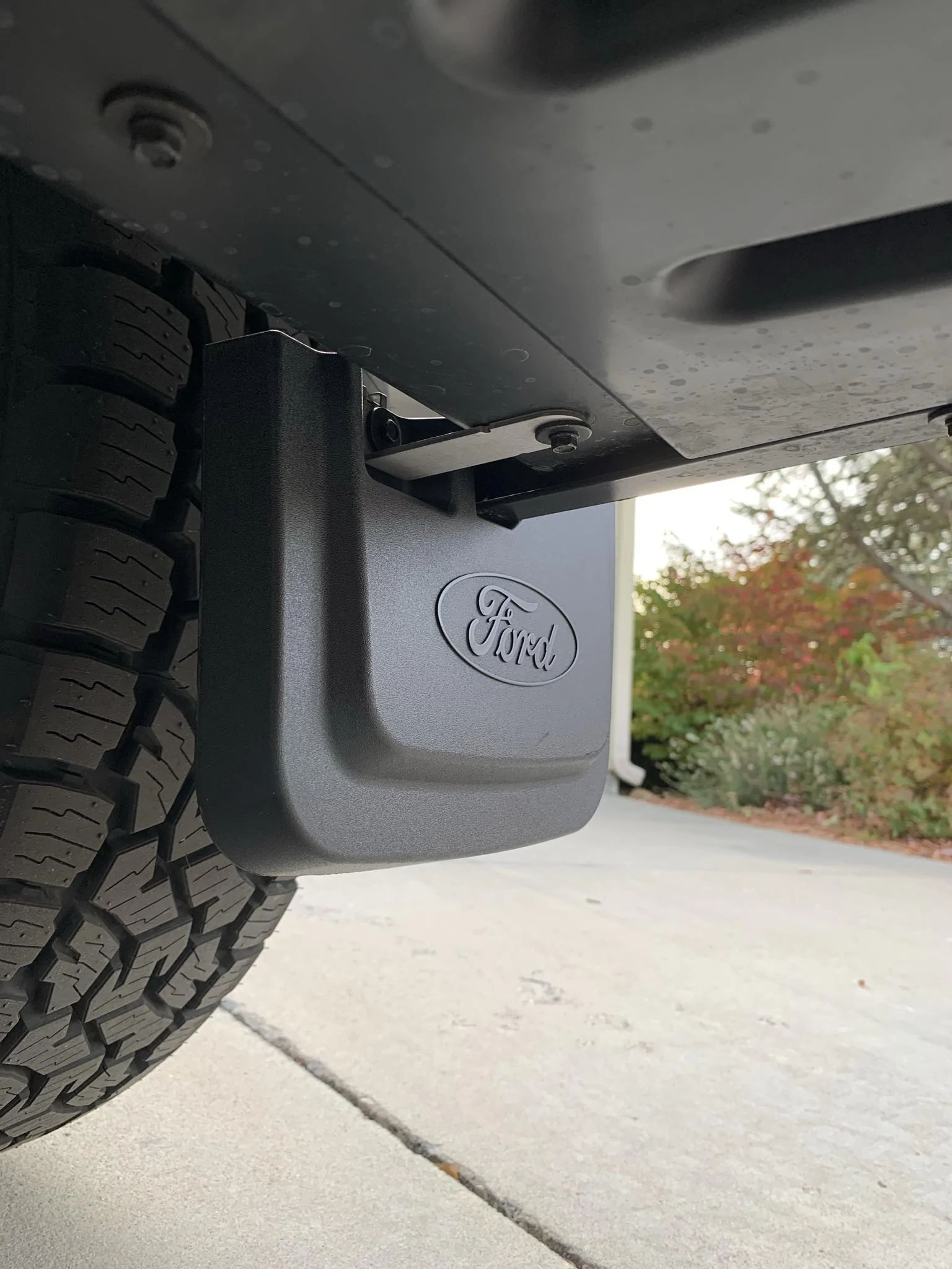

Drivers side is the one you have to tap a 7mm hole in the black plastic for. Passenger rear bar uses existing holes

And you don’t even need a drill. I used a sharp awl and poked through the plastic for the driver side hole. Don’t over-tighten the bolts either. You’ll squash the plastic.

Loving the truck so far. No plans for a lift - enjoy the stock height with the Baja Bosses. Making the truck into sort of a hot rodded rendition of a present day Subaru Brat or Baja.
Can you post a picture of those seat covers?
