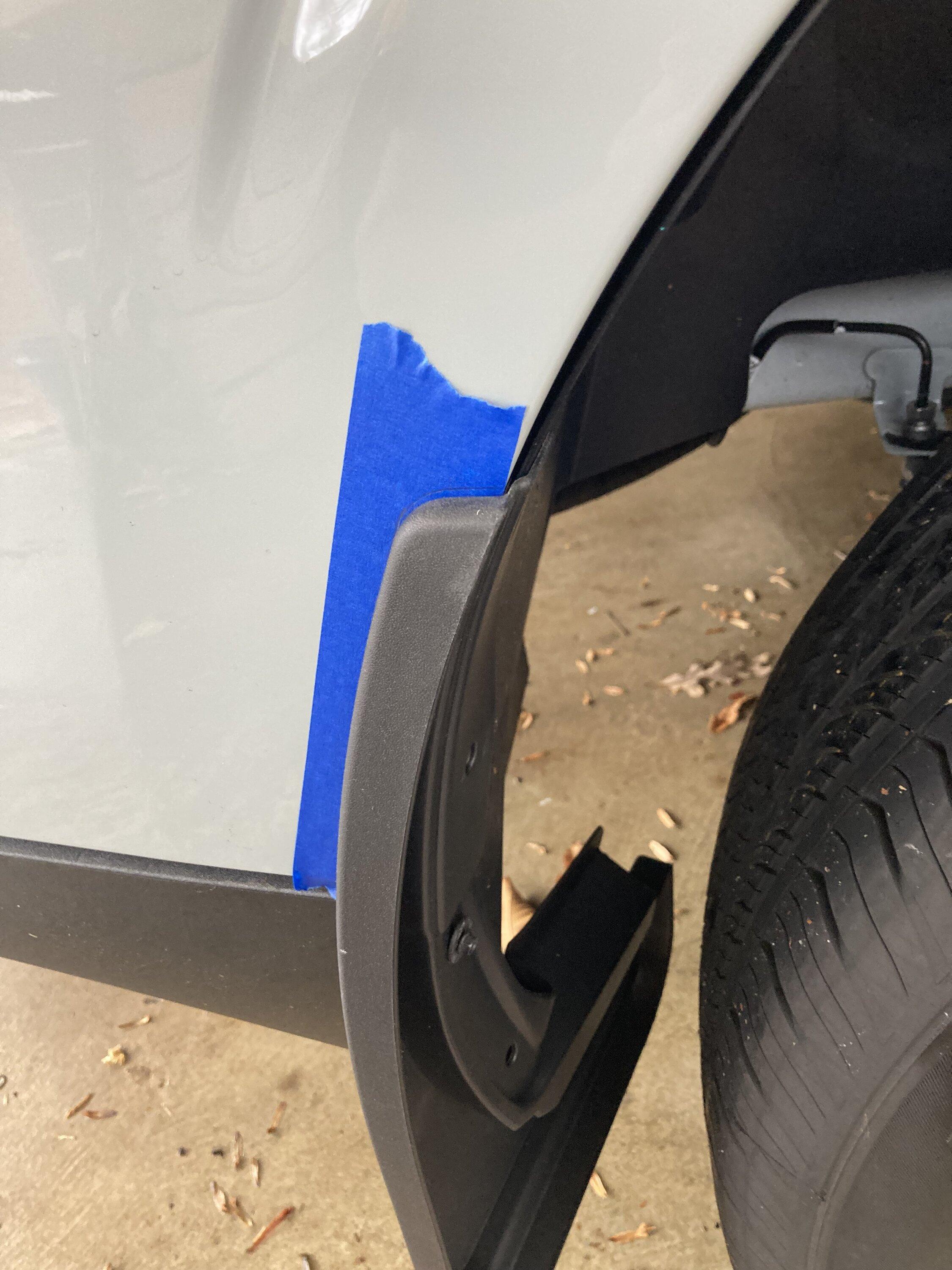

On Sunday I installed the mudflaps. I wanted to share my method on how I installed the film, since I hadn’t seen it on here when I was looking on this forum. Hope it may help someone. Sorry I only took one picture during installation but you should get the idea.
1 Remove pushpins/bolts.
2 Hold mudflap in place and eyeball where plastic comes in contact with paint.
3 Remove mudflap and put painters tape on paint in this area make sure to go at least an inch higher and a bit wider of the non mudflap portion covered.
4 Insert one pin and push/hold mudflap in place firmly and trace contour on tape.
5 Remove mudflap and peel back tape starting at bottom and cut out contour with scissors as you are peeling upward. Make sure after you cut to keep the non-cutout portion on vehicle’s paint, leaving the extra tape on top helps with this. Once I got near the bottom of the top radius I pressed the tape back on the fender then finished the cut starting at the wheel well and cut rearward.
5 Place cut out tape on film and cut out film (make sure you place painters tape on the topside of film), remove painters tape from top of film
6 Remaining painters tape will still be on vehicle, so you can align film accurately.
7 Affix film, remove tape from fender, position and pin/bolt mudflap in place.
Note that the included film is too narrow to cover entire width. You can either buy wider film, patch a second piece in, or what I did was just do the outside. Since on mine that is where the plastic was touching the paint, particularly the upper rear portion.

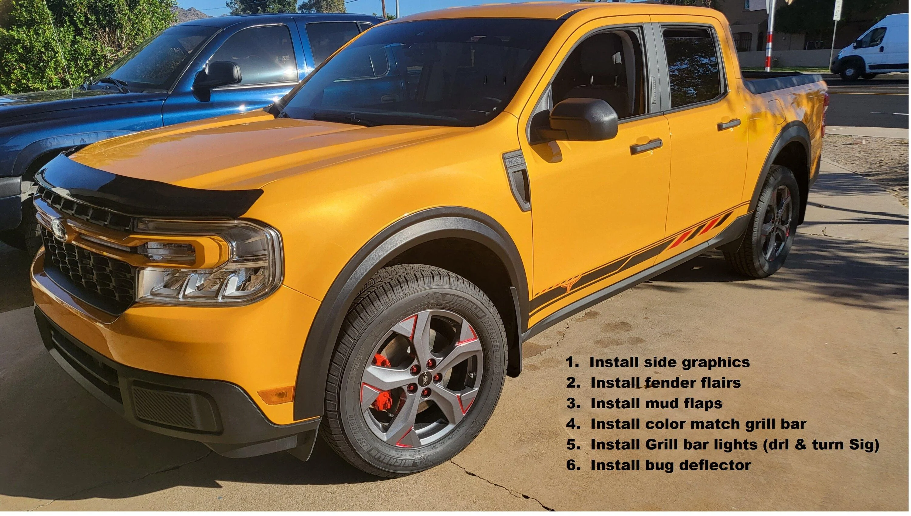

Nice Job, I pretty much did the same thing on Blue EB. The cyber orange had the mud flaps on top of the fender flairs. So no paint protection tape was needed.
https://www.mavericktruckclub.com/f...ud-flaps-budget-bed-mat-other-upgrades.32650/

A picture of the tape would help if anyone has one. The tape is about 2 feet long, but it looks like you only need a foot of it. I do not see any need to cut the tape except maybe at the top where the flap is angled.
Lambretta
Jul 12, 2023
62
Maryland
24 Ford Maverick XL
Yes you only need about half of each piece to do outside, you can use the scraps to do the inside if you do them side by side. You could just cut of an angle on top and bottom, but either it will not cover all the paint or have a straight line of ppf showing (however not too visible)…all depends on what you want to do.
