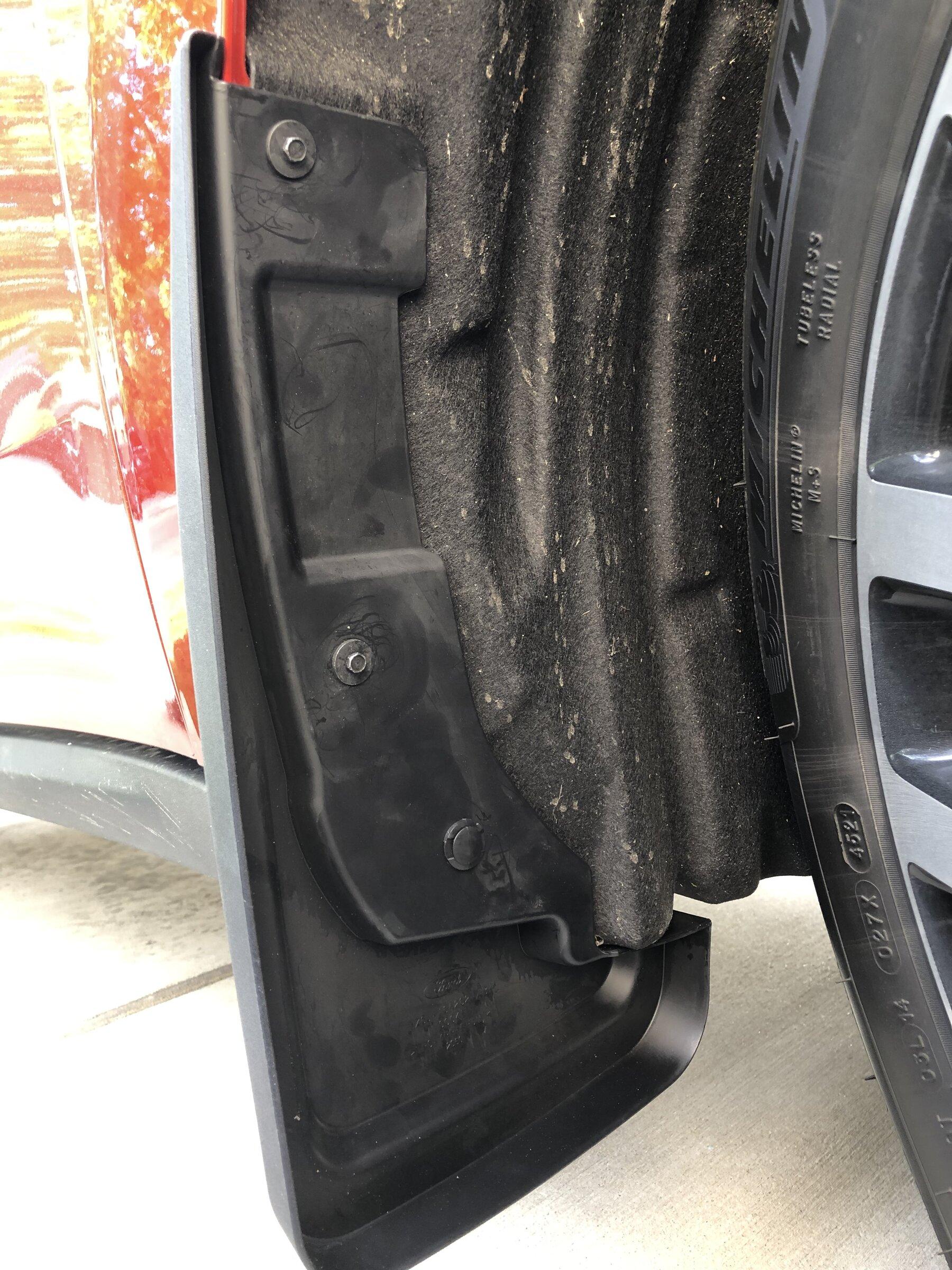

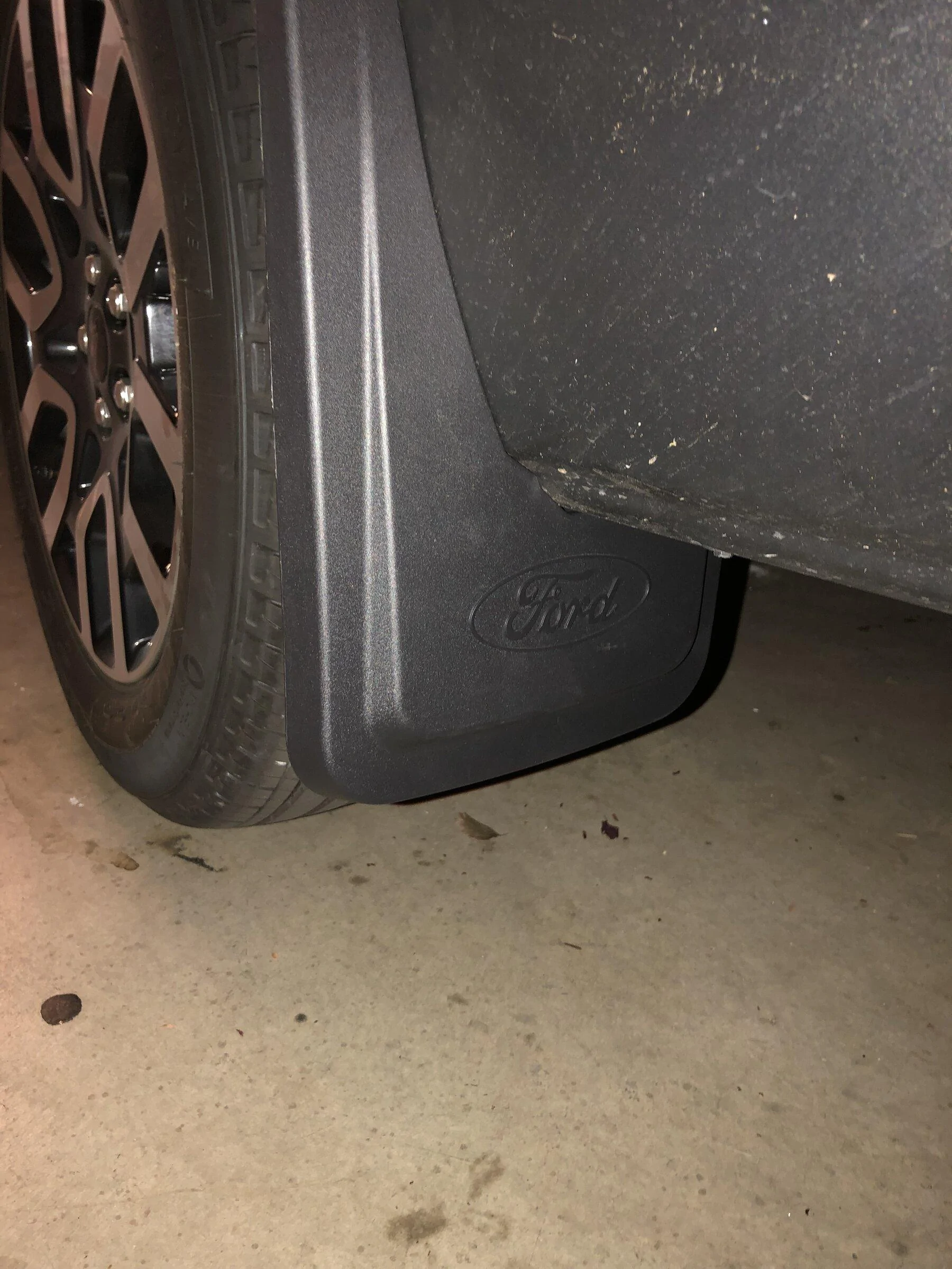

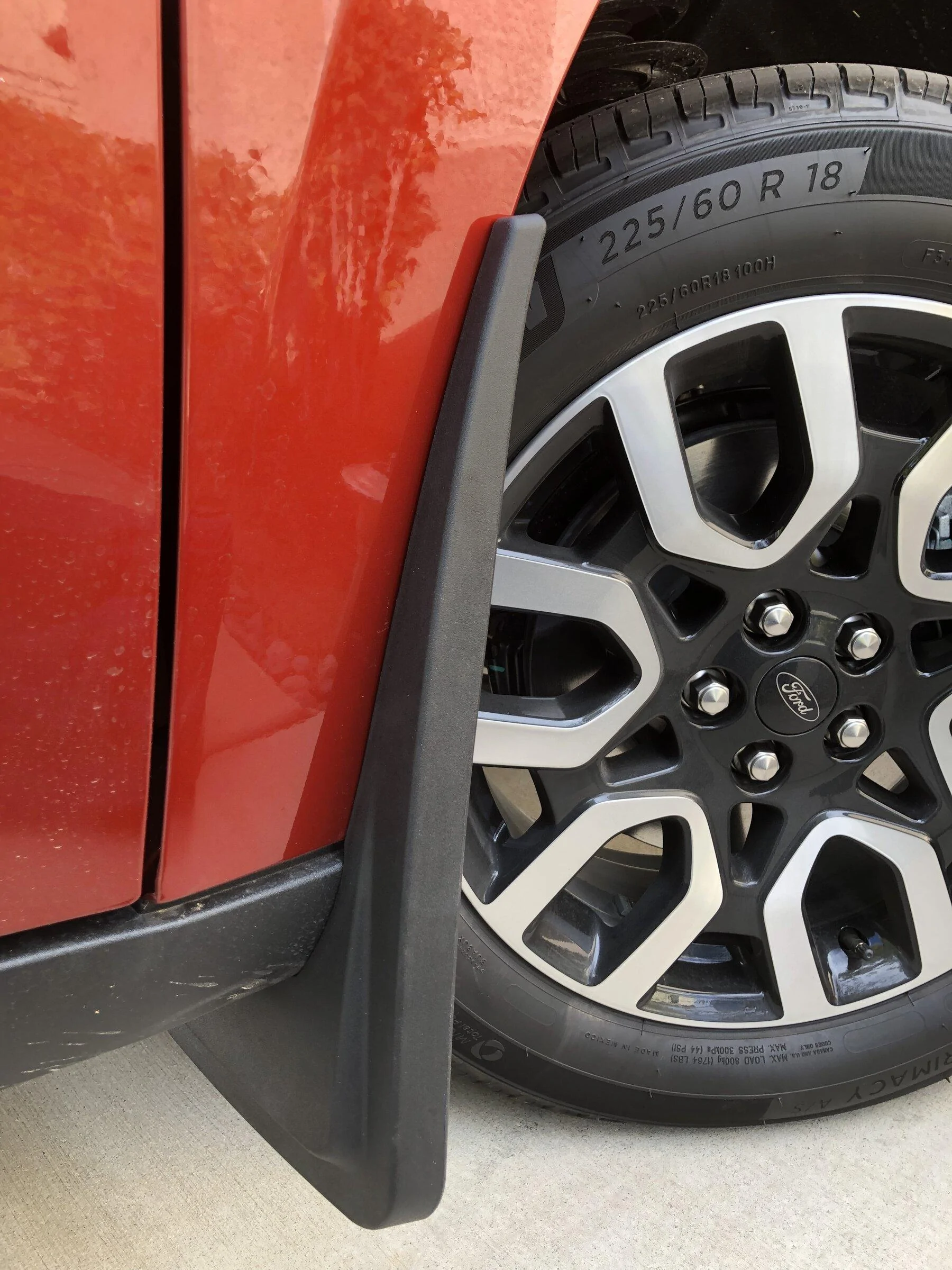

I ordered OEM mud flap kit for my Lariat. Just installed the front two today. It only took about ten minutes. The key to the push pins removal is to pop out/up the center first, then the rest of the push pin pulls right out.
Rear flaps are next…

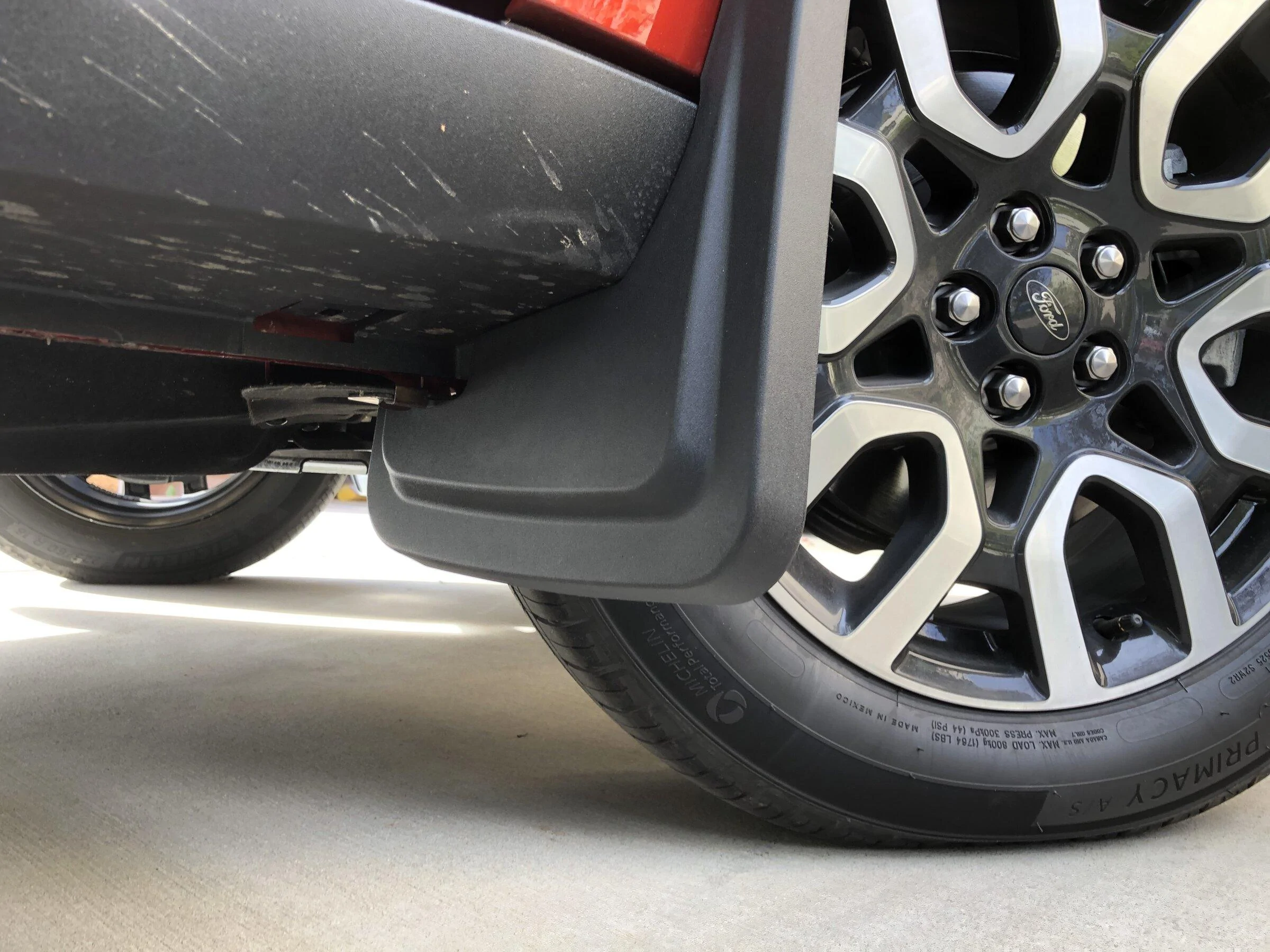

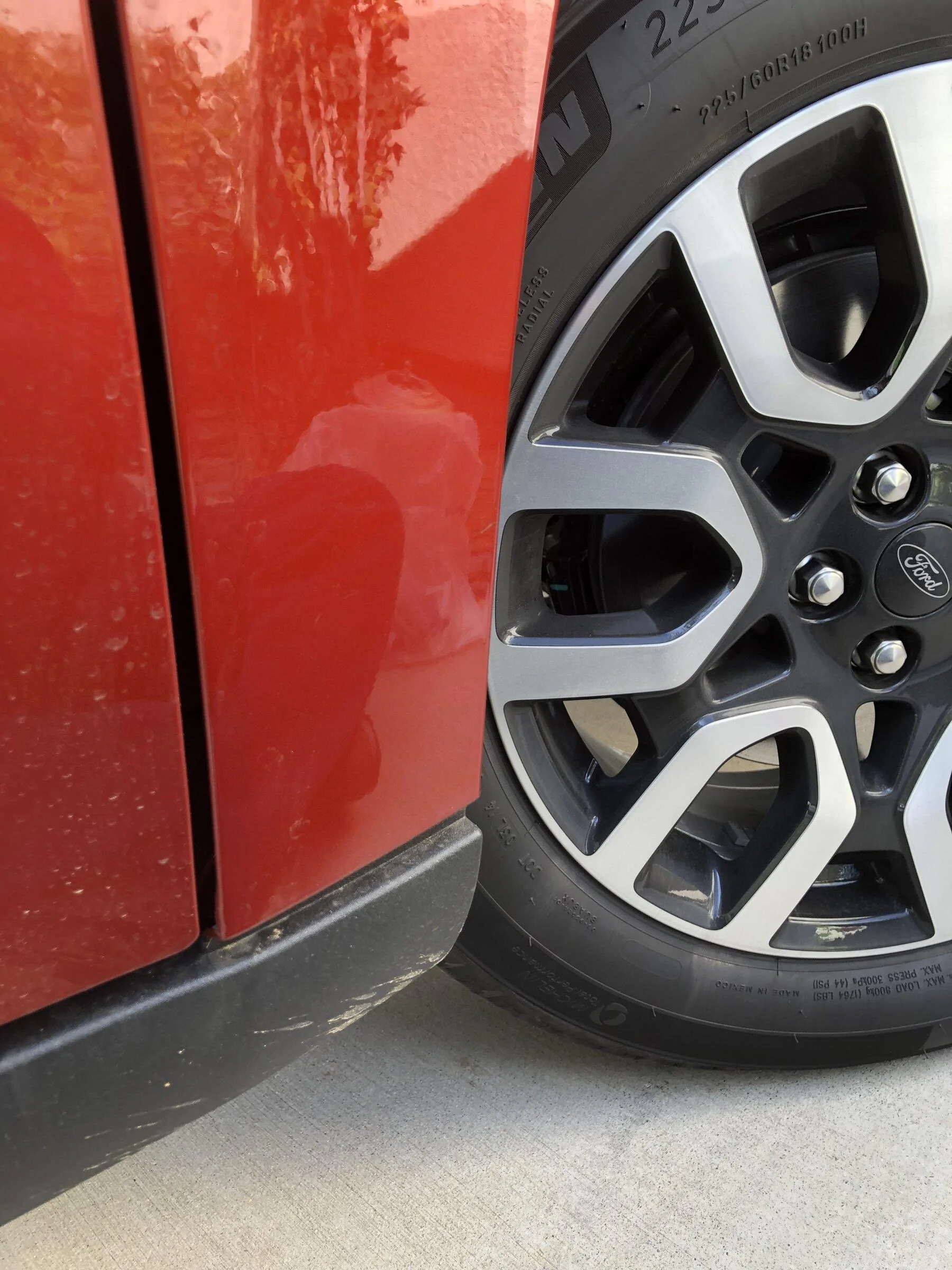

Here’s the follow up with the rear oem mud flaps installed

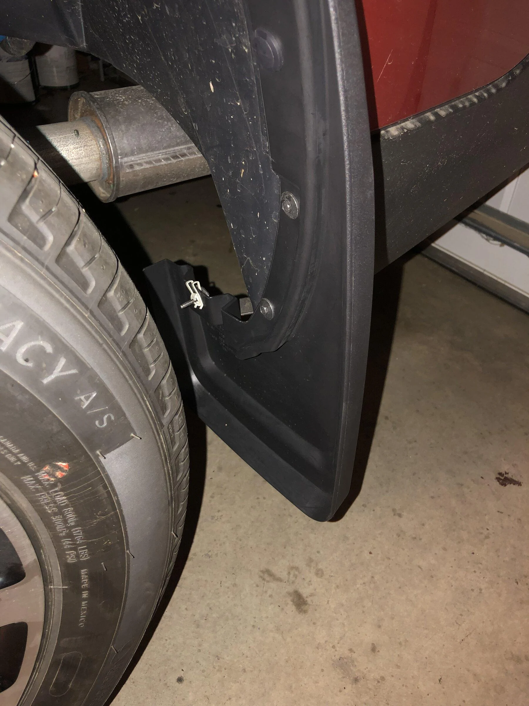

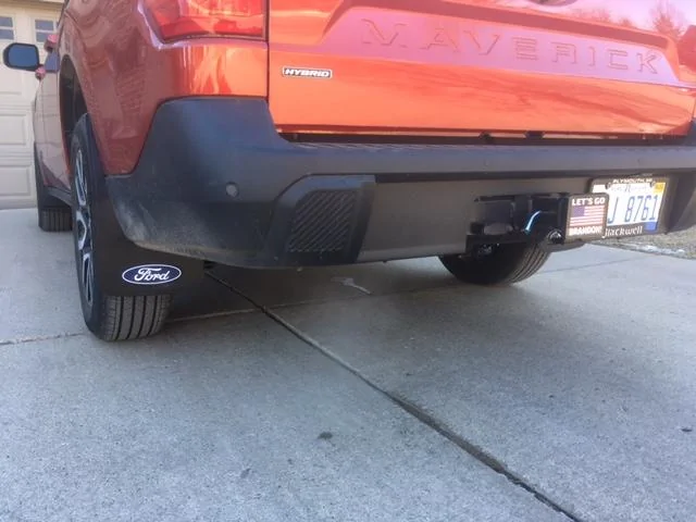

I put the OEM flaps on the front, but on the rear I used the plasticolor blue oval flaps from Amazon at $24.99. They provide more coverage, and I liked the blue oval logo........

You have to drill the 4 mounting holes, and buy the tinnerman nut plates, screws, and fender washers, plus the longer screws to go in the bottom holes. But they are easy to find at Ace Hardware or Home Depot.
