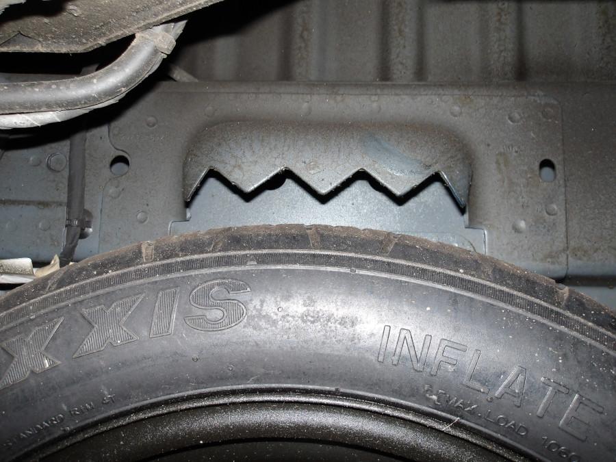

The serrated blade designed directs the directed stream to push the tire towards the rear bumper mainly to keep the tire out of the rear seat area. With the bed already traveling up in this case the additional air pressure would although relatively small would add to the rising of the bed. This wreck is a vote to be sure the spare is fully inflated at all times and is a biggie reason those removing the serrations to get a larger tire under their truck need to NOT bend or cut the rupture teeth away.
Do we actually know anything about this Maverick truck? Were the serrations in place or were they taken out?

Well, I decided to take a look at that design feature.
Because of the angle of the 'teeth' it looks to me like it's more designed to keep the tire in place vertically and horizontally by preventing it from angling up or down. I'm suggesting this because if they wanted the tire to rupture, then they'd have done better to place one sharp cutting blade pointed at the tire instead of the design in this image. So, the spare (If inflated) provides a bit of protection / buffer if the vehicle is hit from behind but the main purpose would probably not be intended to puncture the tire. Just my opinion.
