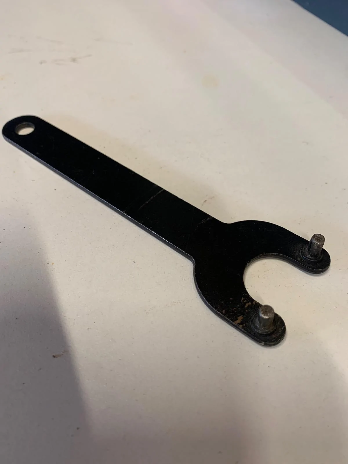

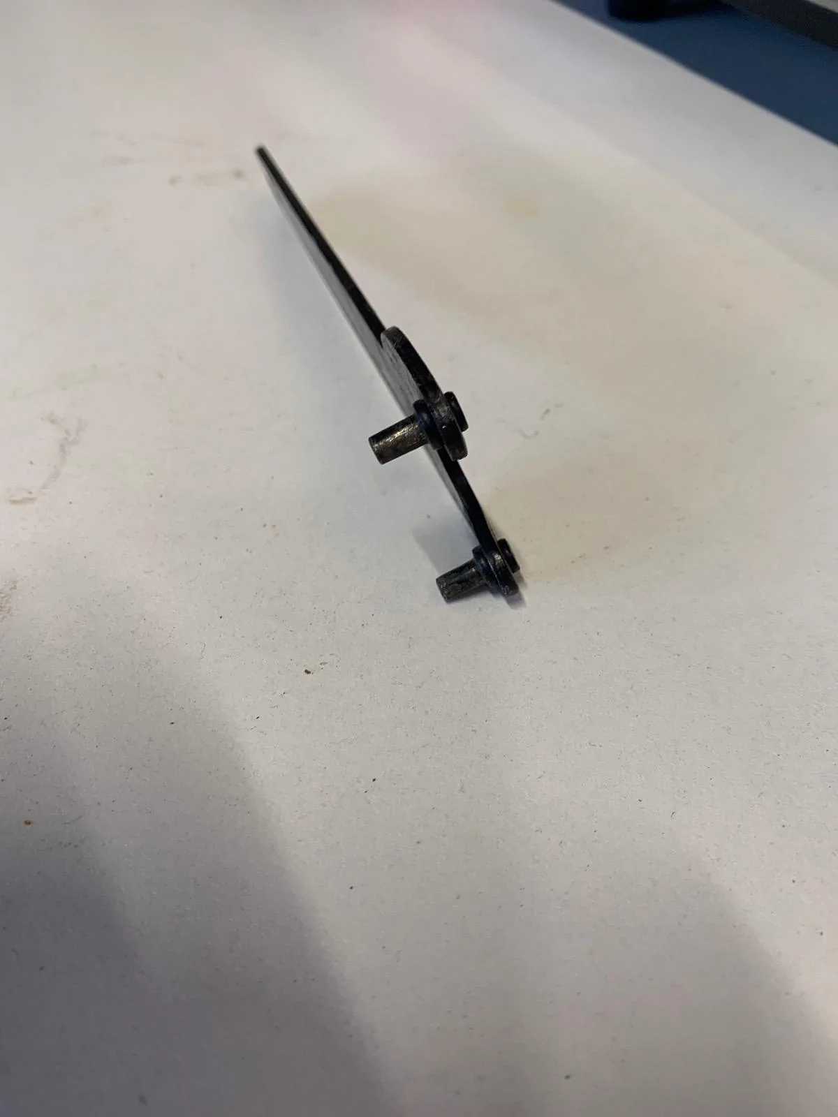

Setting Brake Maintenance Mode is NOT Required to change the pads and rotors on 2022 EB. Did mine today and used the cutting wheel wrench from my 4 1/2” mini grinder, to wind in and push the piston back.
I don't suppose you took any pix of your hack?
