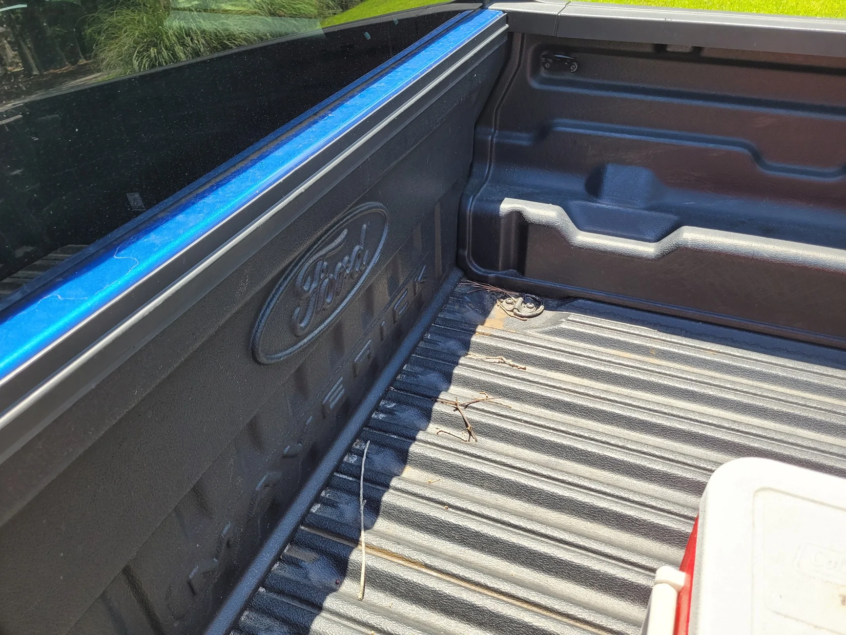

hey guys, new here. I bought a 2024 maverick a month ago and it has what I believe to be the factory plastic bed liner. it does say ford on it so I can only assume factory unless some aftermarket company paid for the licensing??
Ford Maverick question on bed drains with factory bed liner and tonneau cover? 20260528_161717
anyway. I bought a retractable tonneau cover for the bed off ebay. this specific one:
https://www.ebay.com/itm/365950188294
after looking at their "video" on the listing it shows them popping some plugs out of the bed cover to run the drains. I see no such drains anywhere in my bed liner.
Ford Maverick question on bed drains with factory bed liner and tonneau cover? 20260701_142657
I looked online and found a reddit post that I "think" shows me where they are? here:
so it appears I need to manually drill holes in the bed liner after I take off the sides and pop the factory drain hole plugs out?
my main question is how do I get the sides off? to I just pull the strap points off and the side will just sorta slip out or something?

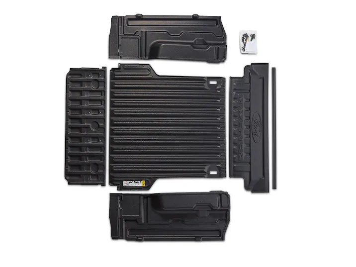

The OEM bedliner is installed in pieces. I would just remove it and do what you need to do and reinstall. I have the OEM spray in liner.

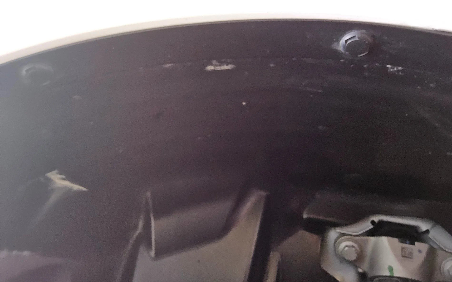

Here is a picture of where the drain plugs are. Tomorrow I will get a measurement if I remember, what was I saying 🤣
Ford Maverick question on bed drains with factory bed liner and tonneau cover? KIMG3310
If you zoom in you can see the drain hose in the plug. I would remove your drop in as suggested and measure the hole location and drill just a large enough for the hose. I will warn you there is going to be water getting in the bed unless you do a thorough seal of the bulkhead. Here is my thread on doing it with a lick to the video from @Realtruck .
