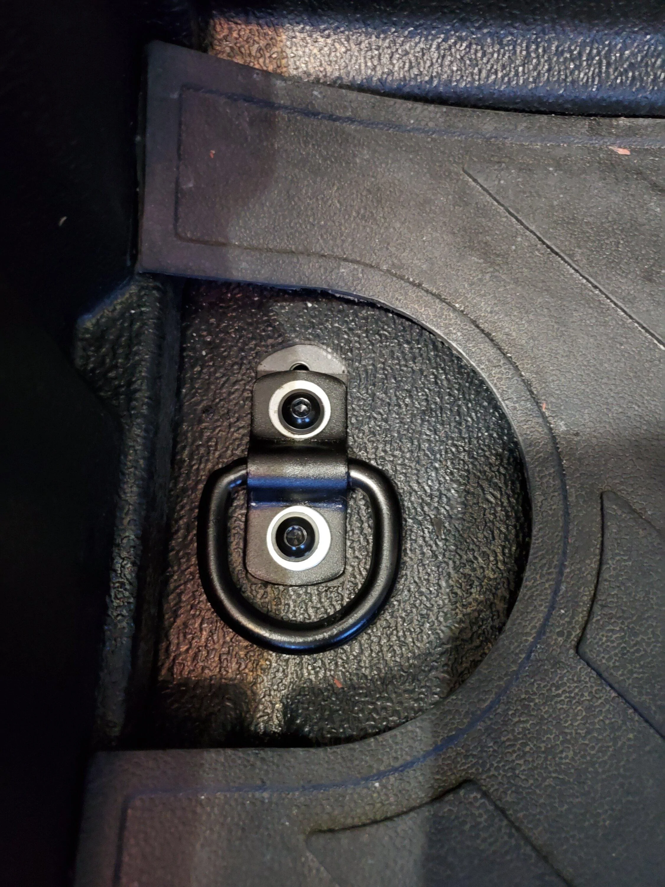

So I tapped the holes with no issue. I went ahead and temporarily installed the beefy tie downs so I could complete this thread. The reason it is just a temp install is that I need to razor knife some of the bed liner away so the tie downs will sit flush and I also need some stainless steel washers. Again given the height buildup from the drop in bed liner and the bed mat these tie downs lay flush.
Nice!
I would be careful about how you tie stuff down- and look at the owner manual- remember that the bed is part of the "unibody" and manual specifically says something about not tying heavy stuff straight across as it could damage the bed- to go diagonal.
