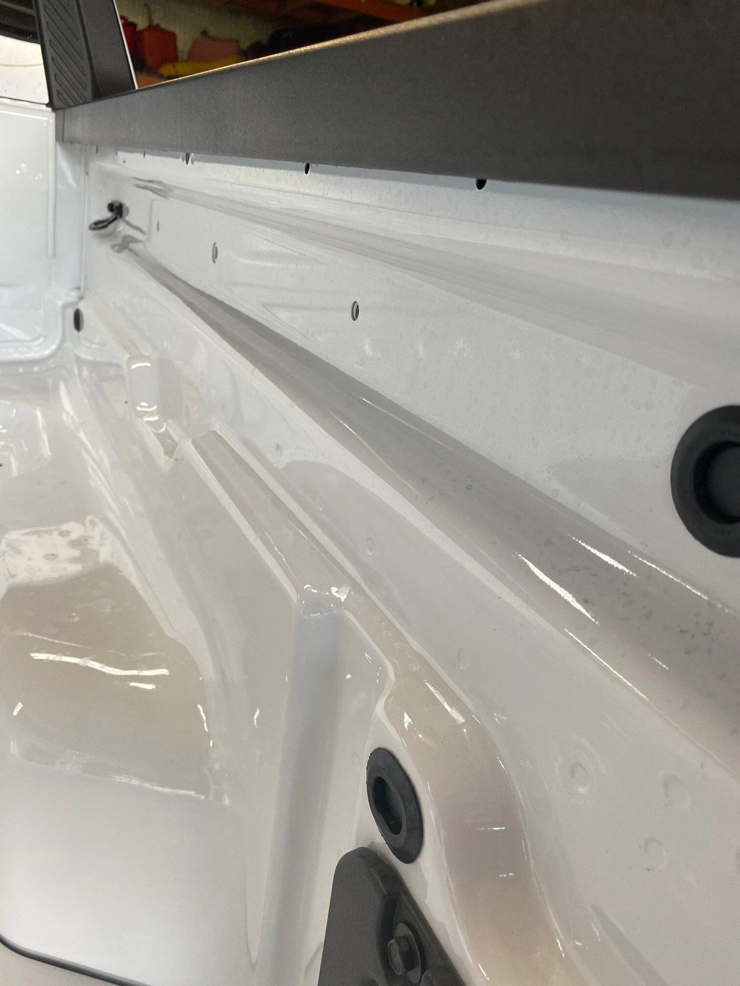

This 2024 Maverick XL has these threaded holes on the insides of the bed. I could use this as tie downs. Does anyone know what diameter and thread pitch these are ? I'd like to put some eye bolts here.
Thanks
Charlie

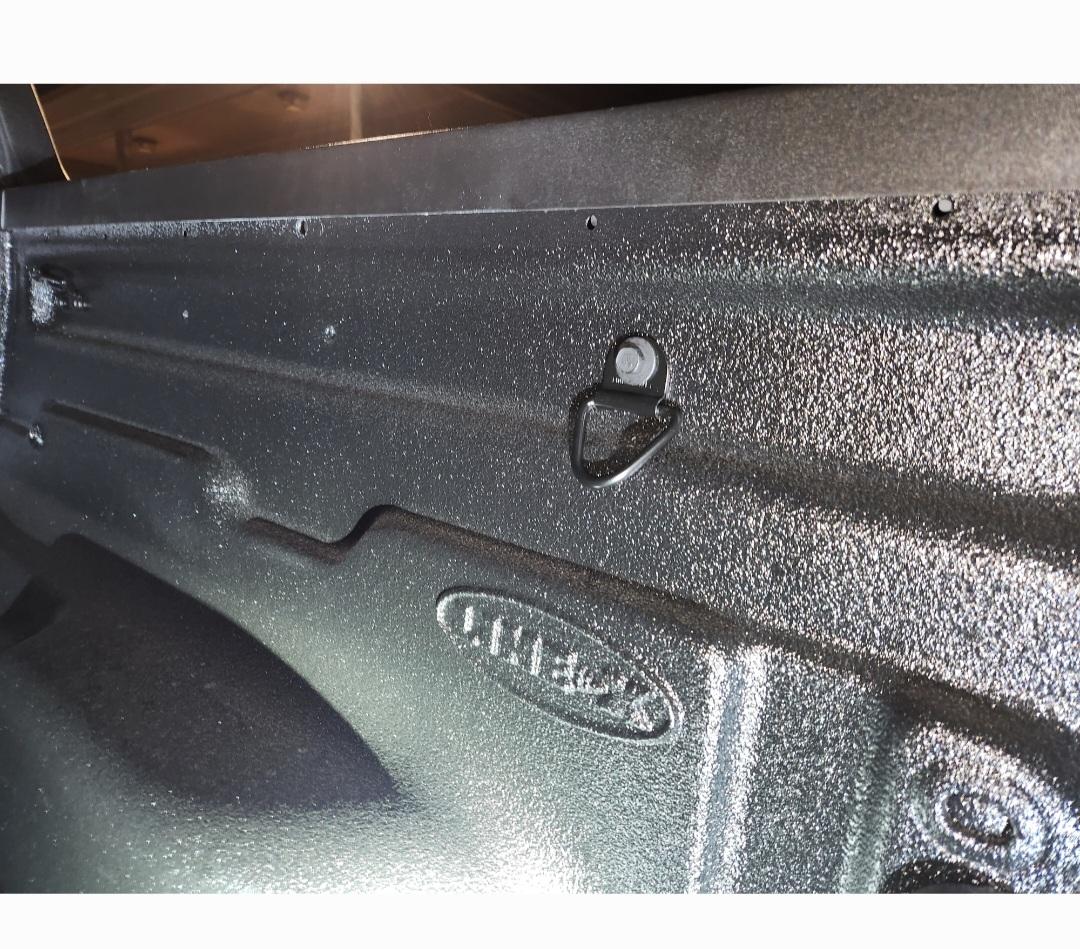

M8x1.25 I believe.
I bought 8 d-rings on Amazon and attached those with those bolts for my extra tie-downs. I love it.

Bolt size is correct. I got my bolts from an auto parts store. D rings are a Toyota part off of Amazon. I would not use a ratchet strap on the D rings. I am fairly certain the side wall would deform if you pulled a ratchet strap too tight.
