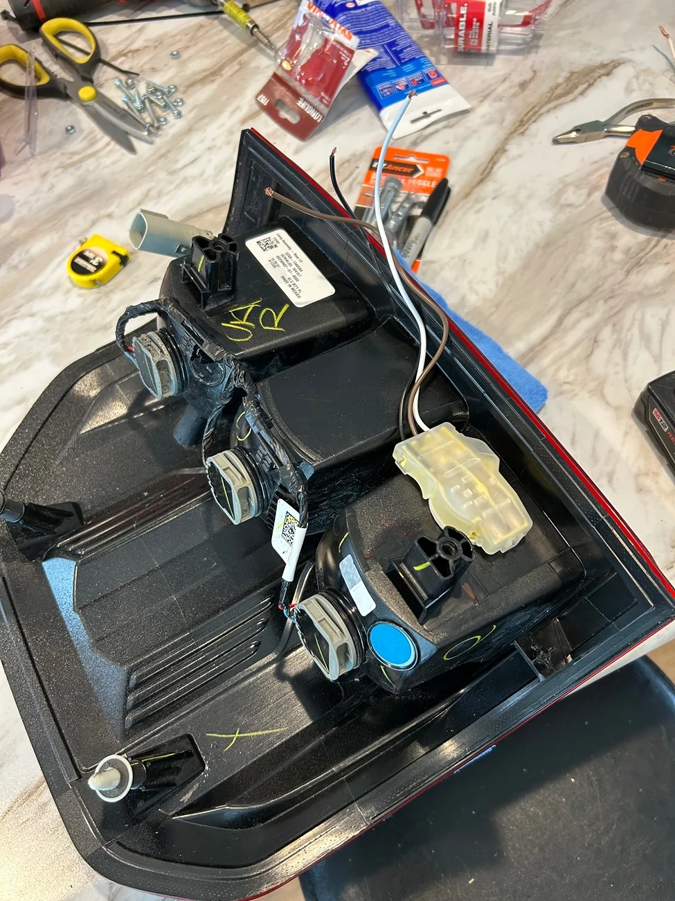

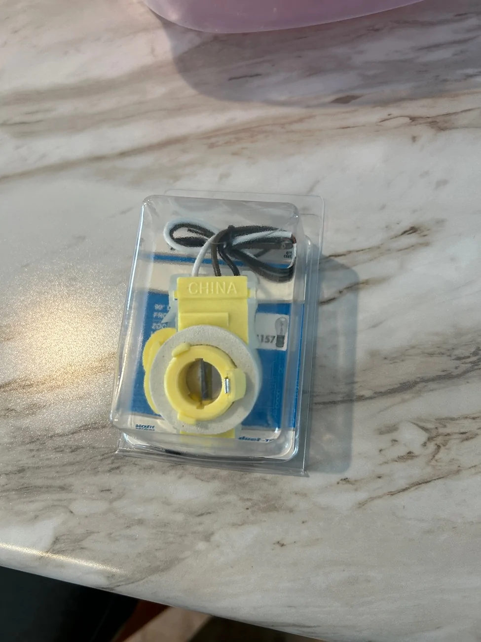

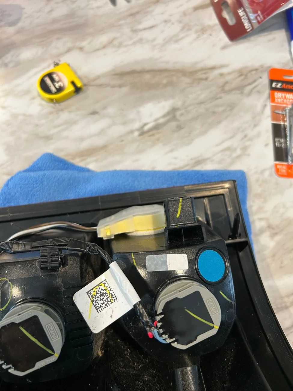

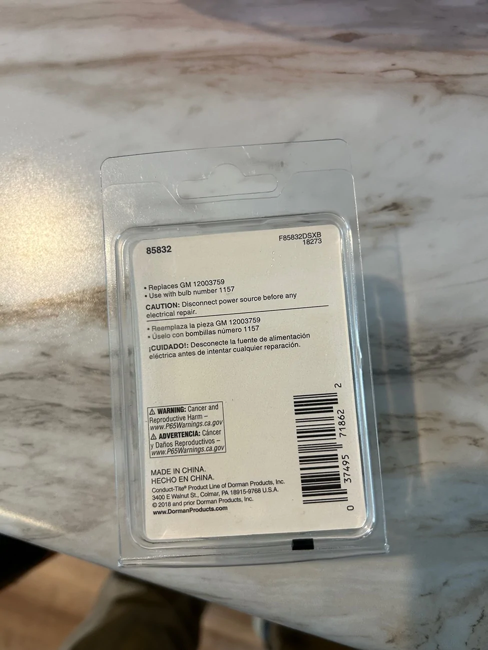

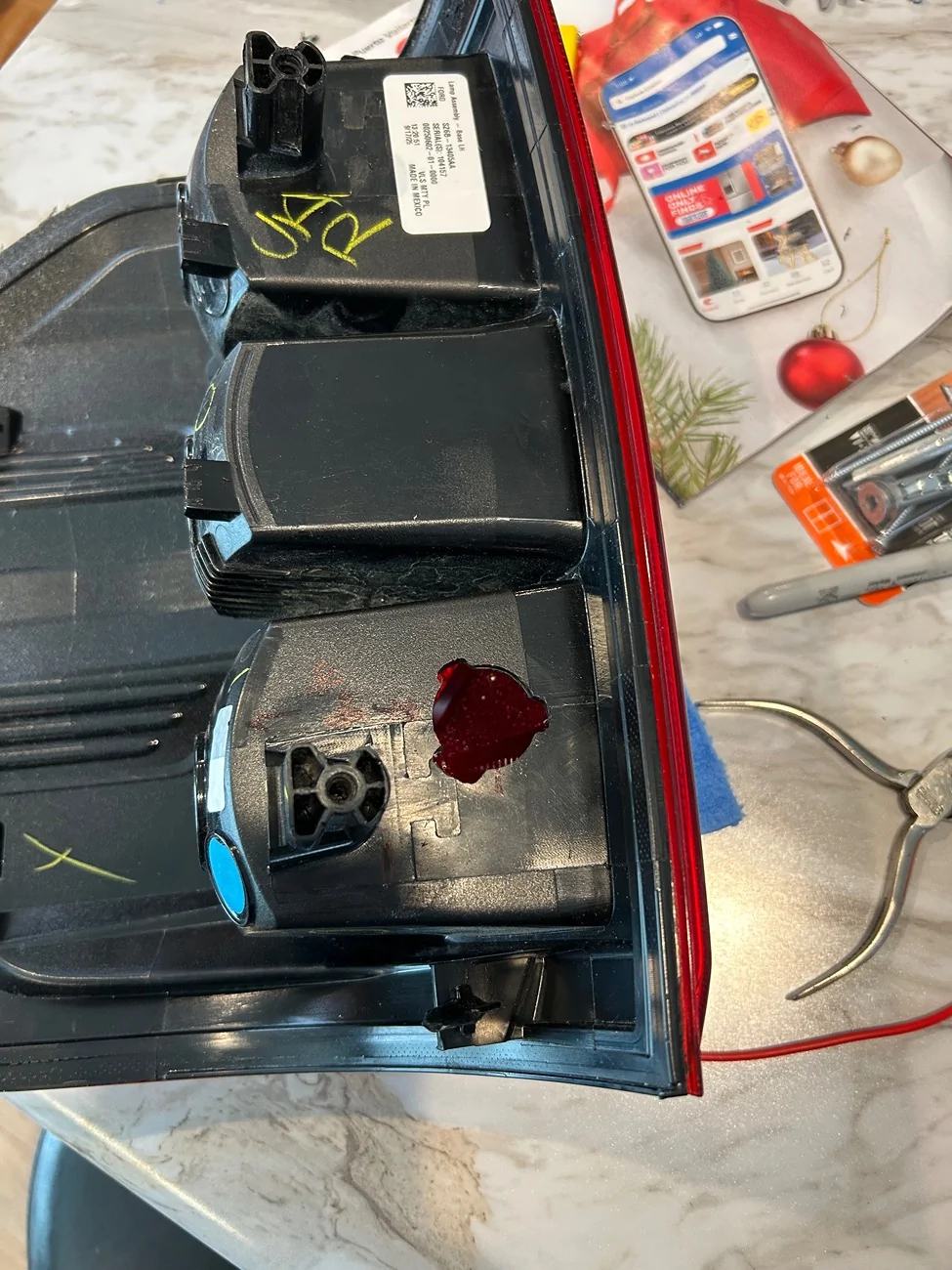

Just finished setting up my 25 AWD Hybrid Maverick for flat tow (traded in my 23 FWD Hybrid). First one had some weird issues with the diodes and the maverick computer (according to the dealer’s service guys). Decided this time to install separate light sockets without using diodes. Just used the top lens but could have done both of them if I was “in the mood.” After drilling pilot holes with a 1/8 bit, used a 1” hole saw to mark the circle, 3/8” bit for the notches, and then finished the hole with the 1” saw. Used my dremel to match the tabs on the light socket and it goes in and twists nice and tight. Picked up the 1157 bulb sockets at AutoZone—right off the rack. Not counting the tools, was about $25 total. Oh—remember to stuff a rag in the housing before drilling—the plastic chips will end up all over the inside of the housing.
