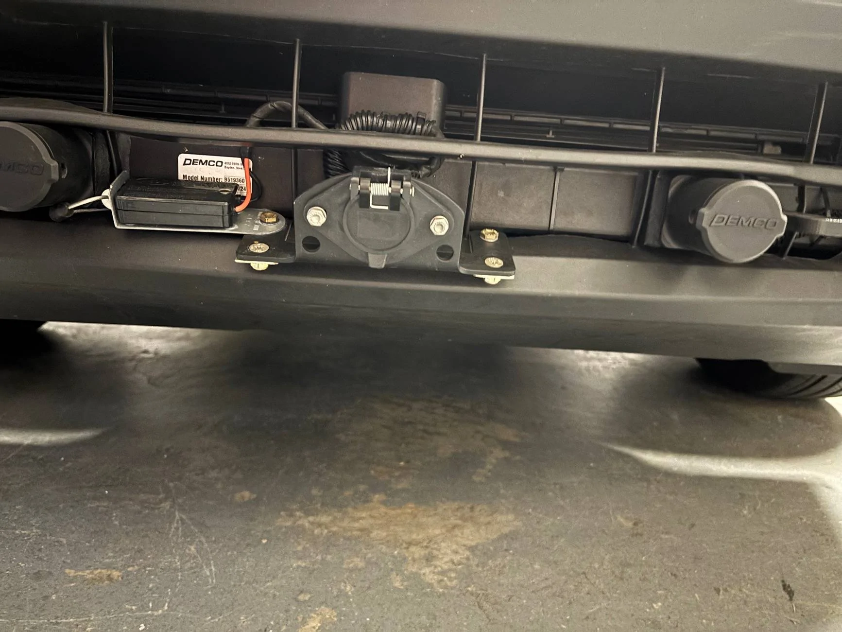

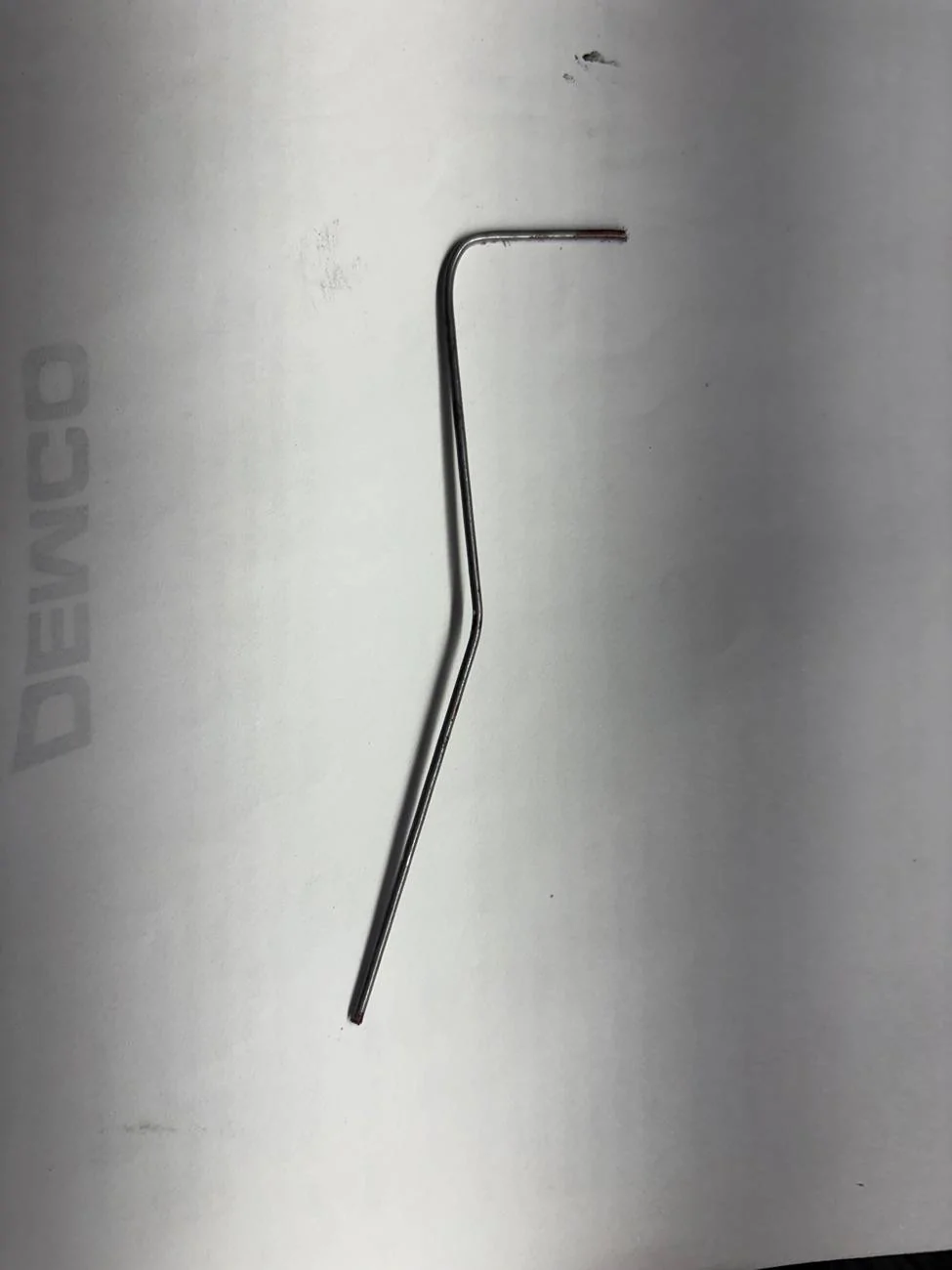

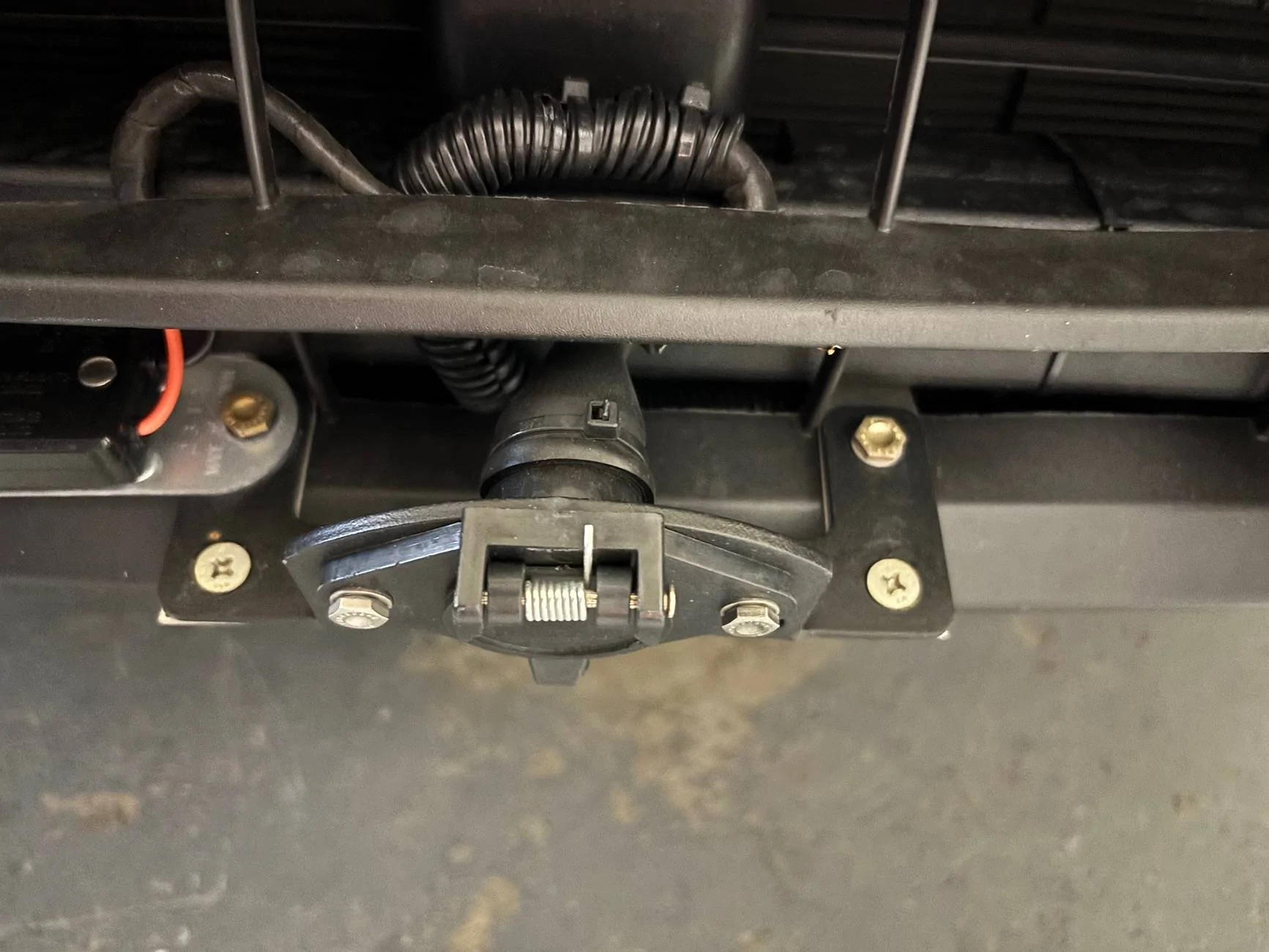

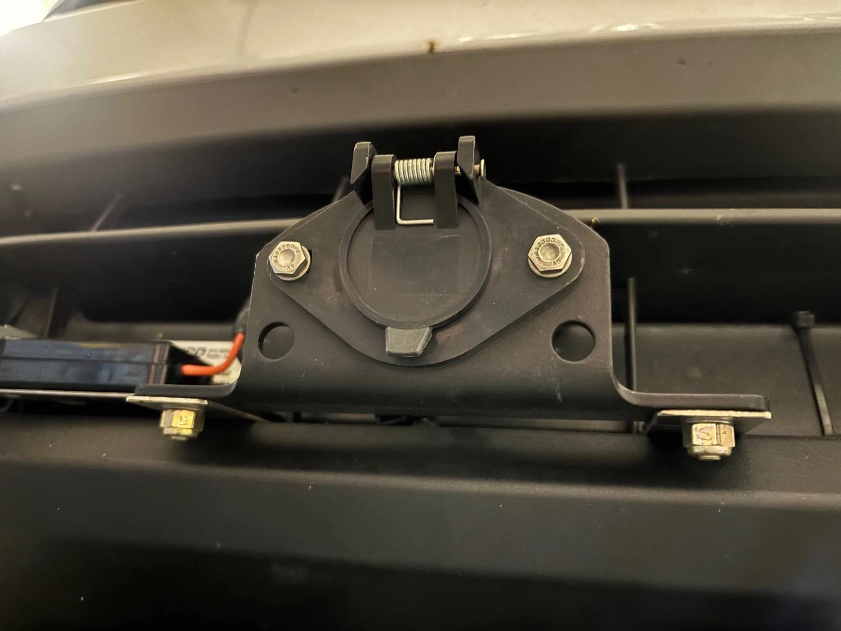

Here’s some pics of what I did. I used the bracket that came with the baseplate (I think) and then fabricated a strip to go inside the horizontal plastic part of the grill with nut clips. I also fabricated brackets that are shaped like the piece of wire in the last picture to fit up behind the baseplate so if there’s pulling on the 6 pin connector while in motion it won’t just pull on the plastic grill piece. The break away switch on the left just swings forward when towing. Hope this makes sense.
