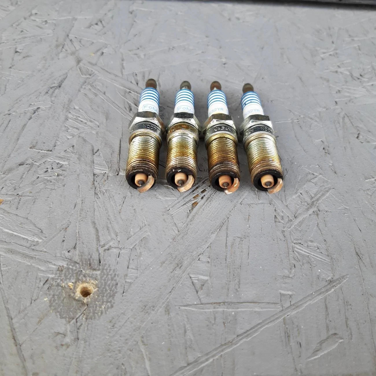

Just because of the mileage, two months ago I changed the spark plugs in my wife's 2016 Ford Escape naturally aspirated 2.5 l with 80,000 miles on it.
I don't think they look too bad.
I expect the plugs in my Maverick hybrid to last at least 80,000 miles
Was the gap still pretty close to spec?

Before I install new plugs, I checked the gap even on pre-gap plugs. I had the tool handy and I checked them. They were little bit bigger but not much. Then again, I have no idea what the gap was when the Escape left the factory.🤷‍♂️
