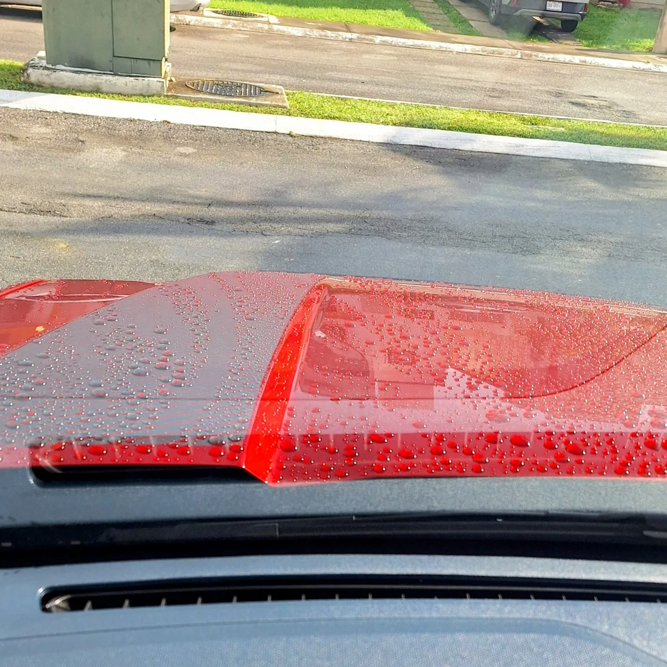

Ceramic coating? Try to wet the area
Ford Maverick Proof of paint protection 20251025_092659~2

If it is a coating or any form of wax/sealant the water will bead up on the surface. Some will also feel very slick to the touch. If nothing is on the surface, water will look flat, no beading, etc. From there, water activity will diminish as the surface becomes dirty and a wash with a traditional shampoo (no protection) will help unclog the coating (if that was applied) and you should see water activity revert to beading again.
The only issue is the "coating" dealers apply (most, not all so it is important to find out what product they are using) is just a money grab. Most of these products are Si02 based (same as coatings), but at a much lower concentration. This means easier application (normally spray and wipe), but much lower durability. Check the find print on the warranty, but most ask you to come back in for cleaning and reapplication every 4-6 months. There is nothing wrong with this type of protection, but it is not a traditional coating and the amount dealers charge for these packages is simply a ripoff.
You can pick up a quality product better than what the dealership used (I.e. Gtechniq C2) and apply it easily (again spray and wipe to all exterior surfaces). A 500ml bottle is about $32 bucks. A real coating application is more labor intensive and lasts much longer than a few months.
