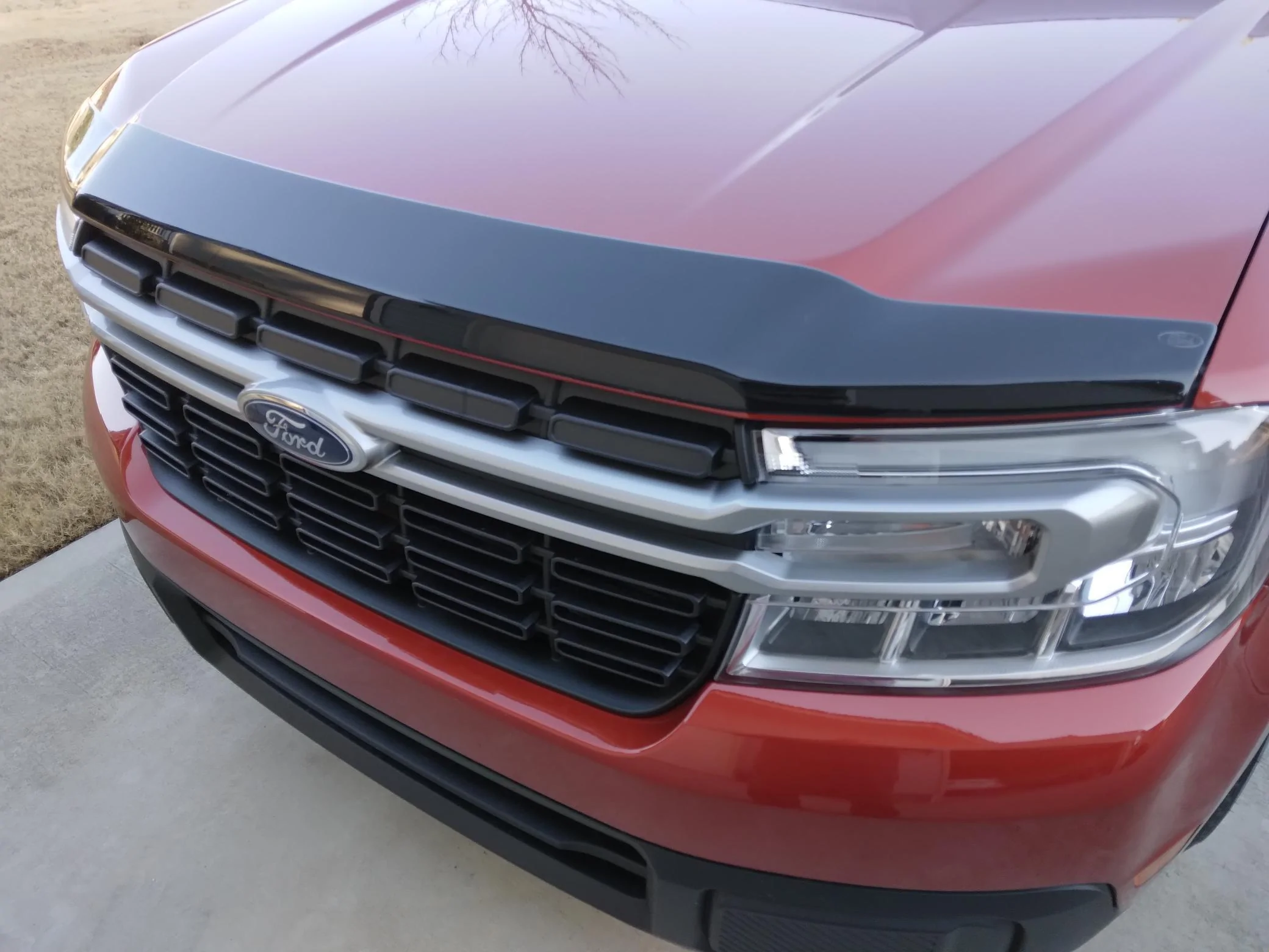

Get a hood bug deflector. Everything below the hood is molded-in colored plastic and not paint. Most of them (including the Ford option) use double-sided tape over the paint, and will be a mess in 5 years. Most also do not cover the fenders. Get one that mounts under the hood edge and covers the fenders. I use the Bugflector II, but others exist. Then get a really good wax job to make the doors slippery and more resistant to stone hits. Ceramic also works. Forget PPF and plastic sheets that look like crap after they start degrading in the sun. Get a touch up paint bottle for any that get through your protection, and relearn the 2-second rule to stop getting peppered by being too close.
I believe the old AVS Bugflector II is now a Husky product and has some changes to it, but is still a defector and extends to the fenders. Not just a leading edge hood protector.
