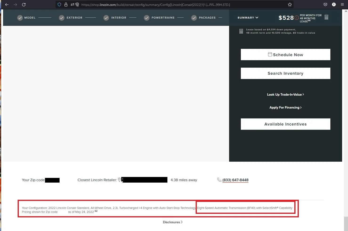

It appears that the Lincoln 2.0 uses the same 8f35 transmissions at the Maverick uses, but the 2.3 uses the 8f40

I need sources.
I don't have access to anything that shows a 8F40 trans as an option. Ford online parts and online dealers show it as an 8F35. If you have documents that show it, I'm all for it! I'm here to learn and understand Ford's nomenclature, but personally I haven't heard anything of the sort besides word of mouth online.

I need sources.
It's stated at the bottom of the Lincoln Corsair build page that the 2.3 comes with the 8f40.
Ford Maverick Project QuikRik. My Velocity Blue XL AWD Performance build corsair 8f40

Awesome! At least that is something! That is the first I have seen of anything stating that trans exists, haha.
