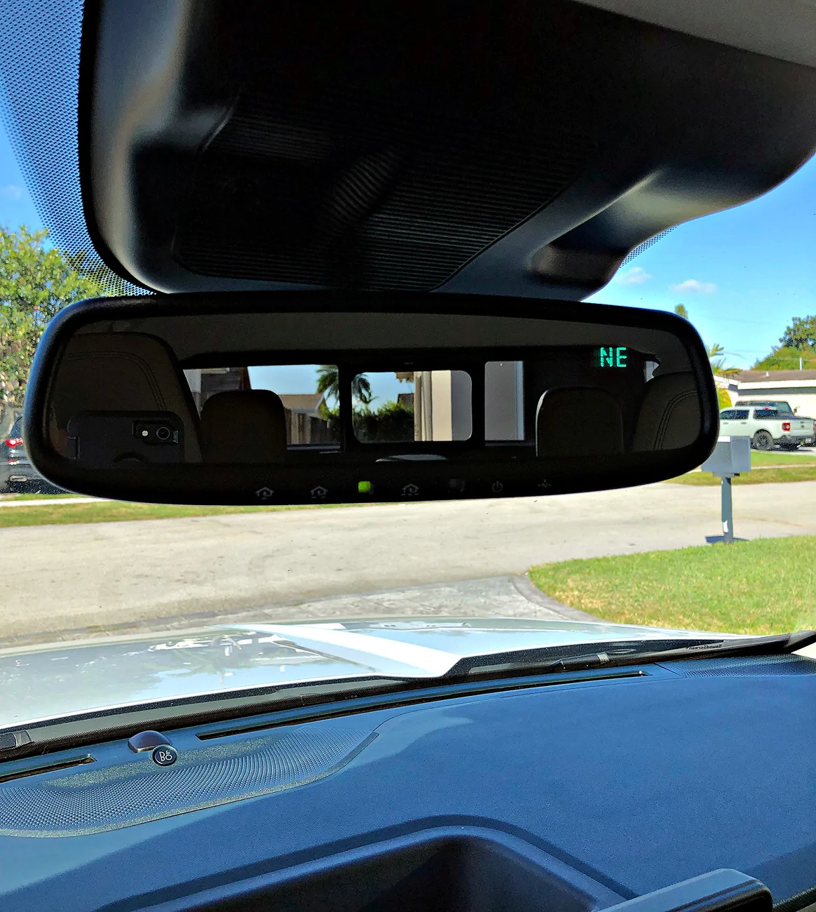

First thing I did was Install a Gentex Auto Dimming with the Homelink. Bought parts & made the wiring adapter while still waiting for my 25 Lariat to be built. Ebay NOS mirror was $ 30.00 ish delivered (don't remember exact cost). Programmed all 3 Homelink buttons for Doors & Gate. One of the best things I have done. The Auto Dimming in itself is the main reason I wanted this. Works perfect
Ford Maverick Programmable rear view mirror. 1782753115445-1z
