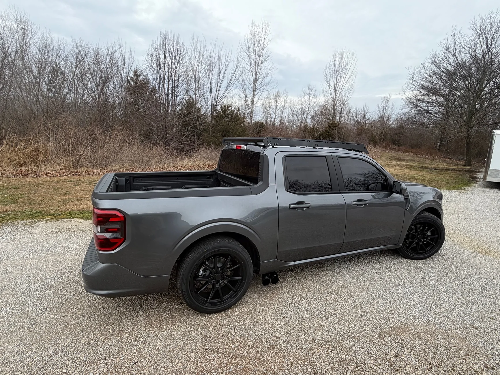

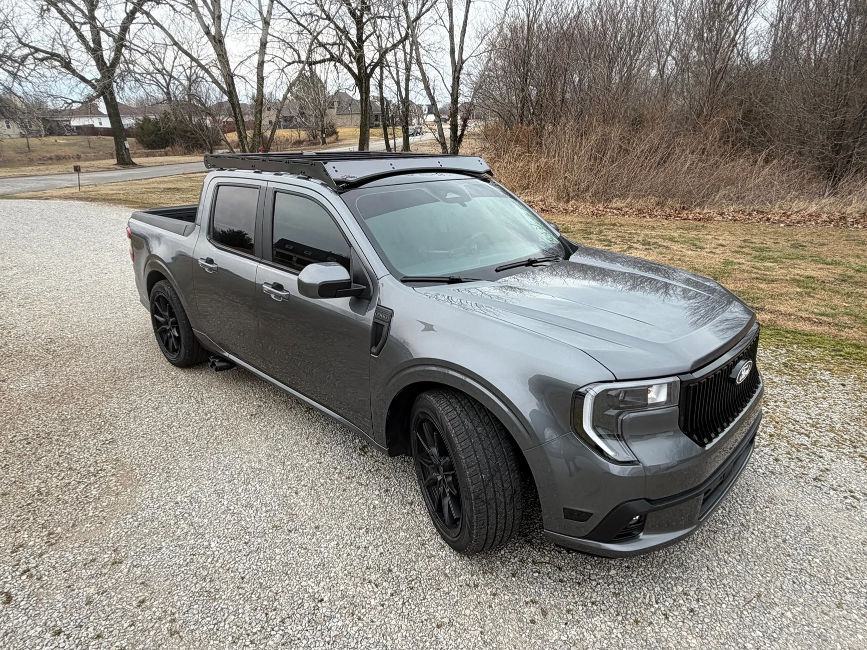

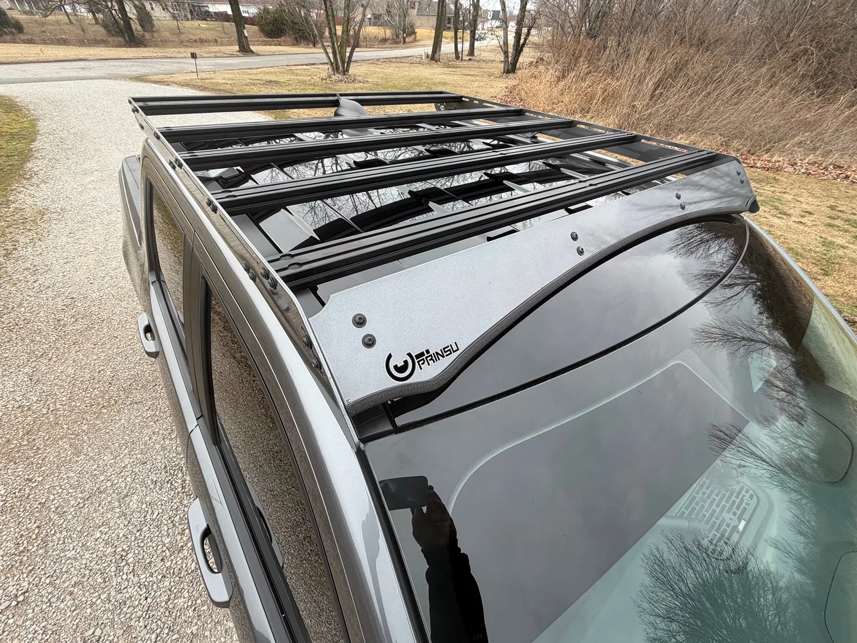

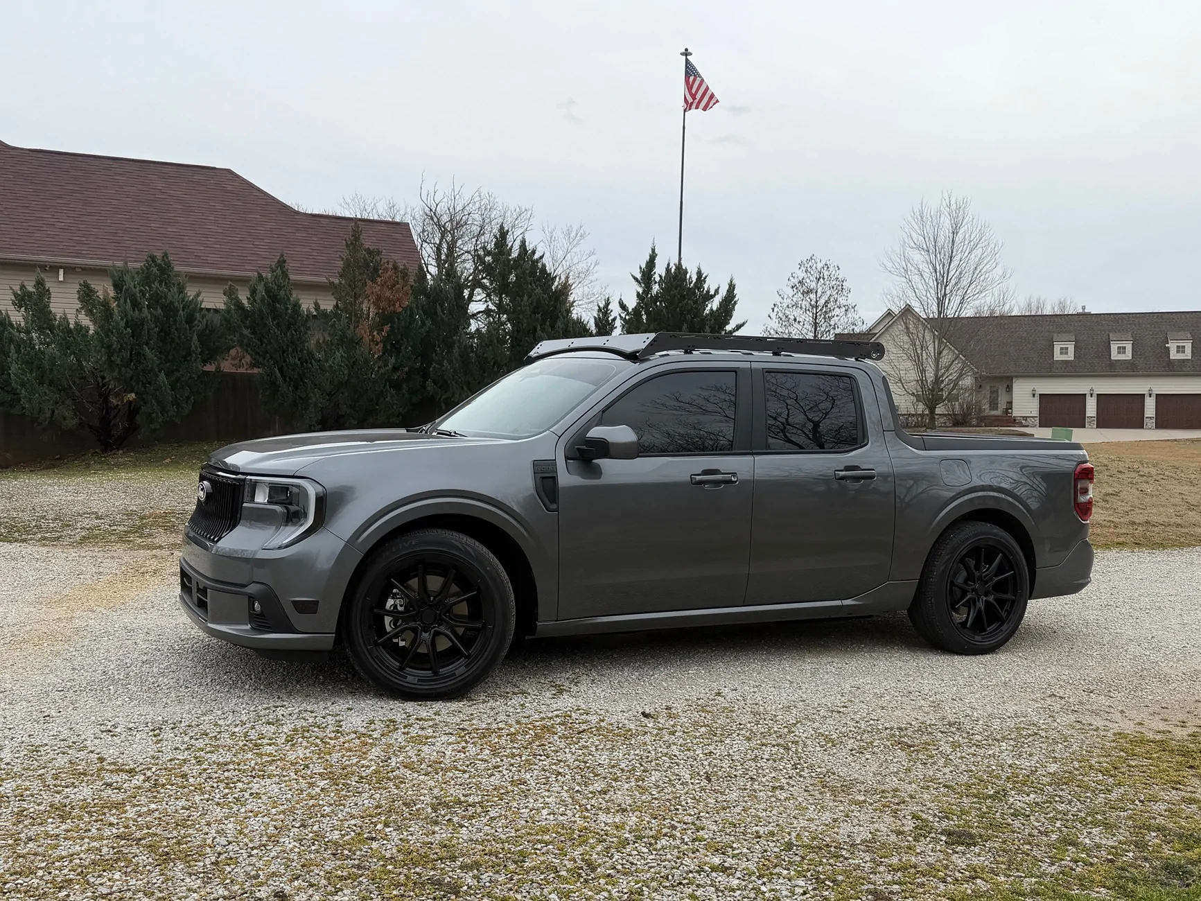

I installed a Prinsu roof rack on my 25 lobo, I'm loving the looks, kind of blending 2 styles together!

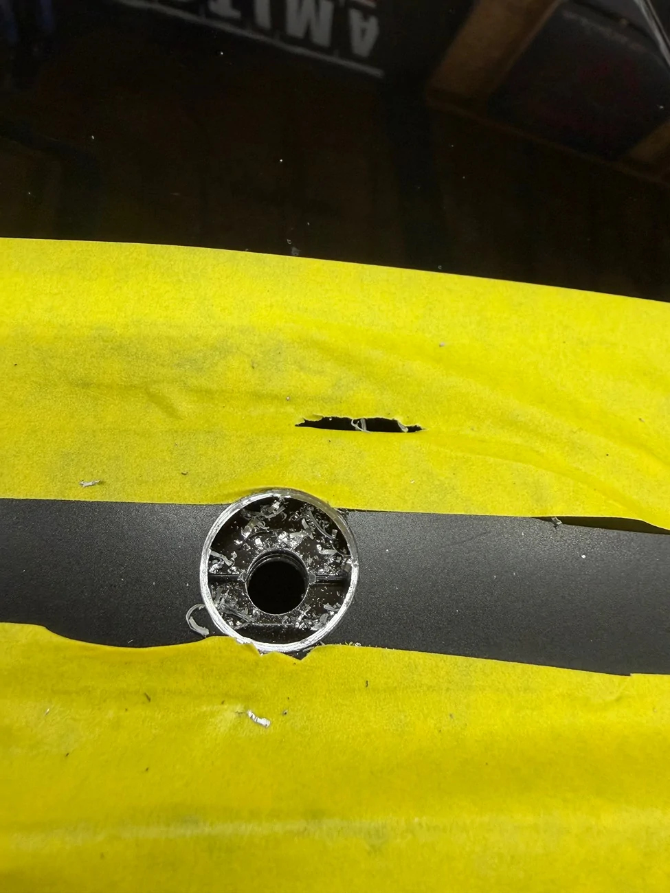

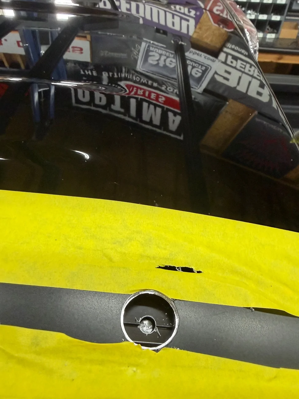

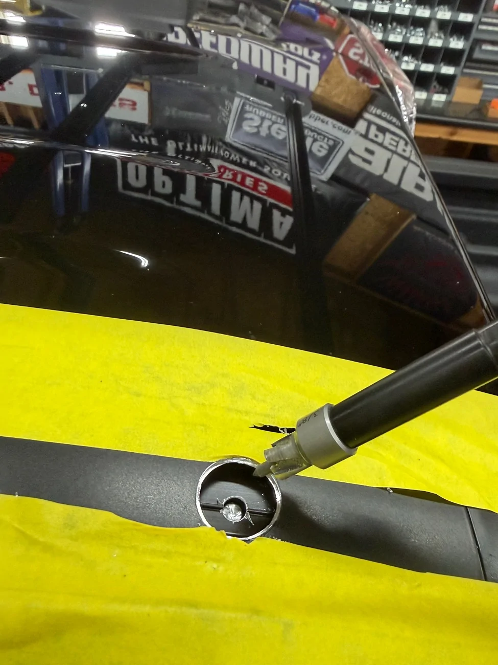

you do have to drill 4 holes in the roof, and its not suer easy, but after struggling with the front driver side, I think there is more structure there , or its hardened beam the other 3 where much easier.

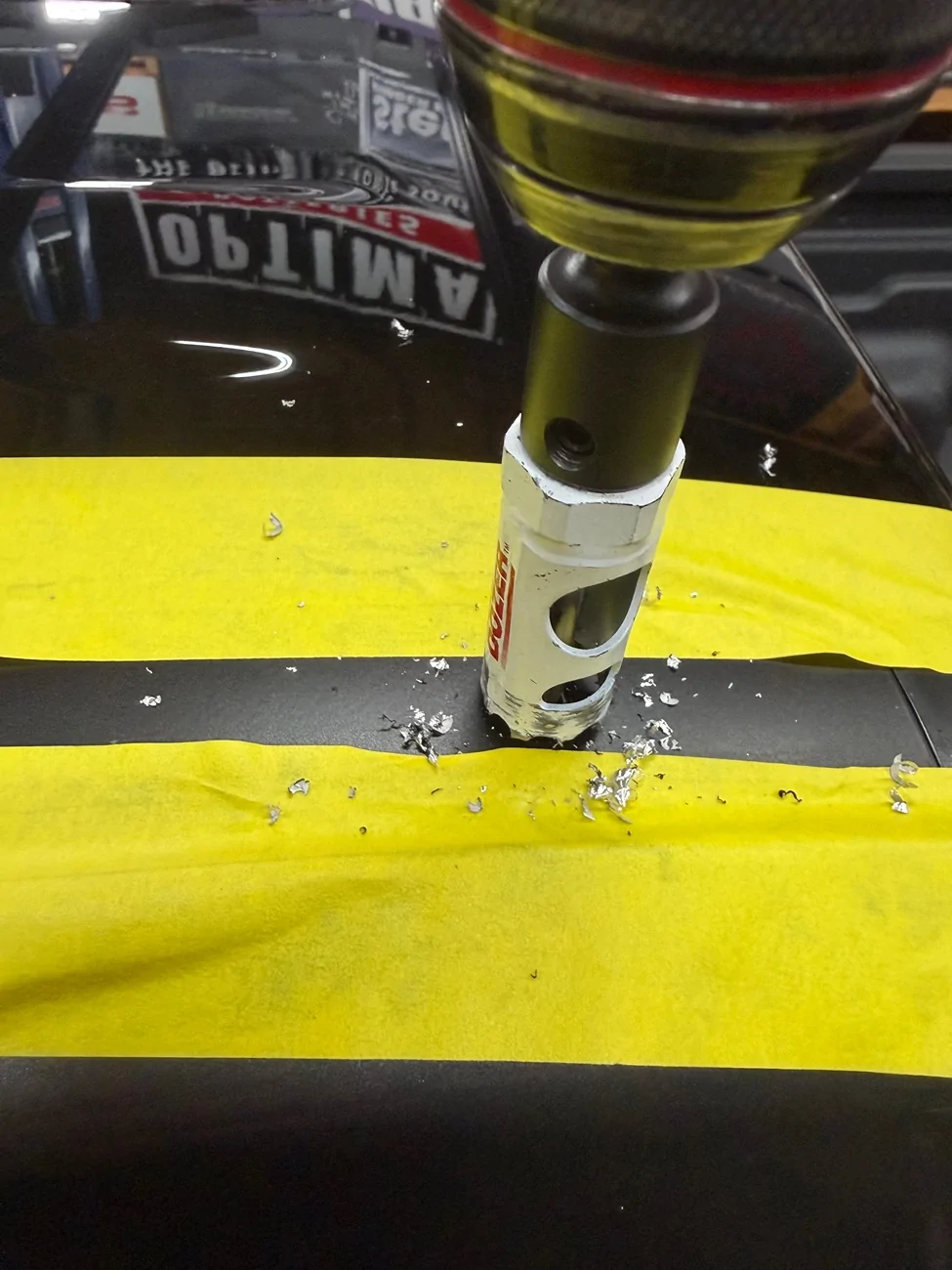

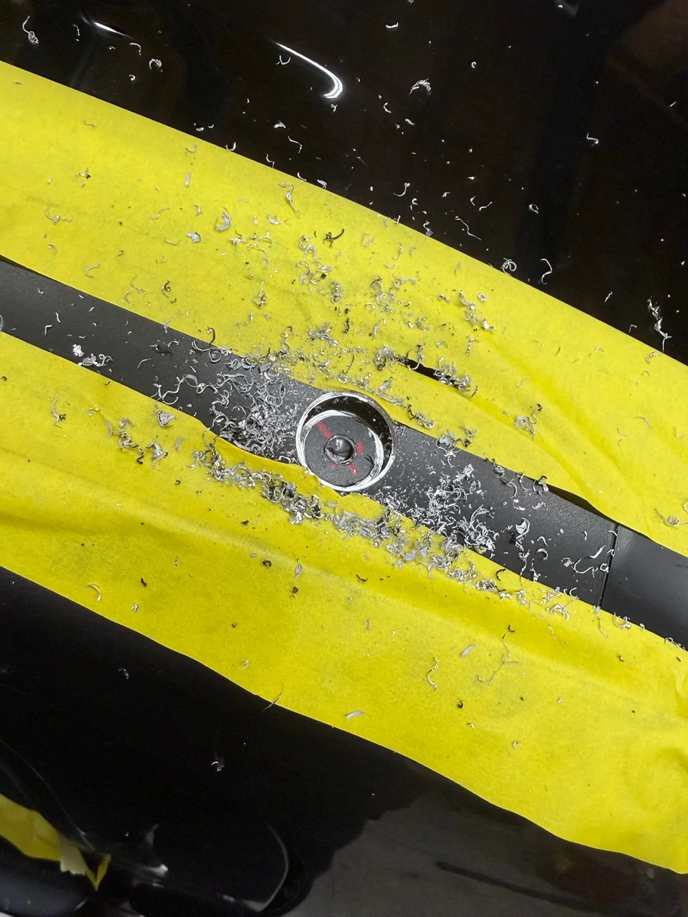

I used a 7/16" hole saw to start the first opening hole up, then follow top with a rotabroach type spot weld drill but to get through the remaining metal pieces. there is many layers at the spot on the roof cap. After that use the 7/16" hole saw again to get the lower roof rail trim pieces cleared out, then add some paint to protect it, install the supplied plus nuts, rtv sealant and install.
I had mine color matched and powder coated with color from prismatic colors that is very close to the factory match . With a 400 dynamic weight load and 800 static load rating , these are super strong and can hold about anything these little trucks can haul around!

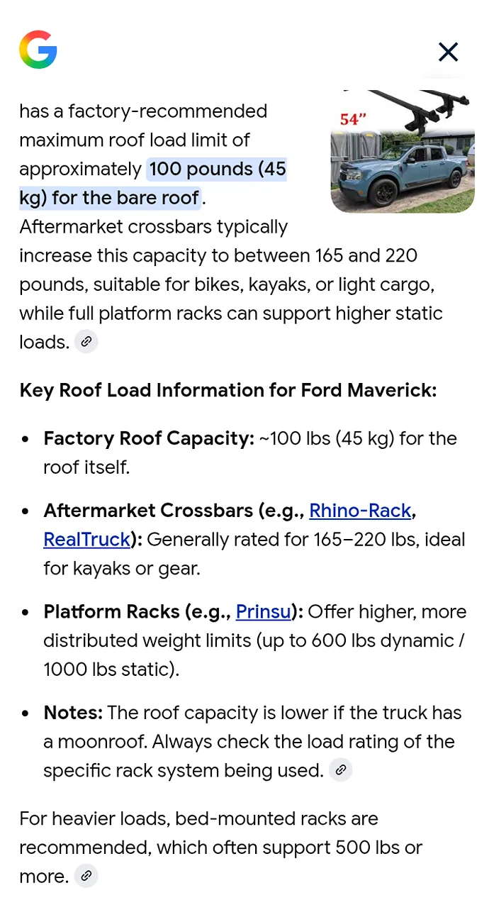

Watch the Prinsu install video. 4 riv nuts installed with pookie. Also FYI
bingo, maybe these guys think your drilling in the center of the roof skin? the "roof" as they are calling it is the actual skin in the center of the truck, these racks install through the side rails where all the panels seem together.

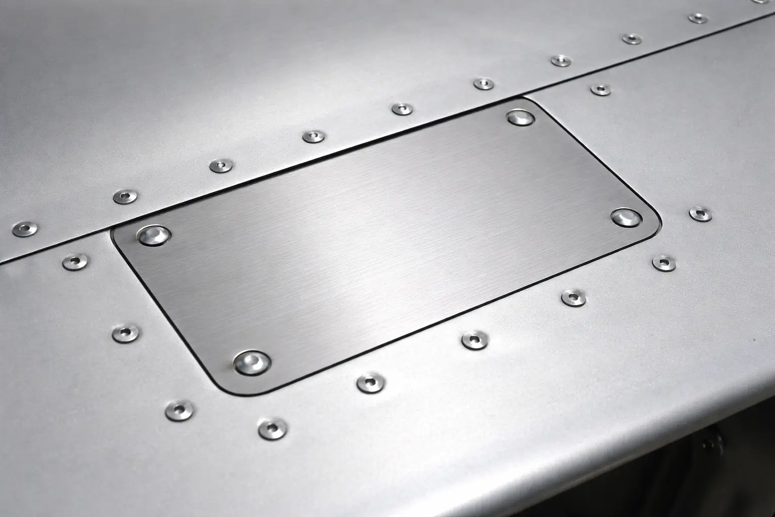

what is a dubbler? the roof is plenty stiff enough, no need for anything extra.
Just a square piece of sheet metal that goes under the roof to give it some additional strength. I doubt the roof was designed to hold that type of load, especially over time and rough roads. something like this
