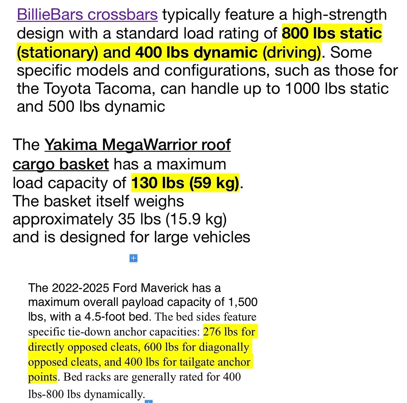

Can you please provide a link to support your statement about a bed rack like yours, that is substantially more capable of carrying a load, than a roof rack?
Bed rails as a structure are no where close to as stong as a roof seem. I get the fact its way easier to bolt on some clamps for a rail type system but your statement doesn't add up to me, maybe I'm wrong, but most "basket type" like you show are rated for about 100-200 usually
everyone ive seen is rated at or less than this set up, which is rated 400lb moving load, 800lb parked

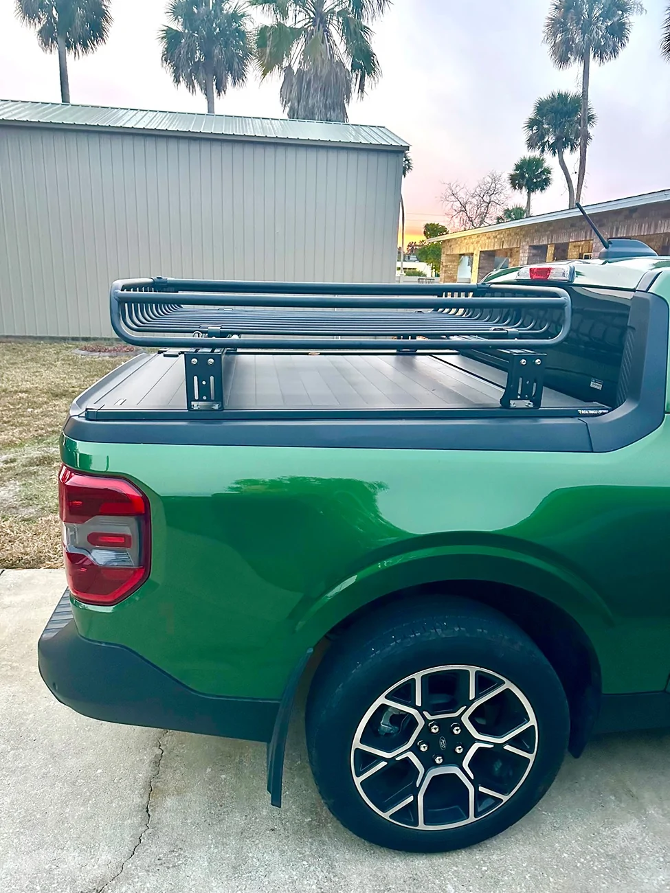

My statement was an opinion but as we all can acknowledge how structures are supported can change the load rating if you were to suspend the Yakima MegaWarrior using the outer bars the load rating would only support the stated 130 lbs but if supported it underneath the weight capacity would greatly increase adding a third crossbar would only increase this although my two crossbar installation transfers the load capacity to the crossbars which are rated at 500 lbs each distributing the load to the outer edges of the crossbars then transfers the load capacity to the truck bed - I’m not saying the roof mounted option is not a good one just saying the bed mounting option allows you to increase the load rating the roof mounted is what it is the bed mounting option allow you to increase the load rating using additional supports to max out the truck’s capabilities
Ford Maverick Prinsu roof rack installed! IMG_6384
so again, you said a bed rack will hold substantially more weight than a roof rack, yet you posted above the same weigh ratings for your bed rail mounted cross bars. not to be a jerk just saying.
FYI I have had 2 of those basket types rust out with in 1 year of use on a car that was garaged everyday.
