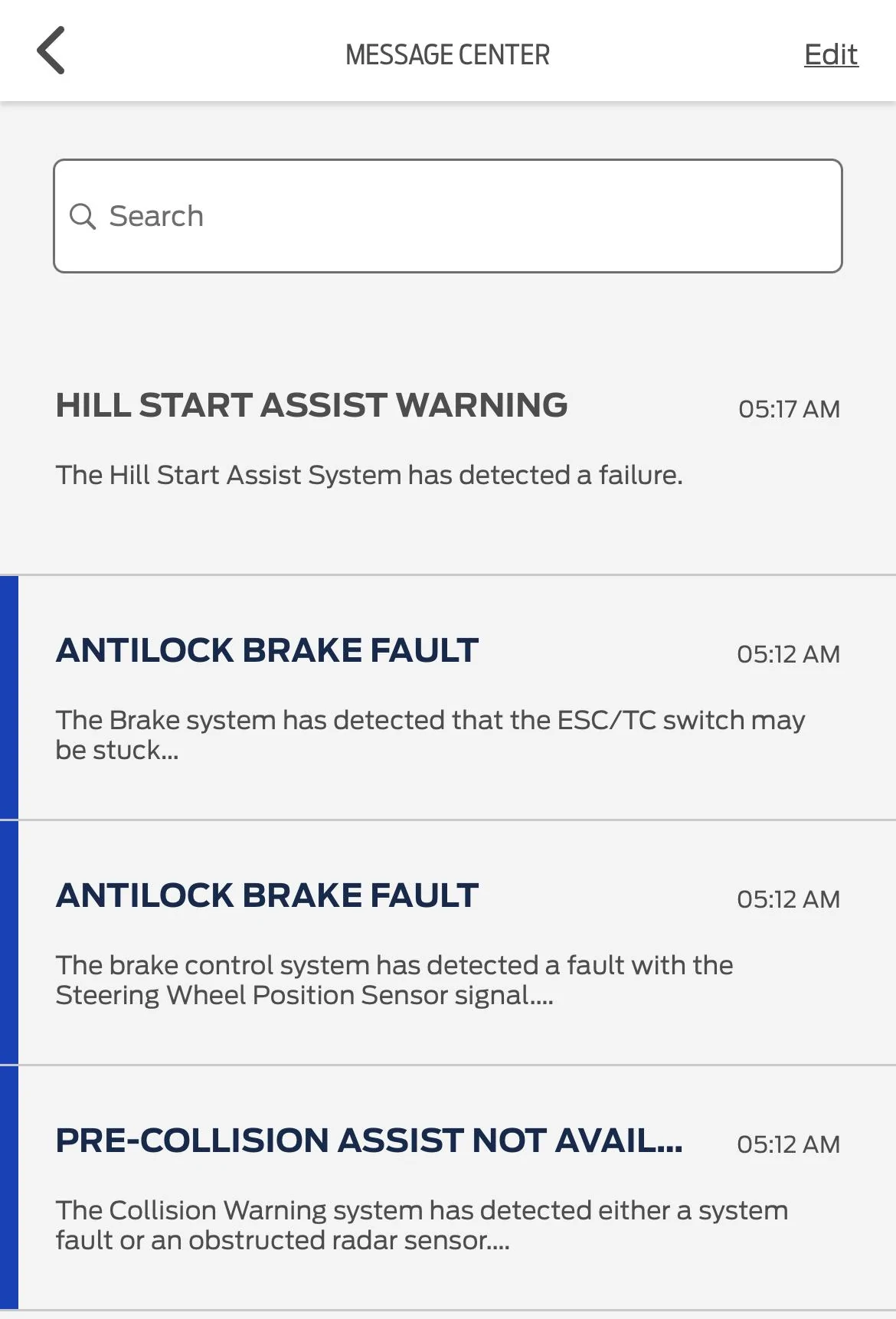

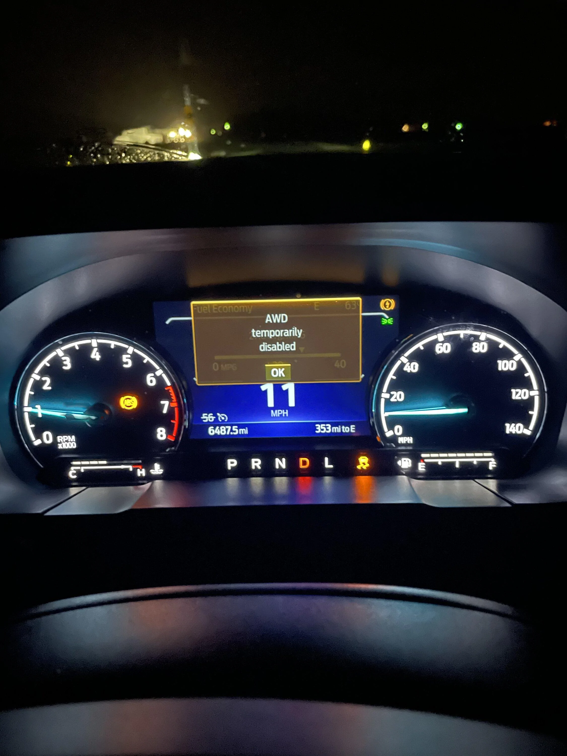

Hey everyone. I was driving to work this morning in the rain in my 2022 2.0L AWD when the dash lights lit up like a Christmas tree. Precollision avoidance disabled, AWD disabled, ABS disabled, Hill Start Assist disabled. Also, the power steering isn’t working.
Has anyone seen this? It is similar to SSM 50771 but my truck was built in OCT22 after this was resolved. Has anyone seen this or have a solution? I used VCM scanner to check for a DTC and there are no PCM codes, but I do not think the MPVI2 reads the PSCM or ABS module.

Similar instance although they never reported what the actual fix was other than they had codes for a wheel speed sensor error.
IIRC there's also been some similar with bad wiring harness terminals or connector not fully latched, but I can't locate them on a quick search.

Simple check is to verify tight battery terminal connections.
