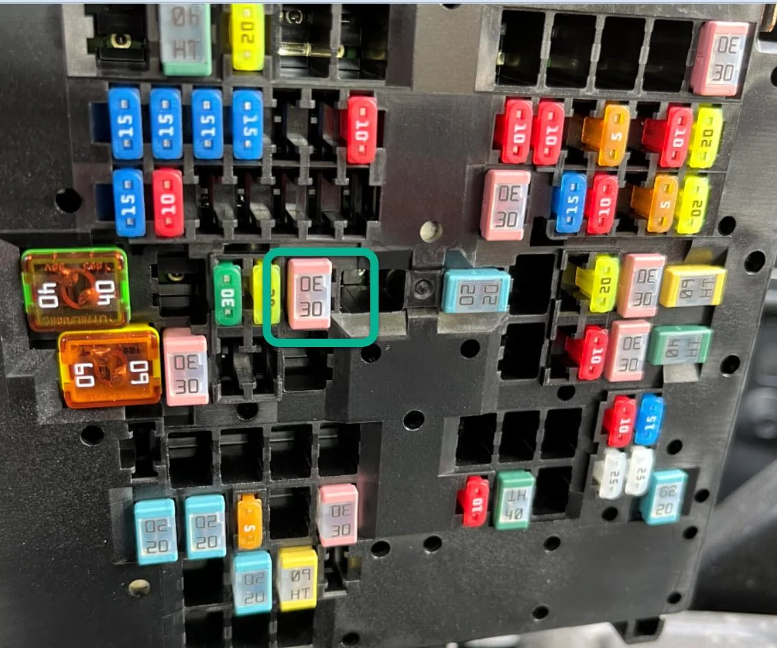

So I have found a local company that can add the heated pads for both the passenger & drivers seats. I am trying to find out if there is already a power circuit available under the seats. My Maverick did not come with power seats or heaters. So I can assume that the power wires from Fuse 39 may not be present. If that is the case then I may want to add the wiring before I get the heaters added. Any thoughts on where to tap off the power?

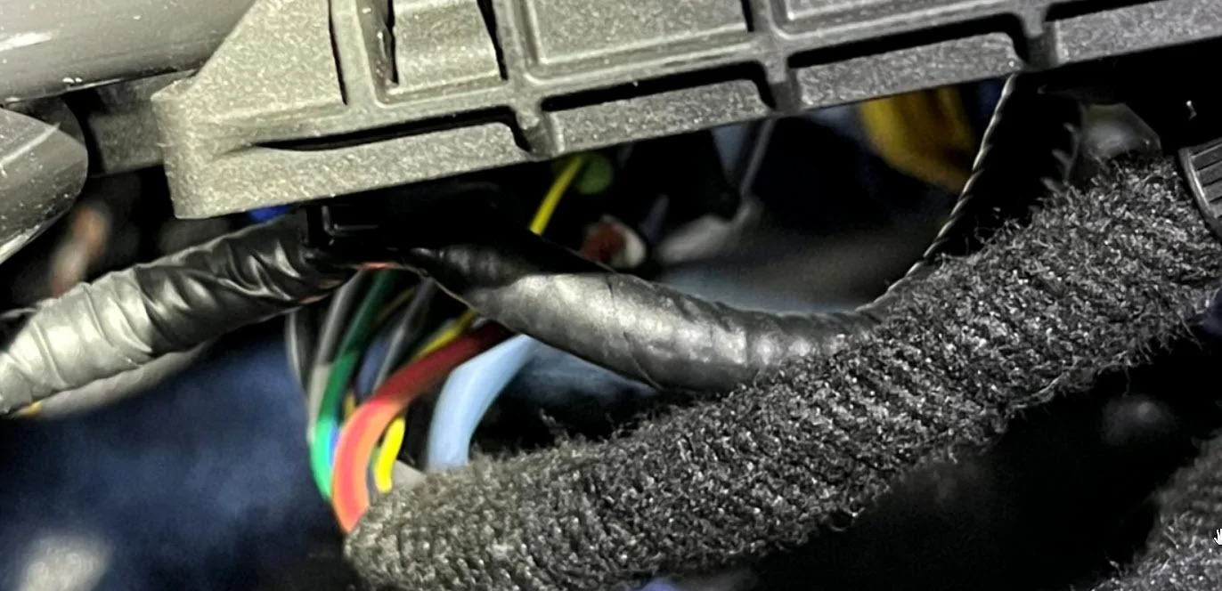

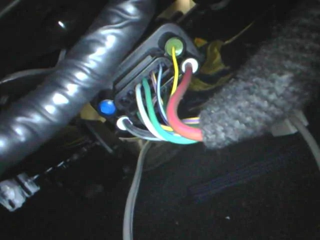

Another post mentioned power is at the driver seat.

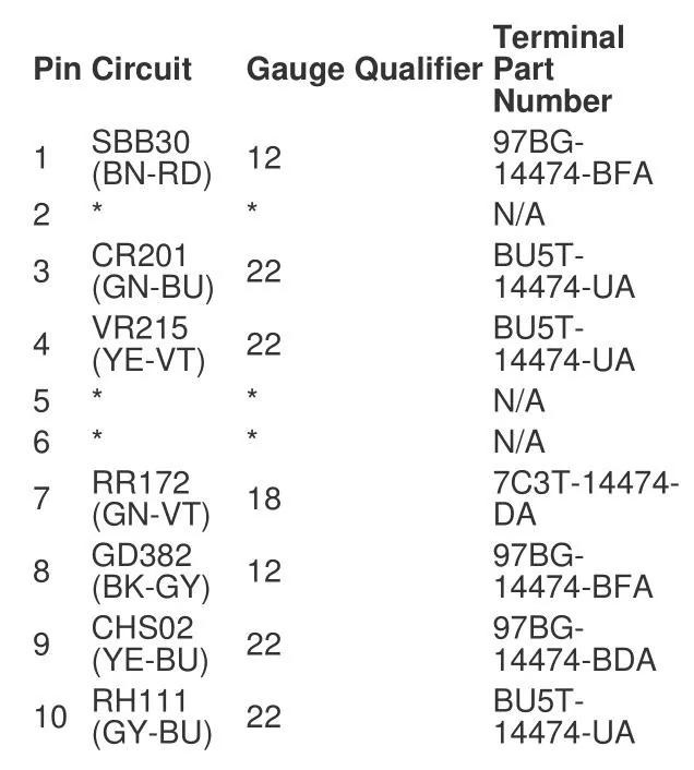

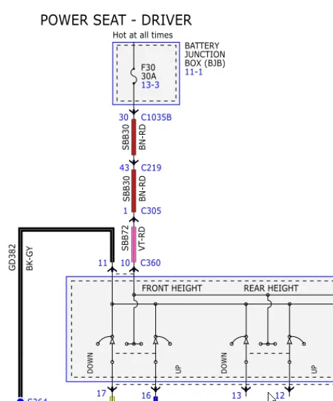

I don't have a power seat, but I can maybe see in my poor photo a Brown/Red wire under mine that I need to check if it's on C305 Pin 1 and if it has 12V.
Ford Maverick Power for heated seats aftermarket addition Driver Seat C305 BN-RD, BK-GY Ford Maverick Power for heated seats aftermarket addition Driver Power Seat F30, BN-RD Ford Maverick Power for heated seats aftermarket addition C305 Pins 1, 8 12 Awg Ford Maverick Power for heated seats aftermarket addition C305 Connector Outlin Ford Maverick Power for heated seats aftermarket addition Fuse F30 - Driver Power Seat

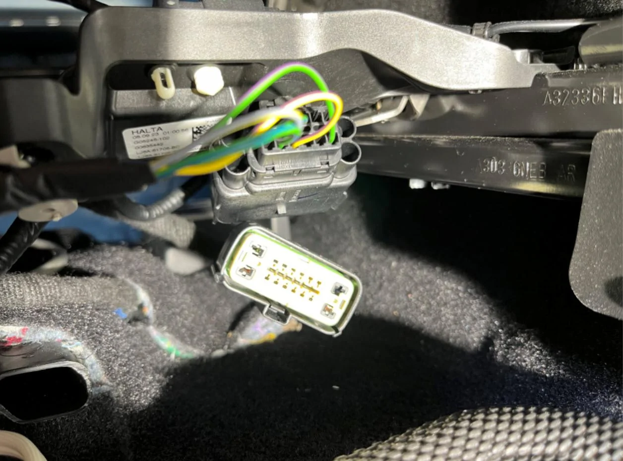

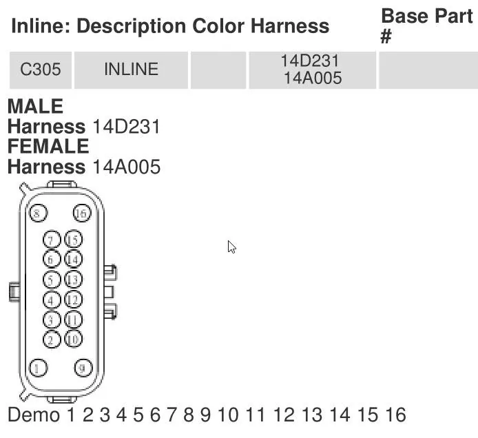

Checked C305 BN-RD to BK-GY, seems to have hot all time +12.
It a bit hard for me to put temporary pins in and get a reading with a DMM.
Male Connector isn't wired at Pins 1, 8 b/c I don't have power driver seat.
Ford Maverick Power for heated seats aftermarket addition Maverick Driver Seat - C305 Female - Rear View - IMG_0107
Ford Maverick Power for heated seats aftermarket addition Maverick Driver Seat - C305 Male, Femal

Thanks for the pictures under the seat. The reason I would prefer to have power available under the seats is that way I don't leave it up to the heat pads installer to just splice into any random wires and I want to also have the power on only when the truck is running.
