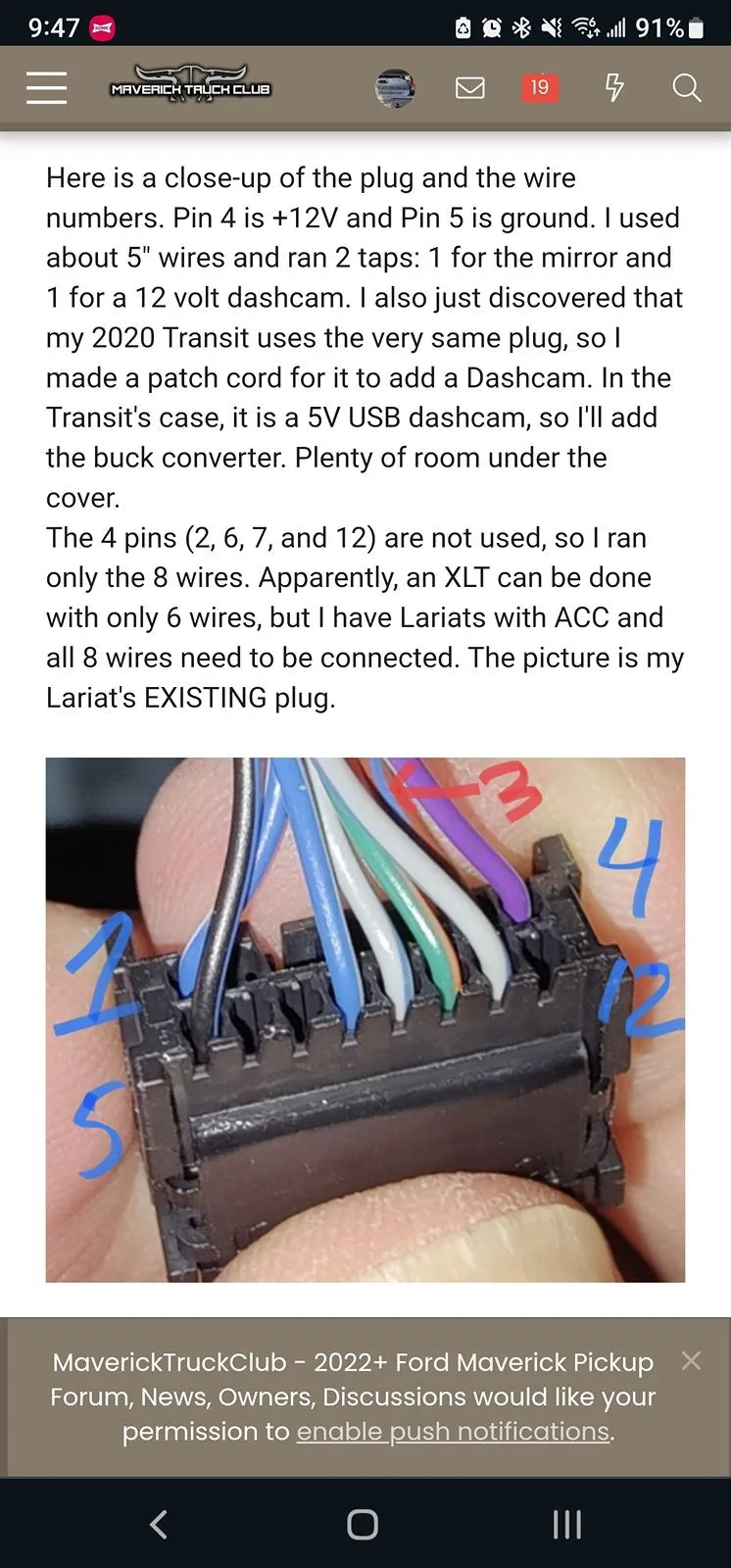

My plug as you can see in the photo I took was a mirror image of what was labeled and pictured by another member. I wonder why the difference? Did it change during the model run or is it a trim level thing?

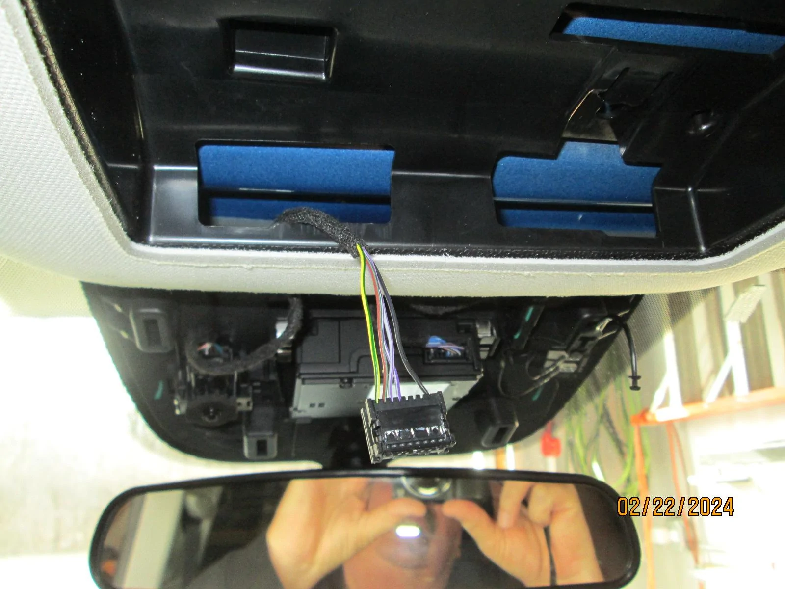

Using the pins and the 8 pin connector I made the patch cable from the overhead lights.
Then used the factory kia plugs on the mirror (male and female)
Used 1 of the female plugs like these
20 Gauge Silicone Connector for JST, SIM&NAT 5.9 inch 2 Pin Male Female for JST RCY Plug Connectors Cable Wire for RC Toys Battery (10 Pair) https://a.co/d/cEzCBnw
To go with this 5v buck adapter
YQMAJIM Dashcam Power Adapter Spare Output Connector Special USB Buck Module, DC 12v/24v to 5v USB Output Charging Adapter with a (50cm) Mini USB Shorty Cable https://a.co/d/7FYNlmJ
3m VHB tape to the back of the converter and the windshield allows me to connect my dash camera with minimal wiring showing.
Everything works perfectly and I didn't "tap" any factory wires or damage the insulation on the wires.
