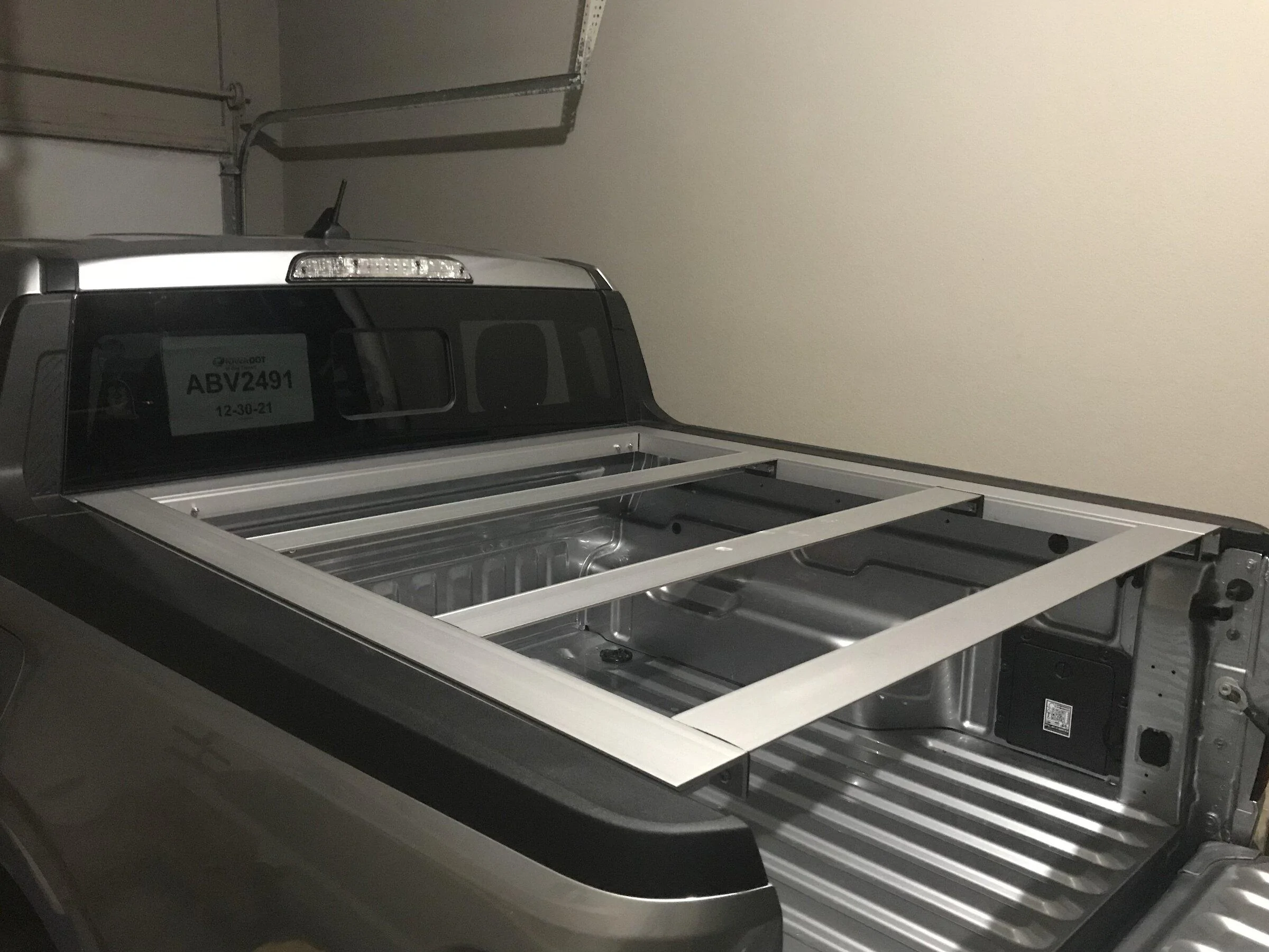

Here's a few pics of my DIY PoorMax hard, one-piece cover I made :ROFLMAO: It's a relatively simple design using aluminum angles and ACM panels. It's either on or off, but easy to remove and leave in the garage if I need to.
I ended up making this cover because I couldn't justify the price of a cover like the LoMax. I know they are excellent covers as I've had Access tonneau covers previously and they were all really nice. Ultimately, this got me the low-profile look I wanted, it seals well and didn't cost me a grand. I'm only about $250 in it so far but it's stout.
After this project I definitely have a new respect for the hard cover manufactures. There's a lot that goes into making even a simple cover such as this. Accounting for various tolerances, temperature changes, hardware, weather-resistance, etc. are no easy task and I imagine sometimes overlooked by DIYers. It may seem like I just threw together a frame and attached some panels but there was a fair bit more that went into it.
More pics and info. in my build thread: JJC's Iconic Silver build - Post 14
Thats pretty slick. How do you secure it?

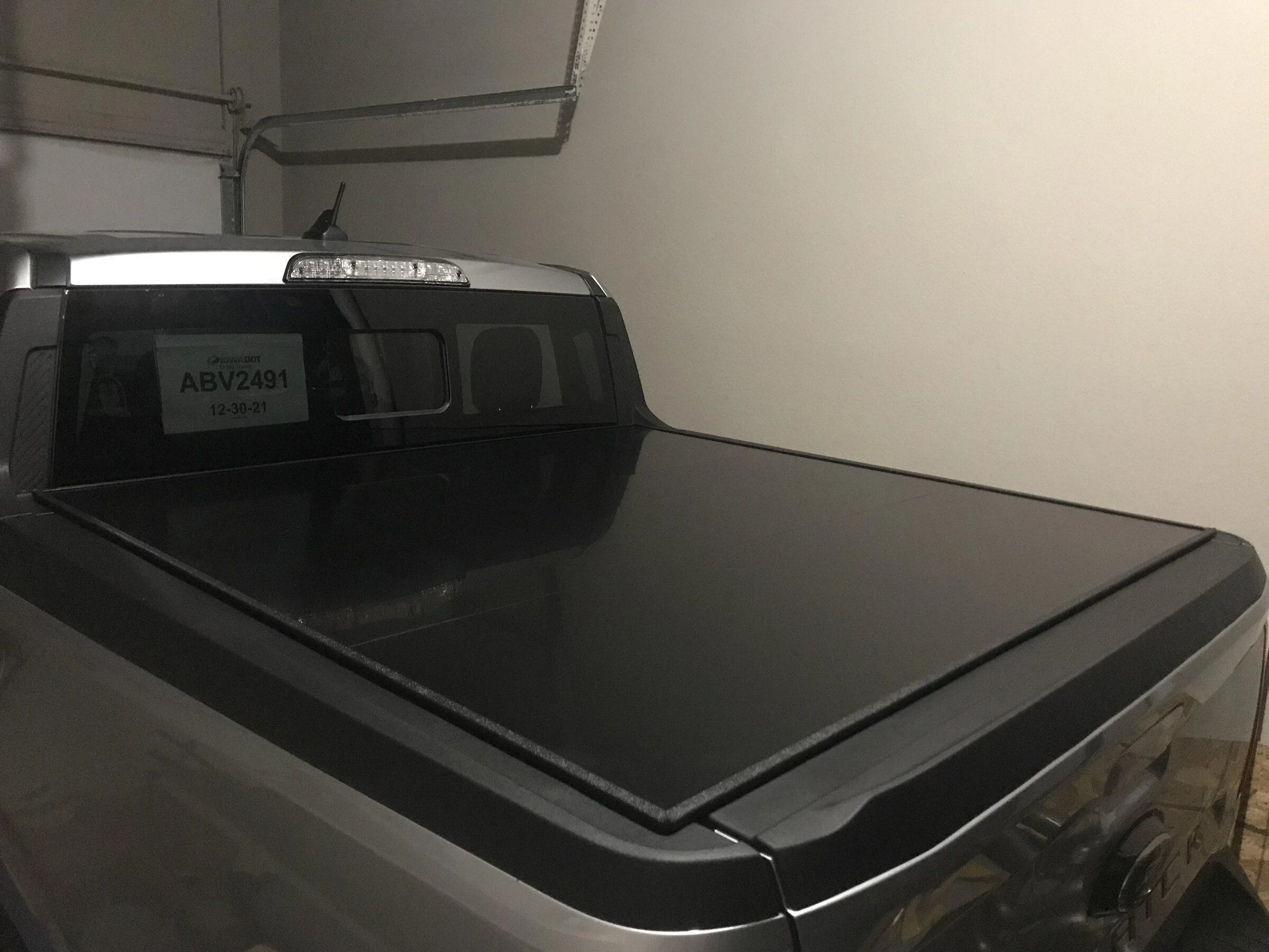

I've been thinking about adding some aluminum to stiffen the top as I'd like to be able to set things on top and not worry about sagging. I think adding a rail and attaching the aluminum to the cover rather than the frame so it can still fold it flat back on itself.
