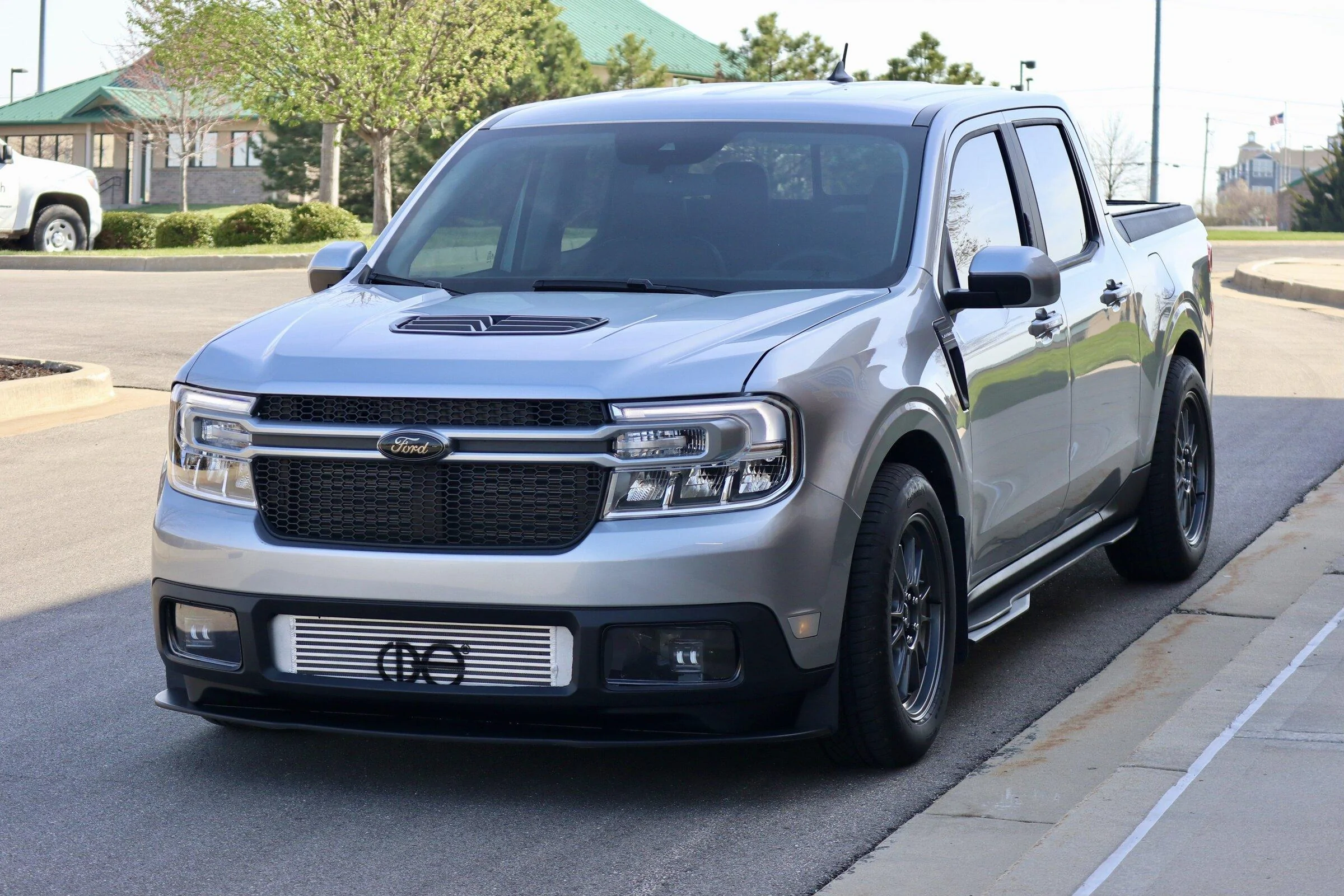

ISC Suspension should have adjustable coilovers available this Spring, I was just impatient and went with the H&R Escape springs for the time being. I'm definitely happy with them for now but adjustable coil overs are at the top of my list once they're available.

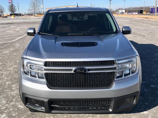

YOU HAVE SOME SKILLS....BRAVE CUTTING INTO THE HOOD. I'M A NOVIST AND WON'T ATTEMPT THAT.... BUT THAT'S JUST ME. YOU GUYS ARE VERY TALENTED!!

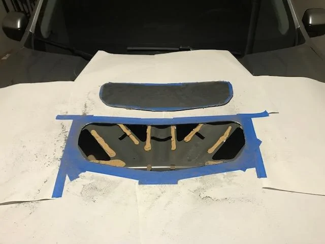

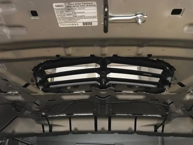

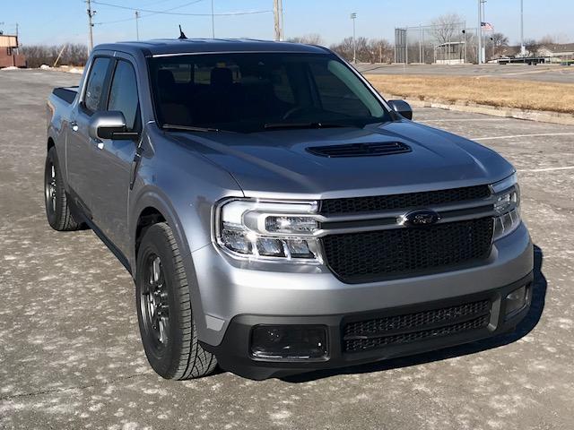

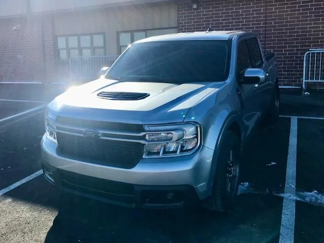

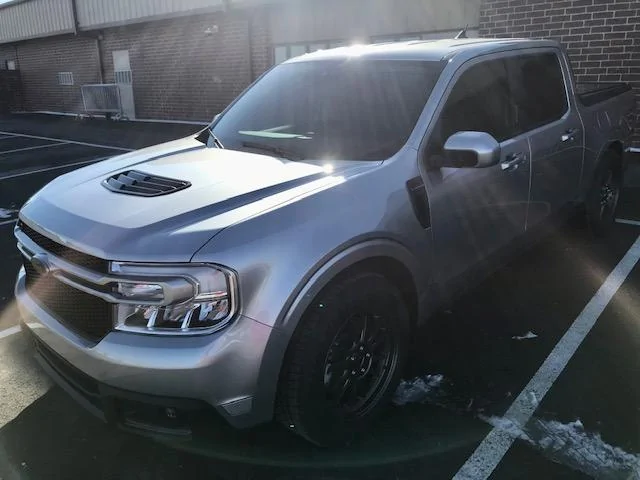

Making the hood vent pics & info. a separate post so I can update the OP to be a current gallery and link to various mods:
Ford Maverick JJC's Iconic Silver build IMG_7185
Ford Maverick JJC's Iconic Silver build IMG_7186
I spent significantly more time placing my template than actually cutting.
Measure a thousand times, cut once 😅
Ford Maverick JJC's Iconic Silver build IMG_7175
Ford Maverick JJC's Iconic Silver build IMG_7177
Ford Maverick JJC's Iconic Silver build IMG_7178
Ford Maverick JJC's Iconic Silver build IMG_7181
Cut was perfect, the vent snaps in just like it's designed to on the Camaro. I'll be touching up the cut edges and repainting all of the exposed edges.
Ford Maverick JJC's Iconic Silver build IMG_7182

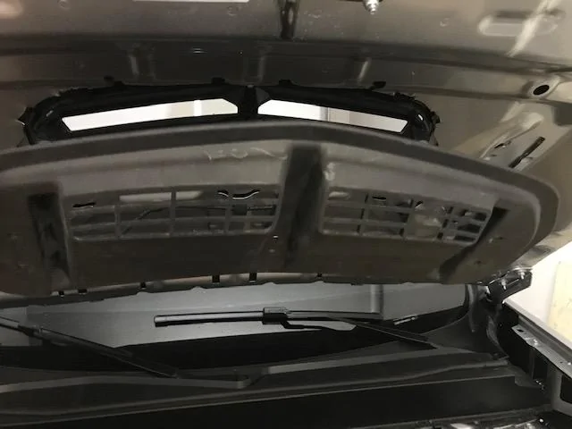

Need to do some trimming to this water tray to get it fully bolted on such that it seats against the hood properly. Per my placement of the vent, this should drop any water right in front of the engine but just behind the air inlet tubing that's behind the radiator. Likely a non-issue in my case though as this isn't a daily driver and is garaged. Just have to take a little more care when washing.
