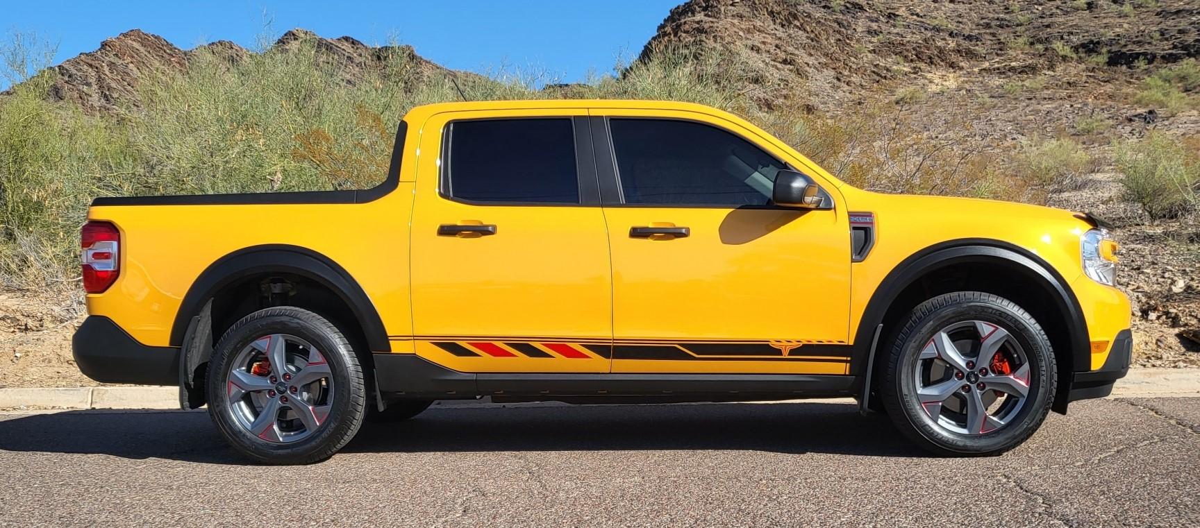

What post #20 said. I did that on the blue Maverick in my photo and it came out great. The yellow Maverick is having some paint and graphic work done. I will ceramic coat that when the paint is cured enough. Polishing is not necessary (if you are happy with the finish "as is").
MY Paint guy measured the thickness of the paint and said it is very thin, but common in today's vehicles. He has 50 years experience. This was his first cyber orange project and he is super impressed with the amount of different colors in the Cyber Orange.
Good luck and happy Coating/protecting your Maverick. 🤟

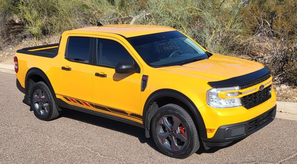

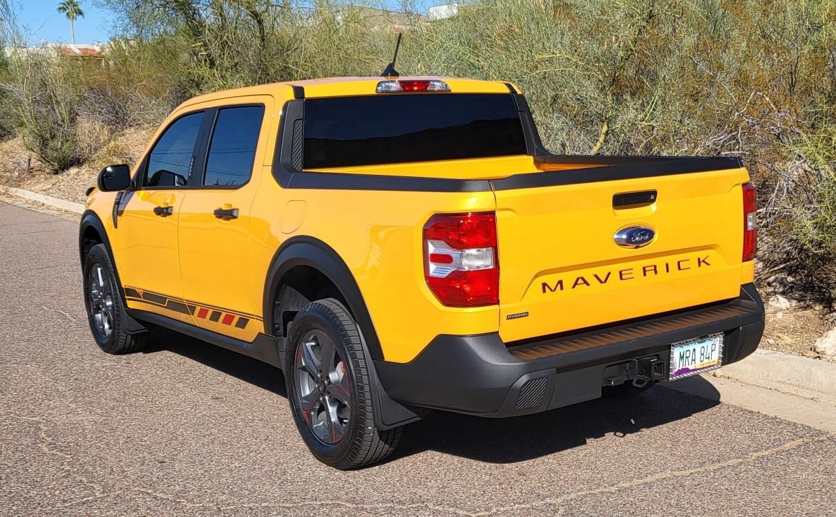

I used a Clay towel with soapy water on my truck last night. I could feel the slight drag on the paint the first 1 or 2 strokes, then it was super smooth after that. The night before I did an iron remover spray then rinsed with water. After the clay towel, I rinsed the truck off and used alcohol/water mix to get it super clean and grease free. I then put on 2 coats of FORTOO 10H ceramic/graphene (from Amazon) on the truck (3 hours apart for the coats). The coating went on the paint and the black trim and looks great. I also used Permashine on the tires.

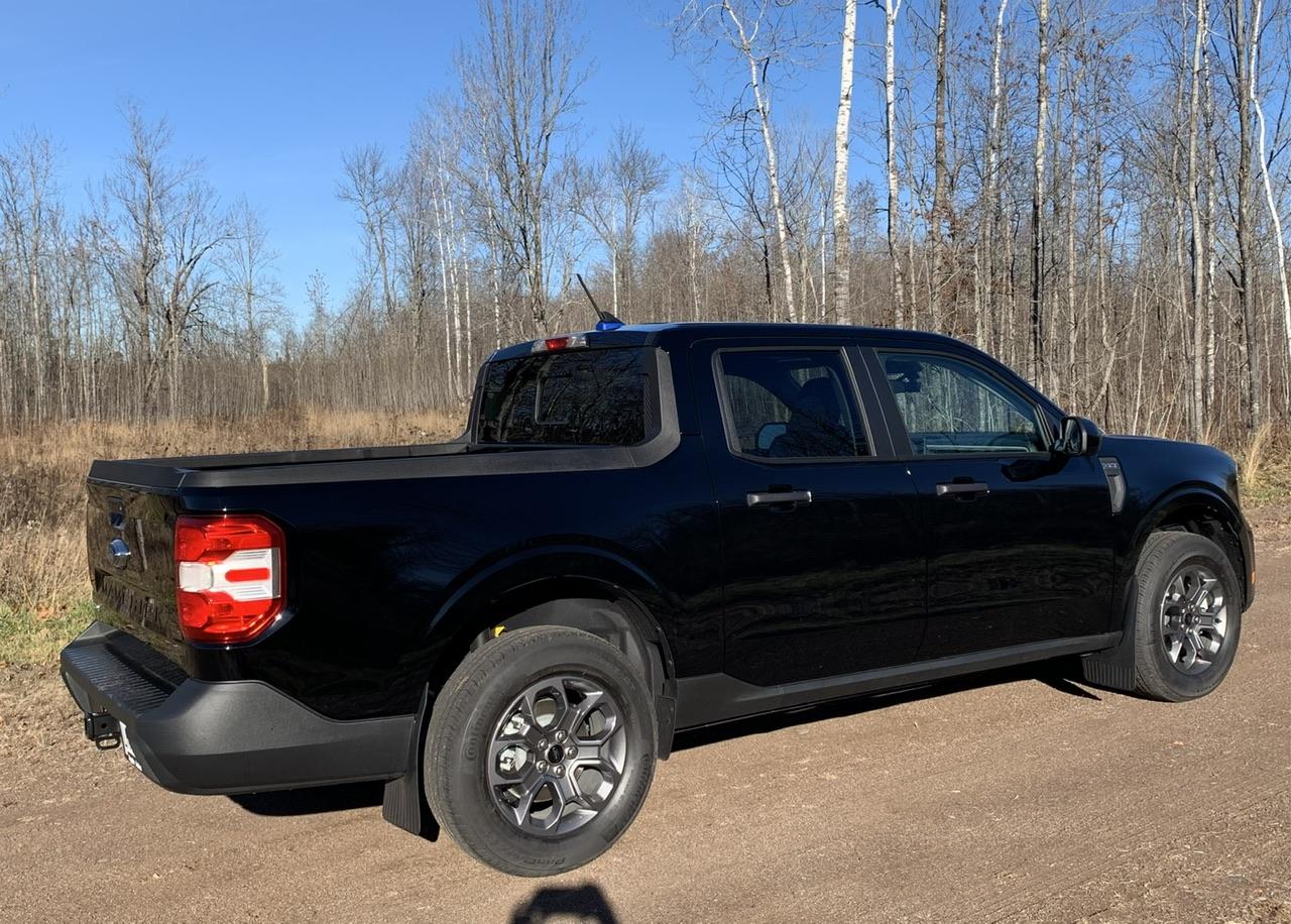

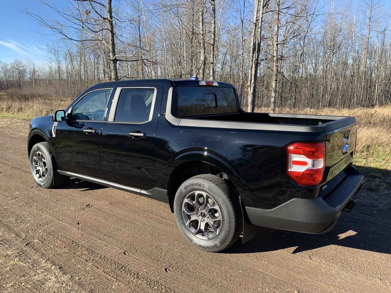

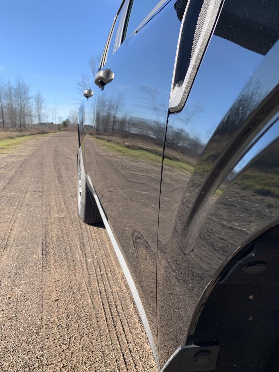

As an update to my progress, I have since completed all steps through ceramic coatings done. Photos attached. I’ll update more later, regarding the full experience as a first-timer for doing a DYI true ceramic. Note that I did NOT end up polishing. Not even a little bit. There was minimal scratching or swirl marks to begin with, and they are darn near impossible to see short of using a recommended hand or spot-light during the ceramic coating “leveling” process.
these photos include about 2 weeks of “garage dust” that has since collected on it too. I have not re-washed the truck again AFTER finishing the coatings 2 weeks ago.
