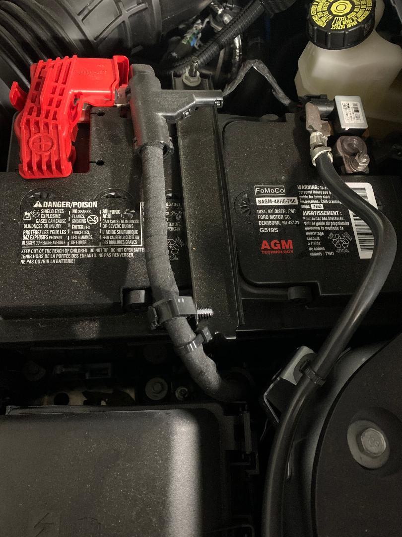

Btw this truck came with an AGM battery. see photo

Ya - I knew you got the AGM - try not to show it off too much, hybrid drivers are in this thread.
