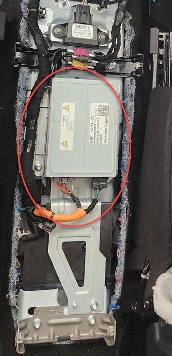

Inverter is under the floor console:
https://www.mavericktruckclub.com/forum/threads/how-to-prop-up-center-console.56957/post-963583

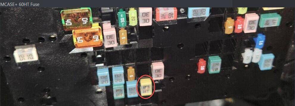

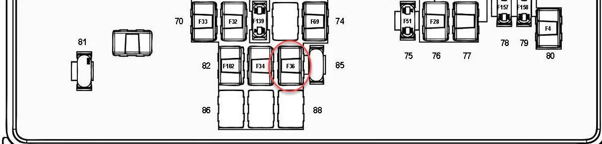

One fuse is under the hood a 60A, the other is 10A in the BCM, F6.
Under hood:
Ford Maverick Bed and Console plugs not working 1751210976571-x2
Ford Maverick Bed and Console plugs not working 1751211010369-5

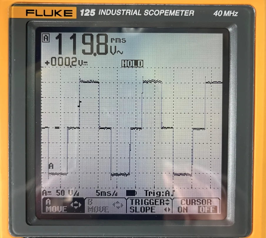

My Maverick's 400W Inverter modified sine wave:
Ford Maverick Bed and Console plugs not working 1756827079058-as
