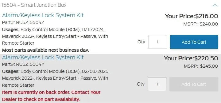

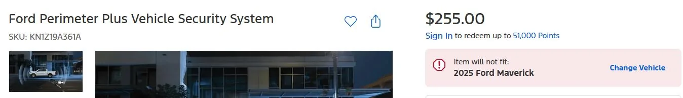

22-24 Ford Perimeter Plus VSS plugged into the rear of the Gateway Module/Data Link.
2025 Maverick labels one Module 15604 in bottom parts pict as Alarm/Keyless Lock System Kit
That doesn't quite sound like Perimeter Alarm, more like the BCM module.
Part#: RU5Z15604Z
Usages: Body Control Module (BCM), 11/11/2024, Maverick 2022-, Keyless Entry/Start - Passive, With Remote Starter
Description
• Body Control Module (BCM). Keyless Entry / Start Passive.
• With Remote Starter.
Part#: RU5Z15604Y
Usages: Body Control Module (BCM), 02/03/2025, Maverick 2022-, Keyless Entry/Start - Passive, With Remote Starter
Description

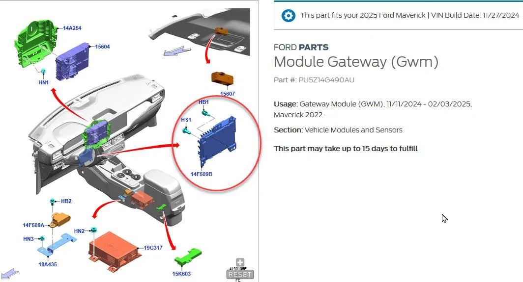

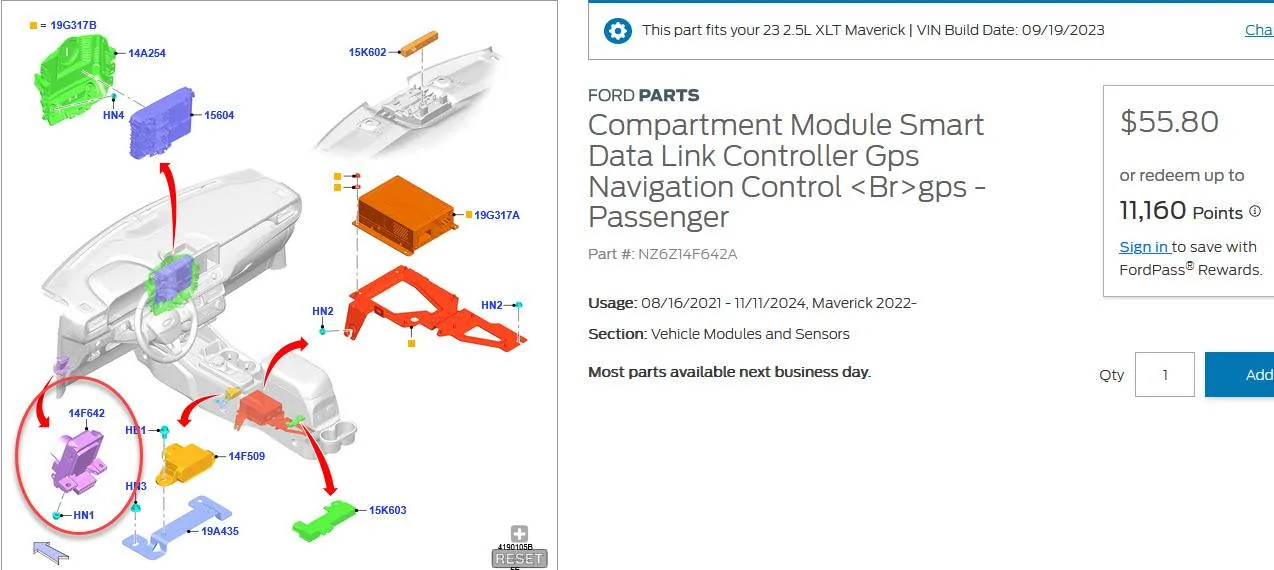

Seems to be quite a difference between Gateway Modules for 2022--2024 Maverick and 2025 Maverick.
Gateway Module - 2022 to 2024 Maverick
NOTE: The GWM communicates with the 5 Controller Area Networks (CANs).
The OBD DLC is fitted to the GWM and is the interface with the diagnostic scan tool.
The GWM is mounted under the driver side instrument panel.
The OBD connector is fitted to the GWM.
NZ6Z14F642A
Ford Maverick Perimeter Plus Alarm not working Gateway Module NZ6Z14F642A - 2022 to 2024 Maverick
Gateway Module - 2025 Maverick
NOTE: The GWM communicates with the 7 Controller Area Networks (CANs).
The OBD remote DLC is connected to the GWM and is the interface with the diagnostic scan tool.
For diagnostic scan tool access, a remote DLC is mounted under the driver side instrument panel with a harness connected to the GWM.
PU5Z14G490AU 11-11-2024 to 2-3-2025
PU5Z14G490AY 2-3-2025 to Present
Ford Maverick Perimeter Plus Alarm not working Gateway Module PU5Z14G490AU - 2025 Maverick
