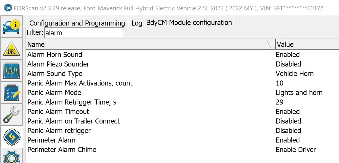

I looked into this last night and think that @Gullzway is right. I don't think it's installed by default.
To start:
  • I have a Lariat Lux.
  • It comes with remote start and the basic alarm.
  • I have a hybrid.
  • I have push button start.
According to Forscan, my perimeter alarm is already enabled.
Ford Maverick Perimeter plus install 1669693087303
My window sticker lists 'Perimeter Alarm', so this checks out. I think this is the basic alarm.
