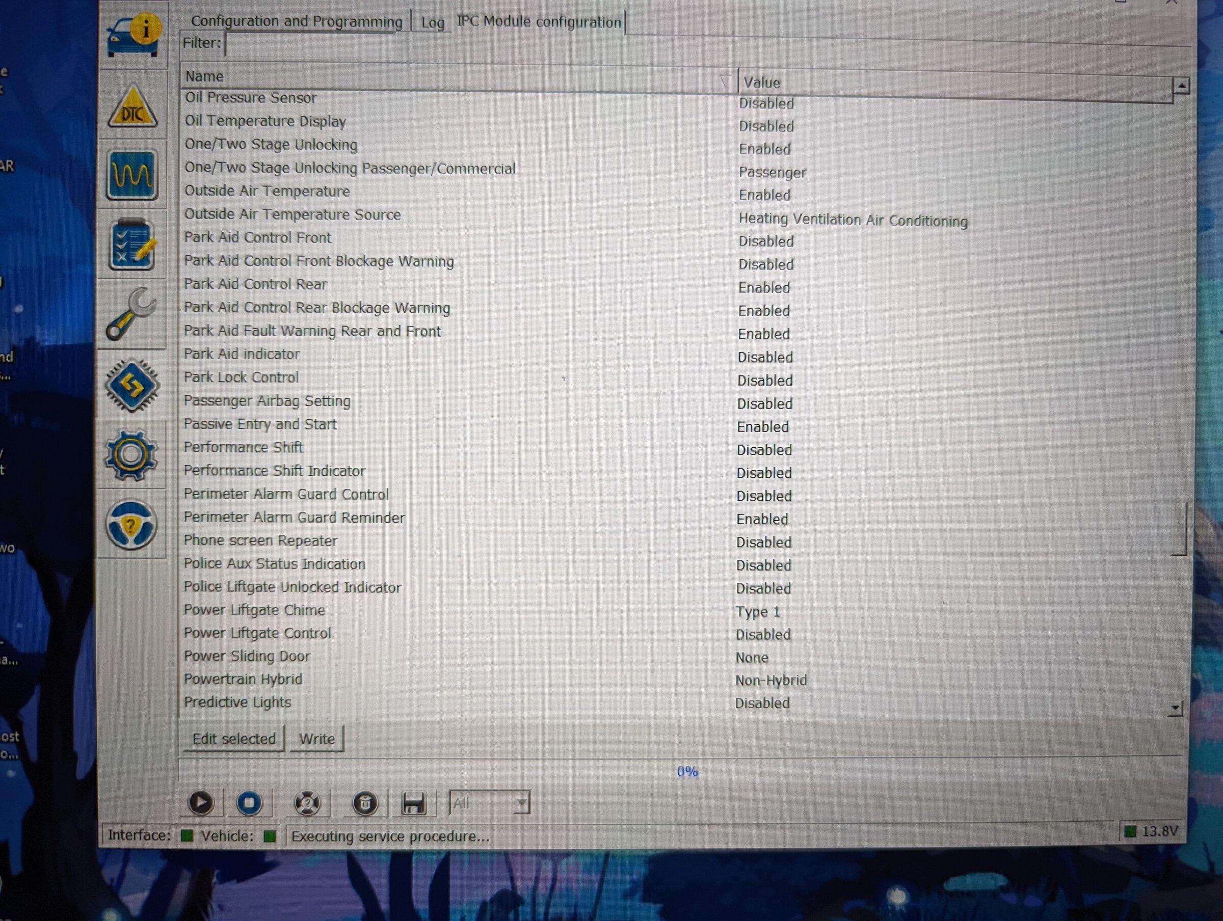

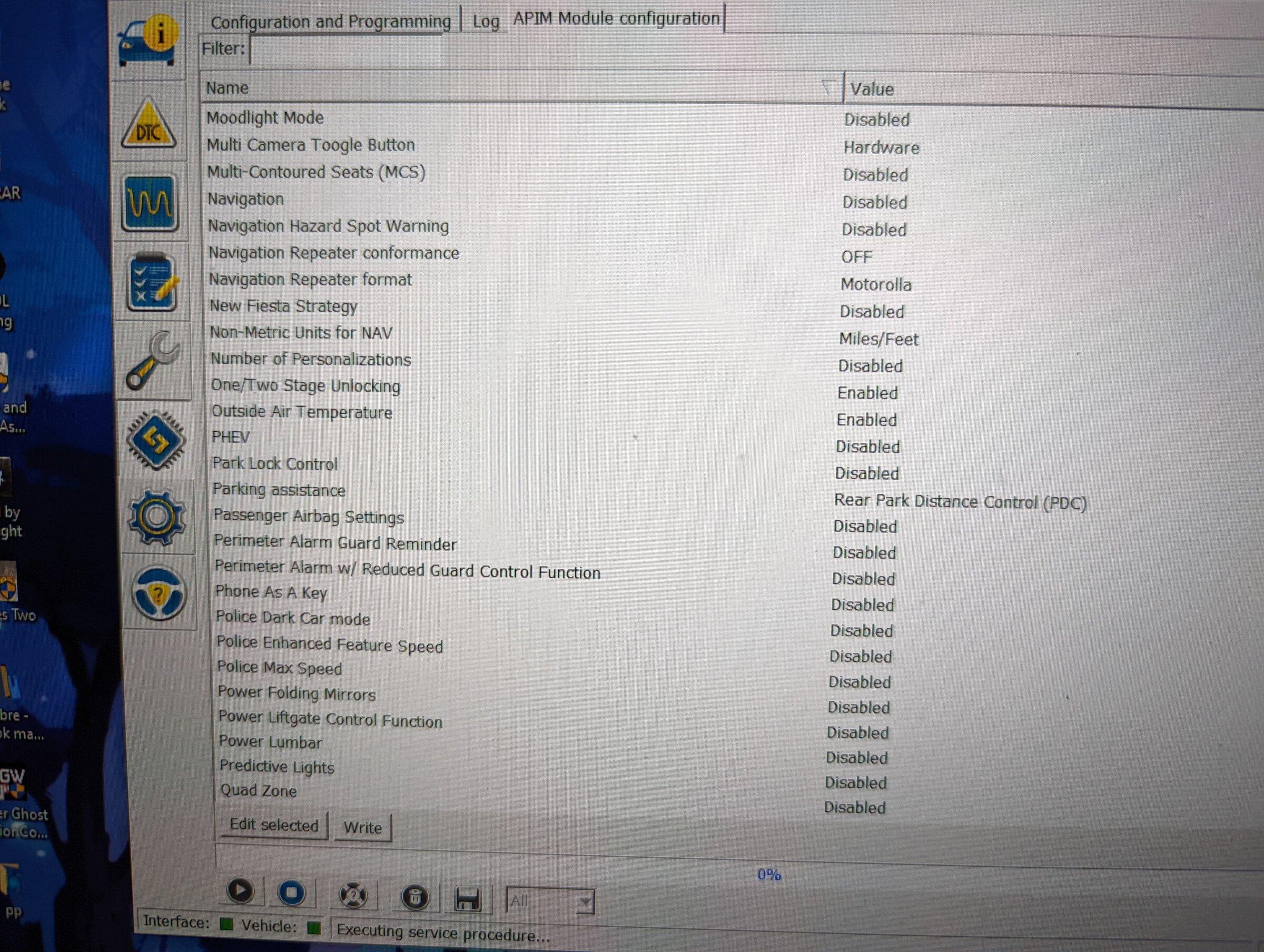

Did Ford pull one over on us and not include/enable this? I have seen little to no discussion about this Interior Motion Alarm. I will look around tomorrow in Forscan to see if this is an option that can be enabled. Guessing that may be what this sensor in the overhead console is?
https://photos.app.goo.gl/Lb6qtTPvR5vvLxZB6
Any input on this?
Are you, or anyone else, seeing the following setting on your Maverick? I have Lariat with every option -FX4 and this is not a menu item that I see. The following is from the "If Equipped" Anti-Theft Alarm on page 85 of the manual.
I have a fully loaded Lariat, Luxury Package, with the add on Perimeter Plus Package and I still do not have this selection on my menu. Smh Spoke to dealer, said they can’t enable it. Called Ford last week and was told a technician would be calling me. To date, no one has called me back from Ford. Perhaps it is one of the features Ford dropped due to chip shortages. Smh

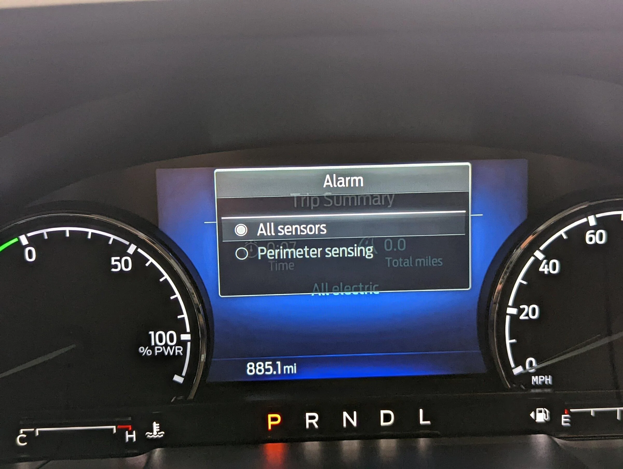

@Louie1
Honestly, I'm not sure if that menu even does anything on the Maverick. I don't use it. You can set all sensors or perimeter enabled, on the Maverick there aren't any other sensors.
I think it may be for vehicles equipped with the interior sensors, which is why I originally started this thread and the Maverick does not have, so that you can turn those off if you leave the car parked with maybe a pet or kids inside, running of course.
Thanks @Gullzway , I enabled the menu option. As you mentioned, not sure what it does, but it's there.
